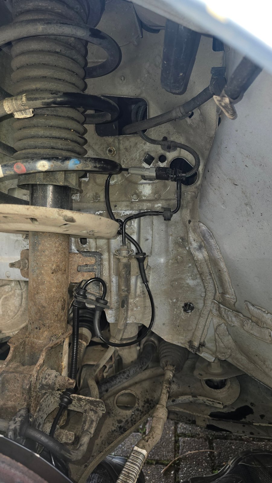

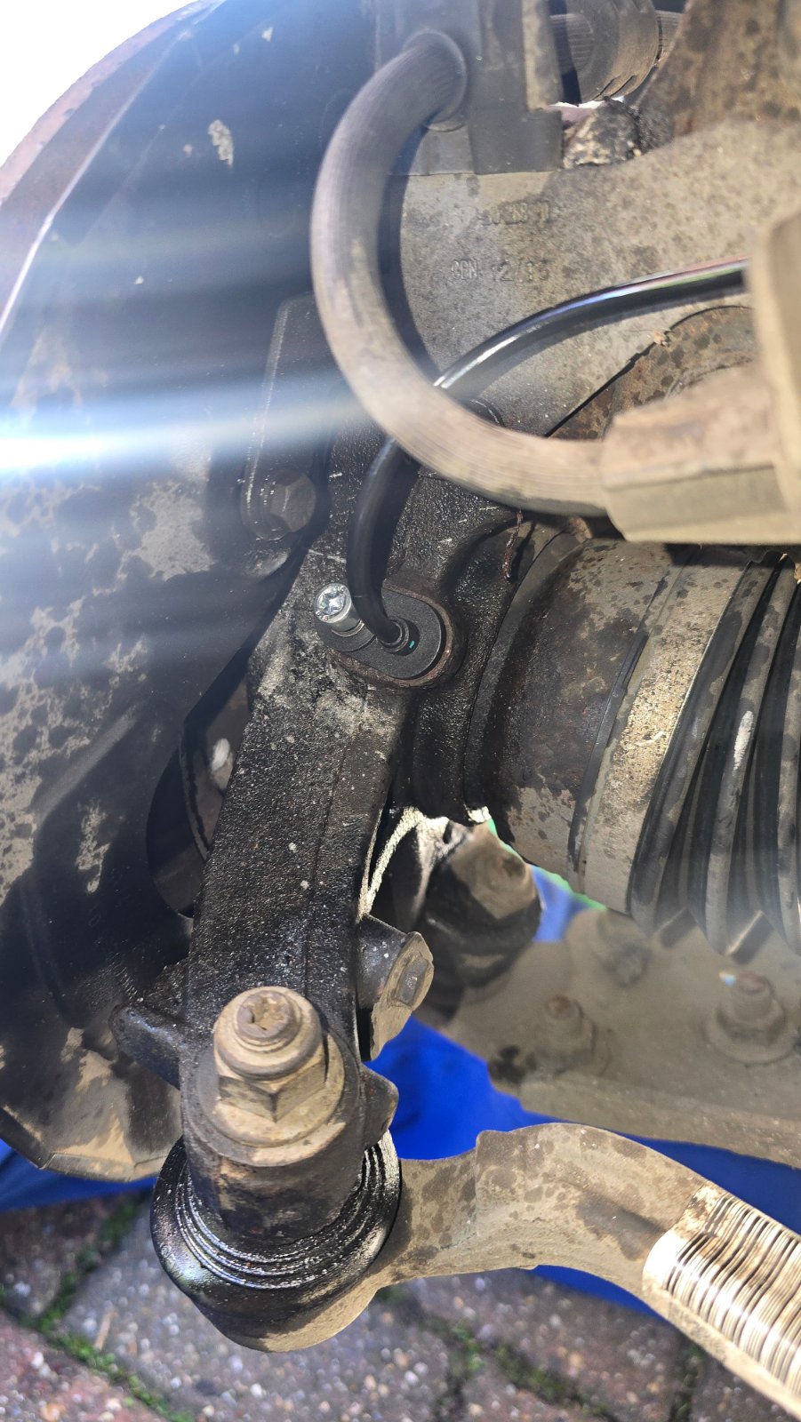

Yes, there was (a connector under the wheelarch). I would like to add a couple of photos for anyone who ever has a FRONT ABS sensor failure in a Picasso II, but I haven't figured out how to upload them (advice / assistance gratefully accepted).
Removal of the Wheel arch protector, showed everything. Once that came out, the job was easy, but I admit to jitters in case I had to follow more wire problems in the loom. Replacement of the sensor - after cleaning of the area - was easy, and luckily there were no other wires to chase. Cost at a PSA garage £123 +VAT just for the sensor - at Eurocarparts £75, EBAY £12 to £50 (sincere apologies if this is classified as advertising).
Firing the engine up with the new sensor fitted was like heaven. No bells and whistles, and driving around with no flickering dash lights here and there, was bliss after clearing all the induced faults.
A word of warning to anyone with an AUTOMATIC (EAT6 or EAT8) transmission and a failed ABS sensor..... The gearbox will not lock-up in gear and any driving over 20mph is exclusively on torque converter. I don't think there are any PICASSO IIs with an EGS gearbox so it would be interesting to see what would happen to one in the case of ABS sensor failure
An easy job, for a change. Thanks for your help Richard R

And I found out how to upload photos - not bad for an old fella.
The photos aren't the very best but they show the location under the (LEFT HAND) wheelarch
Cheers
WillyR
