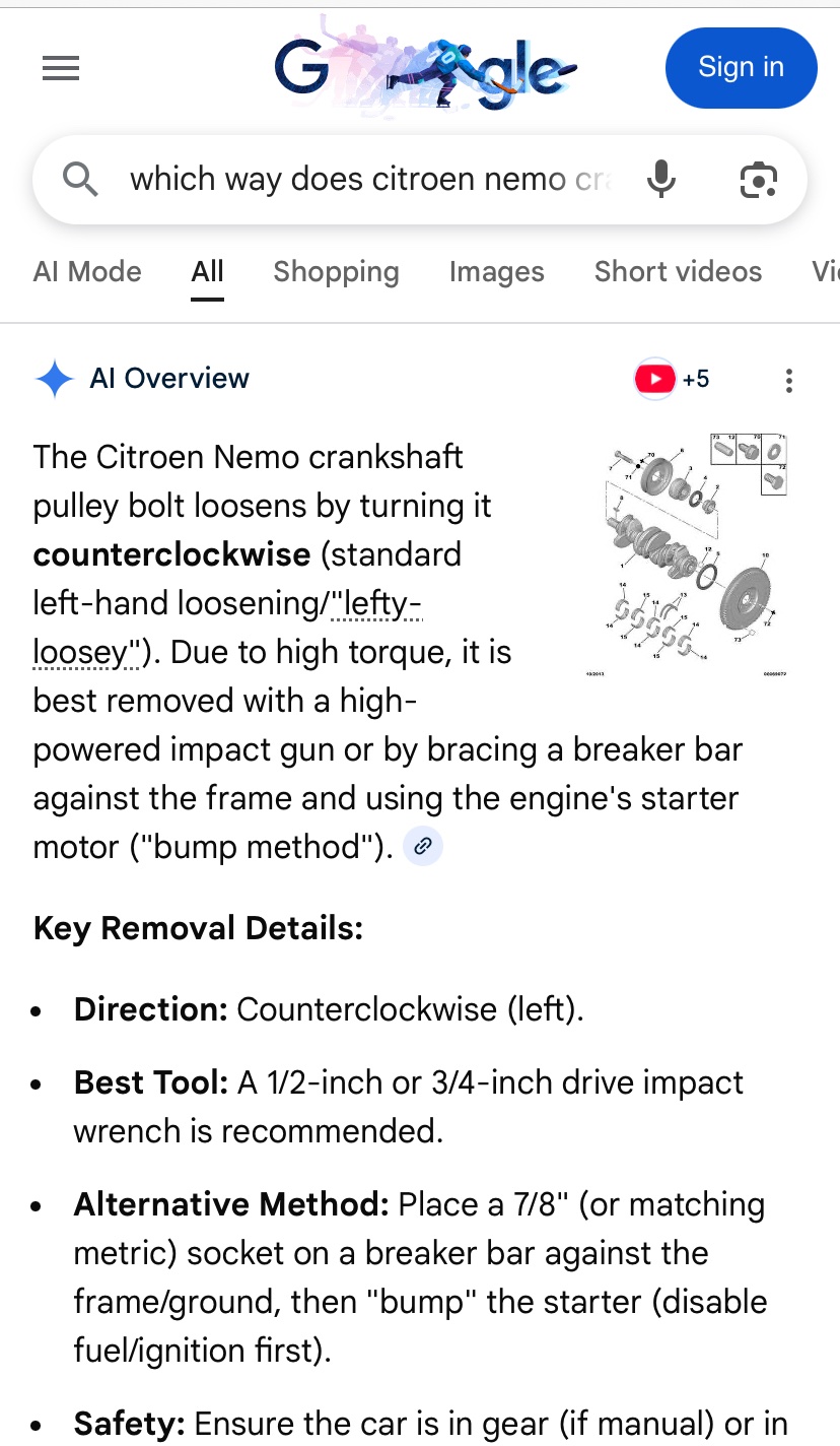

I asked simple question, which way does citroen nemo
crankshaft bolt unscrew, reply, lefty loosey
WRONG it comes off clockwise
Dont trust AI for advice

Is that true? Interesting: it's the first reverse-thread crankshaft pulley bolt I've come across

P.s. wholeheartedly agree with advice to give AI answers VERY close scrutiny before following!

Like Matt I have never come across a clockwise to release crankshaft bolt which would prevent the engine bump method from working, which it has whenever I've come across it. However I go further than Matt on the AI advice. Don't ask it at all!!

I have twice just leaving note so any nemo drivers need know
Ps: this is the chain belt version not cambelt

How do you know which end of the engine your "adviser in the cloud" is standing at?
Also, seems odd that for a Citroen it suggests imperial spanner sizes. Half inch drive, fair enough, 7/8 inch or metric equivalent socket, shouldn't it start with metric in the first place? That will be 22.225 ..... time to look for one in my toolbox. Also as well - starter bump method - ensure car is in gear. I know eveyone thinks AI will control the world soon enough, but is it trying to kill us off to speed things up?

I think on our 2.2 hdi C5 the crank pulley bolt has to be undone gradually due to loctite or something or there is a risk it could break.

Yep, I remember that on my 2.2 - the loctite can bunch up on the threads supposedly.PaulC5 wrote: 11 Feb 2026, 21:36 I think on our 2.2 hdi C5 the crank pulley bolt has to be undone gradually due to loctite or something or there is a risk it could break.
Loosened mine with breaker bar (about half a turn) then switched to torque wrench set to something like 150 Nm. Backed off rest of the way like that (on the basis that if the wrench clicked, I'd stop go back in a bit then try again)
Wrench did not click but it was stiff ALL the way out! Pretty much final turn of the threads before it was down to finger tight. Not come across something undoing like that before, or since!
