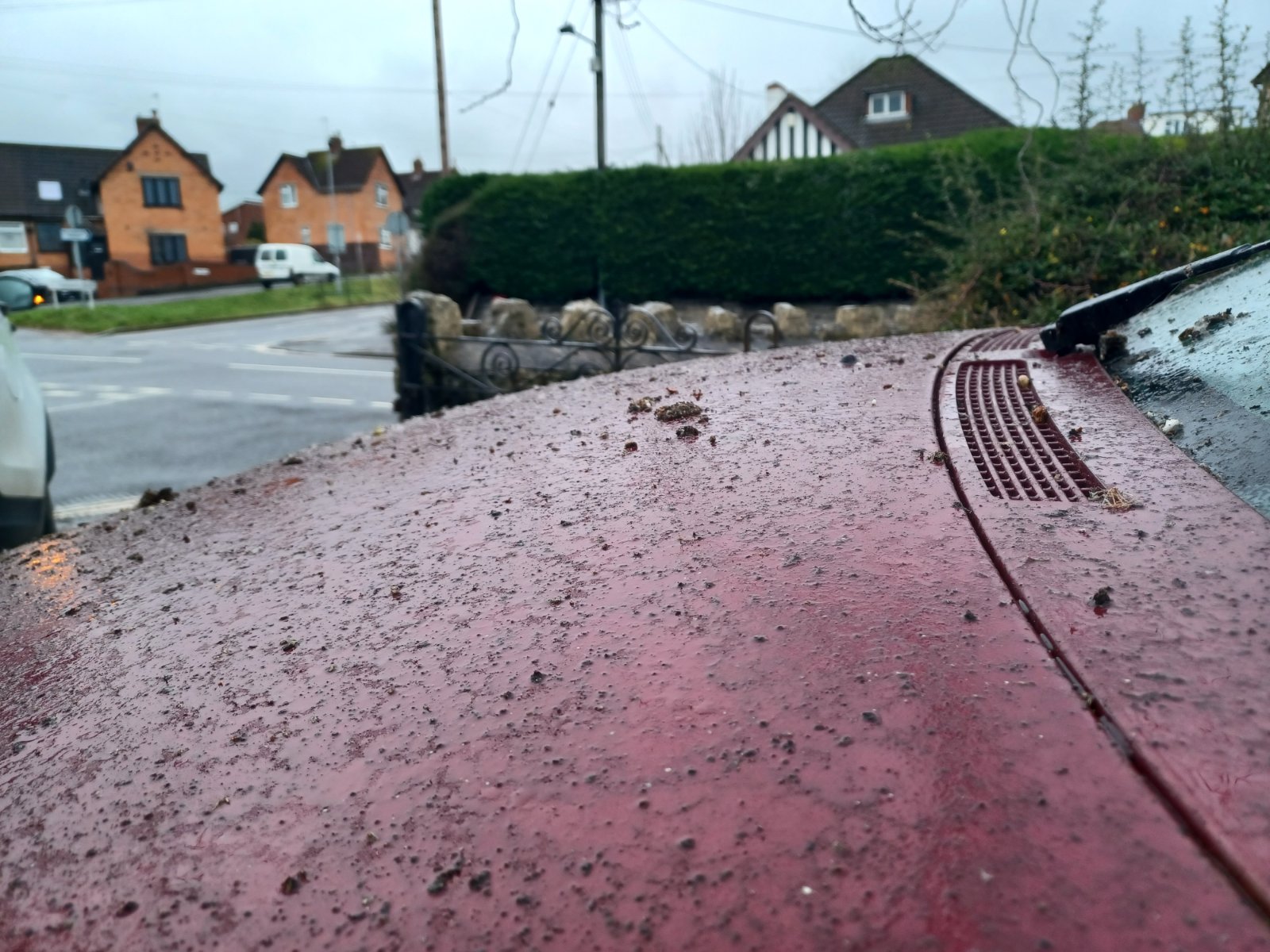

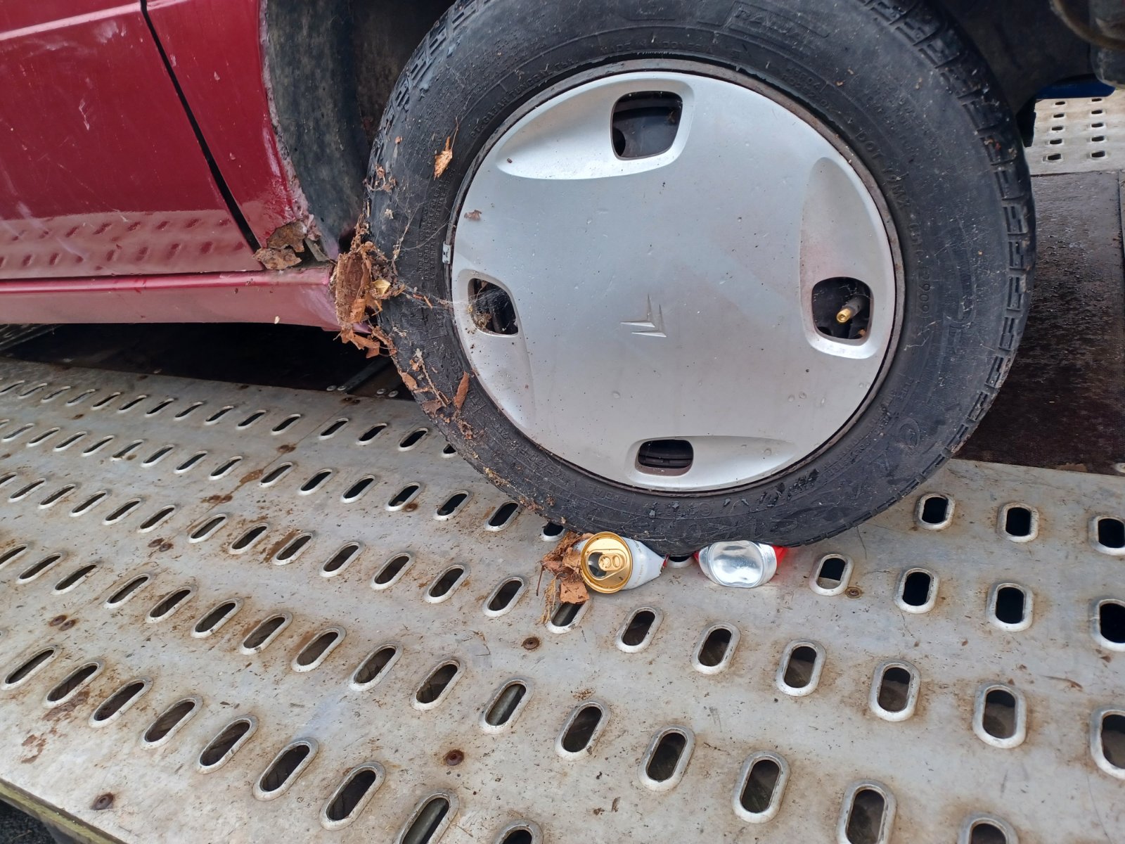

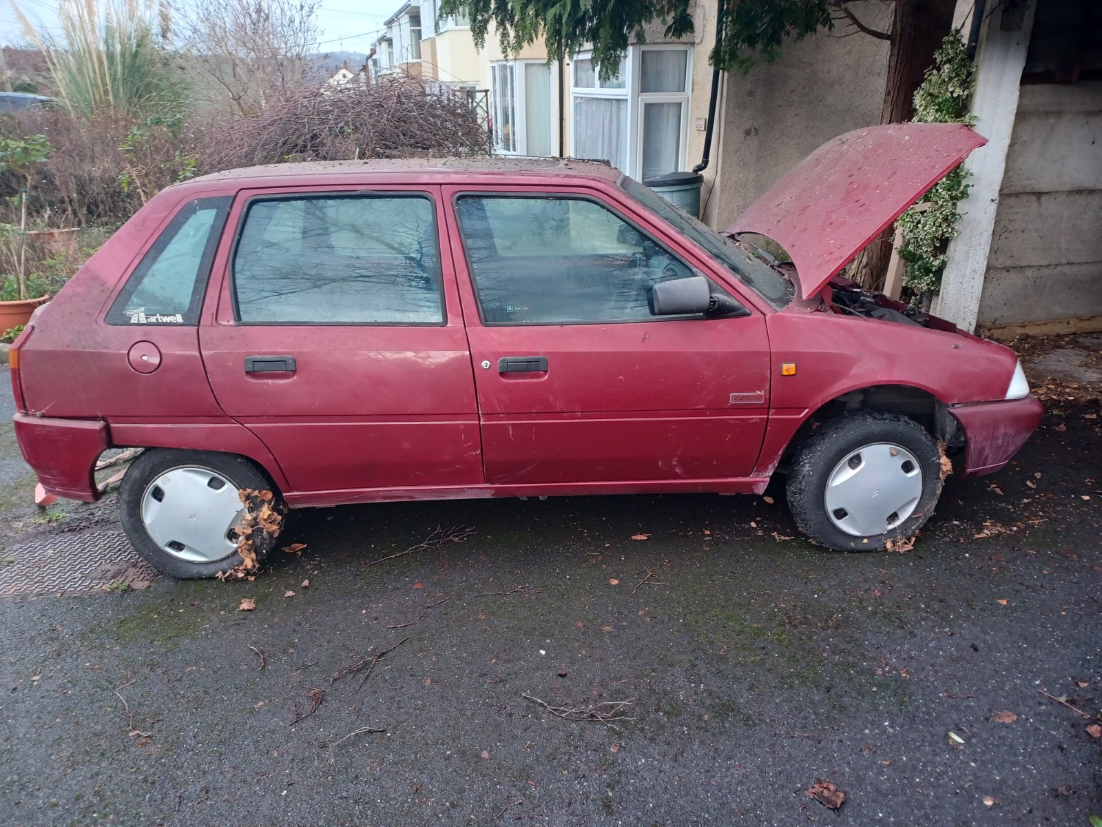

My name is Betsy and I am a dirty girl..........I have been locked in a sparrow infested drafty garage for 6+ years until liberated the other day....
I can slide on Old Speckled Hen cans :)
(What happens when a total pratt forgets to bring my keys and the steering lock is on !!!)
and yes, my lower front wings are a bit frilly....clean out the leaves and muck folks !

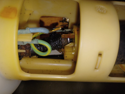

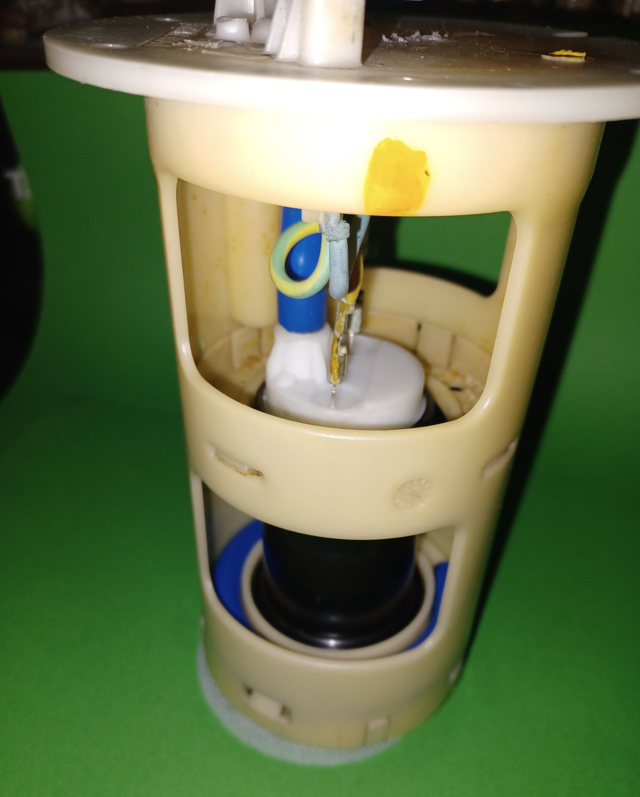

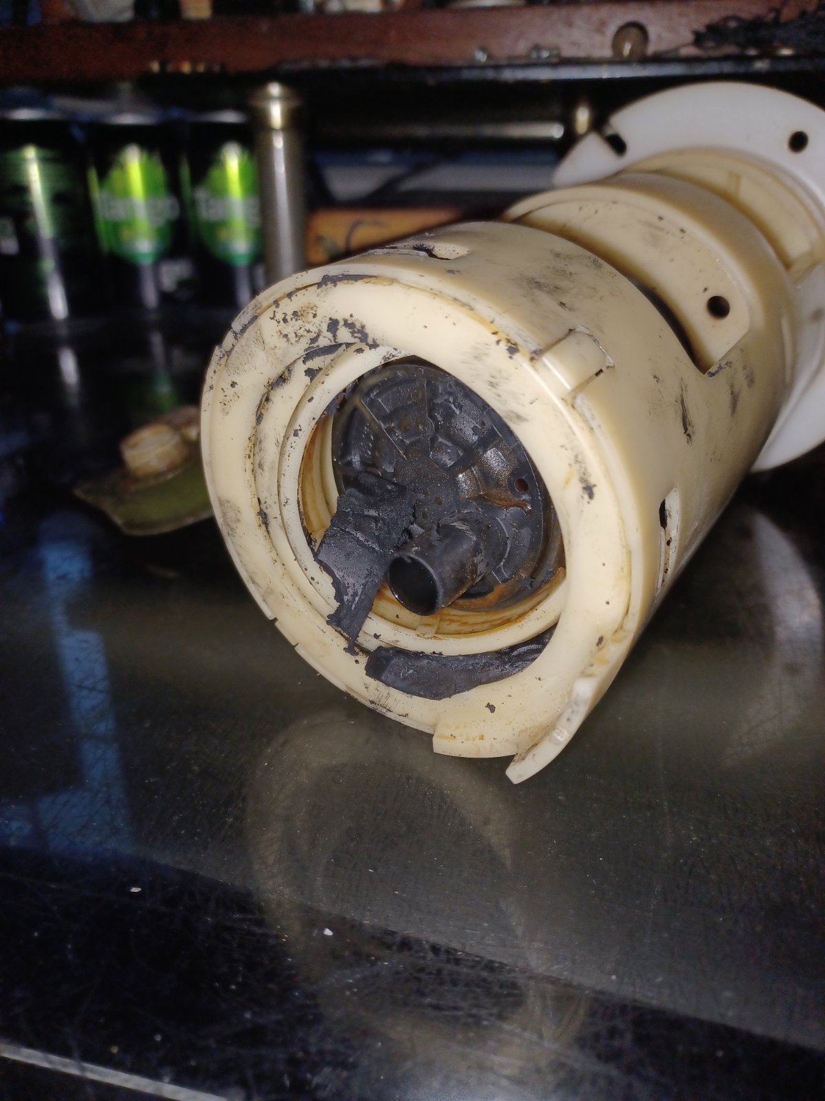

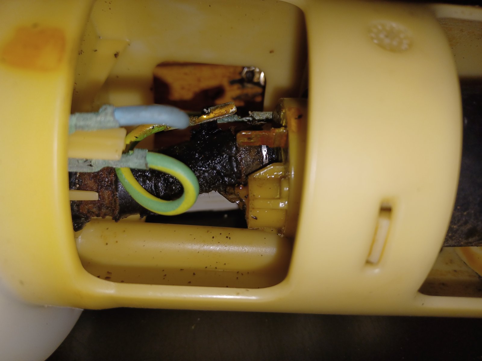

I think I have found the reason there is no fuel getting to Betsy's throttle body/injector....
E10 Rubber rot and rust .....in tank pump is more rotten than Starmer's judgement calls
Posts: 54936
x 8287
Re: Hello.....my name is Betsy
It's great you've rescued Betsie Alasdair :D Under there you may well find a lovely little diamond :cool:
My long-range diagnosis of a failed fuel pump was pretty much spot-on then ;)
That's certainly suffered badly and if all down to E10 petrol, somewhat worrying. I'd be tempted to check your other AX and the Saxo you are involved with as they use a similar pump.

A grim looking result of using E10 petrol indeed! Further evidence confirming why I run both my old cars exclusively on Shell Vpower E5 !! :)

Stickyfinger wrote: 05 Feb 2026, 19:42 I think I have found the reason there is no fuel getting to Betsy's throttle body/injector....
I think the ethanol thing is more of an issue on cars that sit more than a year, rust-wise at least (probably still makes rubber turn to concrete no matter how fresh).

ekjdm14 wrote: 06 Feb 2026, 17:24 I think the ethanol thing is more of an issue on cars that sit more than a year, rust-wise at least (probably still makes rubber turn to concrete no matter how fresh).
That's why I'm keen to see a similar pump that's in regular use. Daffodil's may give us an answer to this Alasdair ;)

Fuel pump rebuilt........

Will she won't she ???

That sounds sweet Alasdair, well done, now the next question is: Does she drive? :-D
