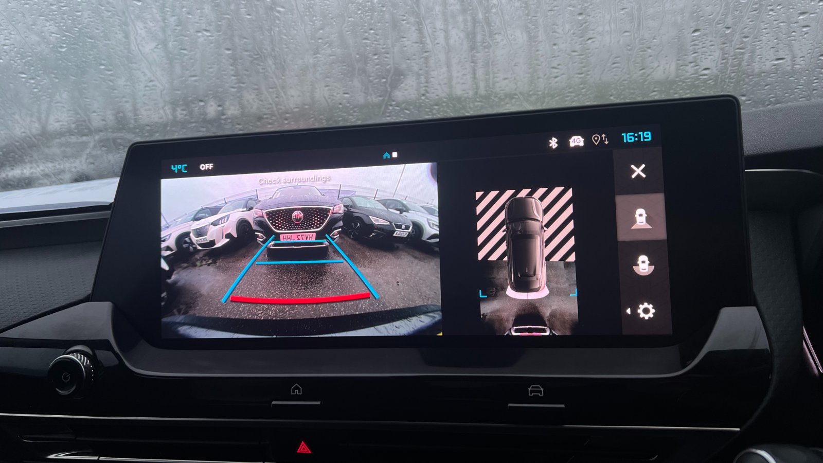

I put down a deposit on the car on Saturday and asked the dealership to fix an issue with the 360° camera.
I picked up my C5 X yesterday after giving them two days to resolve it. I already thought the way the 360° camera behaved was unusual, and unfortunately, it was exactly the same when I collected the car.
The dealership said the issue had been fixed, so I’m wondering.... is this actually normal? I still took the car, assuming this might just be how it’s designed to work, especially since I have a 3-month warranty and I need the car asap.
A colleague at work mentioned that some cars’ 360° cameras do behave like this… but I’m not convinced. Is that true?

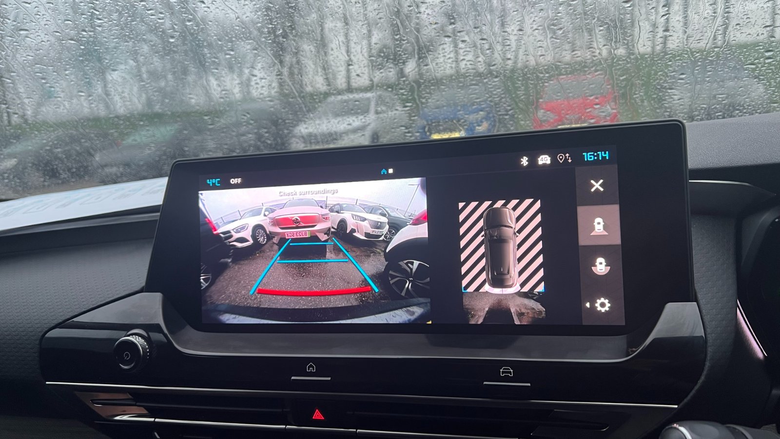

As I reverse, the 360° view seems to gradually unlock from the bottom of the image to the top, rather than showing a full 360° view straight away (see image).
I’ve done a lot of research but haven’t found a clear answer. I really need to know whether this is how the system is supposed to function or if something is wrong. I had assumed the camera would provide a constant, full 360° view, and I’d much prefer that if possible.

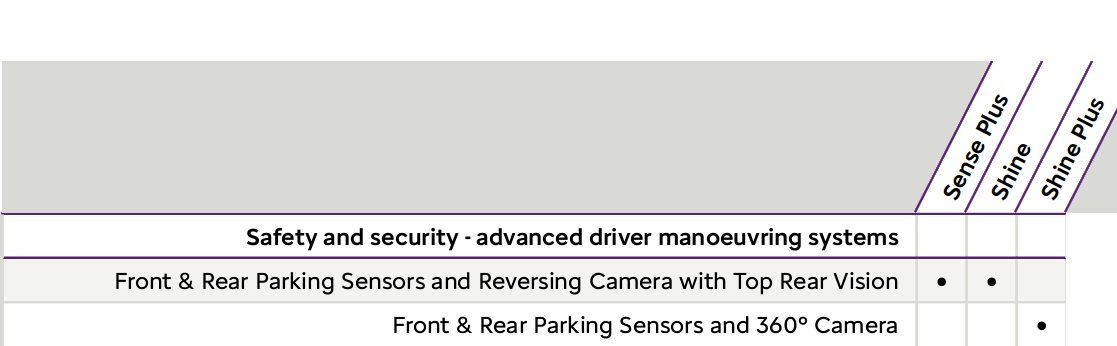

First question, Sense Plus, Shine or Shine+? Yes and No.
Modern 'Cheaper' 360o camera systems, build up the top down picture as you drive.

I have the c5 X Shine Puretech so i guess this explains it.... Thanks a lot. Could you send the link to where you got that screenshot from?

My C4, which I think has the same generation camera and screen, works exactly as yours does. (I don't have the front camera which was a fcatory order extra). I think yours is working as designed.
Calling it a 360 camera is a bit of a misnomer really. It's a single wide angle lens camera at the back, in my case the middle of the 'lip' in the tailgate, plus some clever computing. When you select reverse it can only see whats behind you, but it remembers the scene and as you move back it builds a picture as if you had a drone hovering above. It captures a much wider view than you get on screen but somehow undistorts the whole thing to show you meaningful information. When you get to the back of the parking space it has got enough data to show you "as if it were" a top down picture. I don't know how long it rememembers it for, but certainly long enough so that if you pull forward to adjust your position in the space it still shows the picture.
On your screen on the right there is a second box down. That gives you a true 180 view, not much use for accurate manouvers but brilliant if you are backing out of a blind space or a blind driveway - you can 'see' (albeit distorted) any passing traffic or pedestrians.
