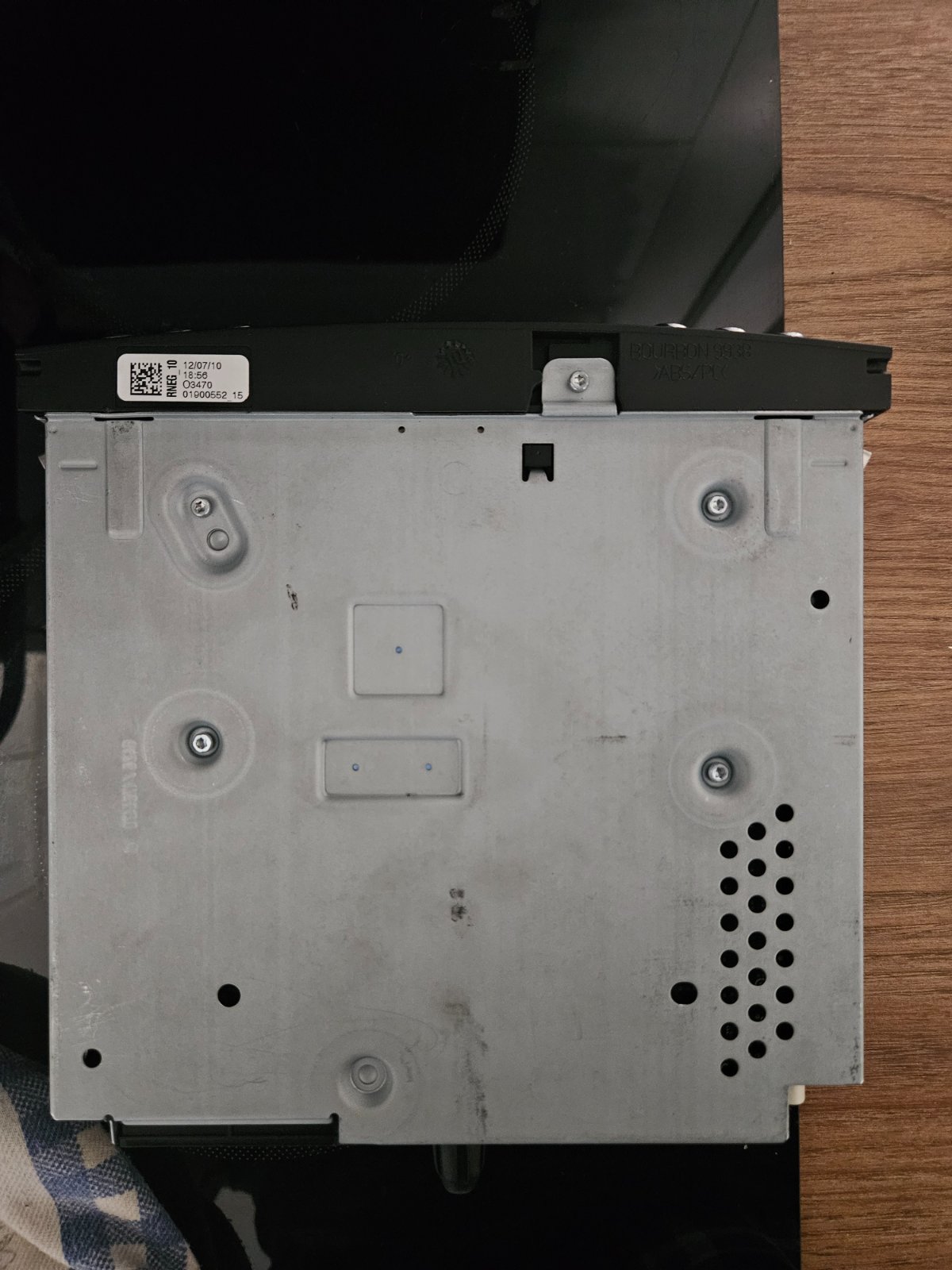

I have Peugeot 807 (2010) RT6 radio, have common issue with showing Peugeot logo and restarting all the time again and again.
I opened my RT6 unit, but on location right next to the cooler I couldn't find internal Micro SD card, simply it doesn't exists.
Is it possible that some units have only frontal Micro SD slot? Is it possible to do firmware update with that slot?
Or if you have any other suggestion for me what to do, I would be very thankful!

The front slot type radios are a different type (MyWay/WipNav/RNEG) from a different manufacturer (Harman Becker). They use different firmware.
Can you take a photograph?

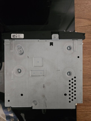

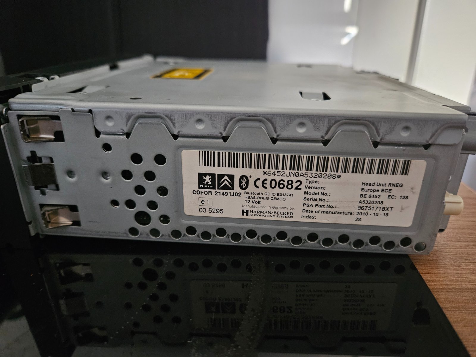

Re: How to Replace the Internal MicroSD Card - RT6
There it is.
Harman Becker it seems to be.

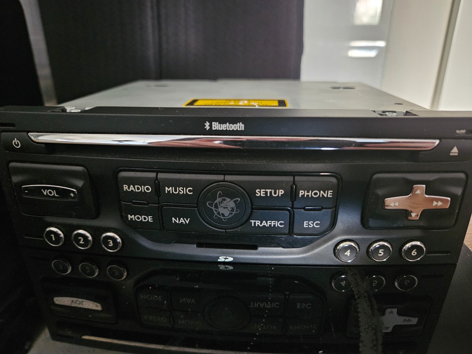

Yes it is. Is there an SD card in the front slot? I can't see from the photograph.
You need to look in this section of the forum viewforum.php?f=49
There is SD slot. At the photo there is no physical SD card, but I have it, on it it's GPS maps from 2010.
I will check that section of forum. Thanks.

EDIT: Just seen your photo.
That is an SD slot not a micro-SD slot. Look inside!
- Posts: 9364
- x 1938
No need to look inside. That is not an RT6, it's a MyWay/WipNav/RNEG head unit.
