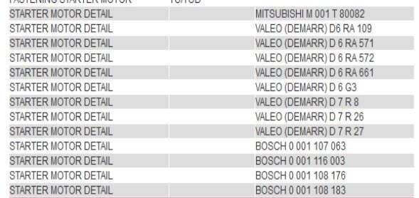

These are the Clutch and Starter files from your VIS but there could be a number of starter motor options as in the list below. You need to pick one and I may be able to find more about it. :)
Berlingo clutch.pdf
Copied from Servicebox backup
(207.82 KiB) Downloaded 63 times
Example of starter motor file:
Berlingo starter.pdf
(144.93 KiB) Downloaded 63 times
Copied from Servicebox backup - possinle starter motors
