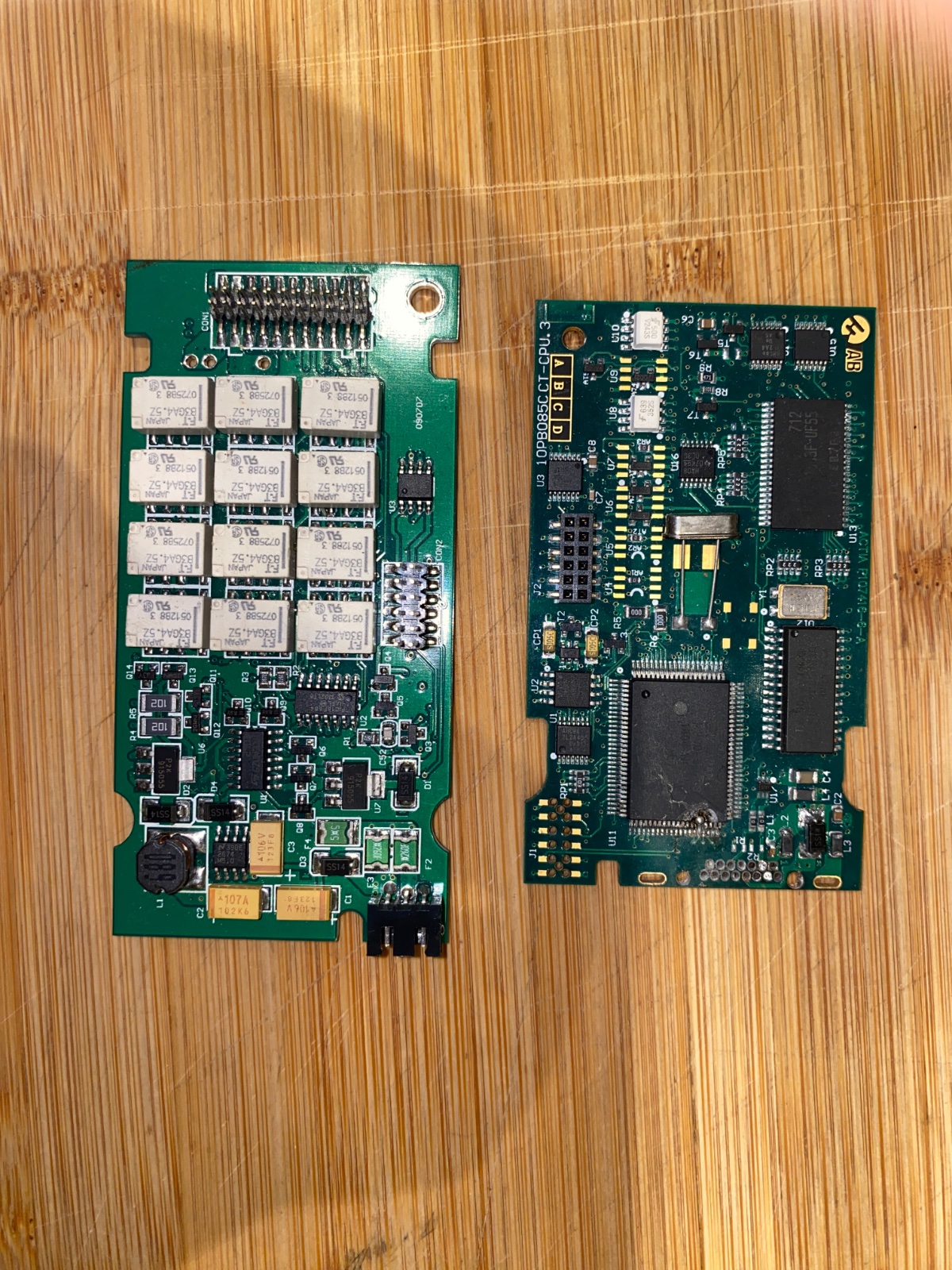

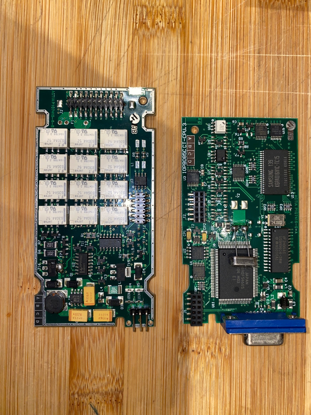

Some time ago I was given this.
Cannot recall if he said it was not working.
He said it was a genuine Lexia. Obviously one of the very early originals by the looks of it.
Plus a photo of my knackered clone for reference.

Re: Neighbour gave me this Lexia
Which is which?
- Posts: 9313
- x 1938
I would guess the one missing the serial port socket and a hole burned out of the chip nearby is the knackered one! I'm no expert on the innards of these but both seem to have fewer optoconnectors than is required for full compatibility with 'difficult' cars.
This is not an original, because you missed the optocouplers!!
Im pretty sure this serial port being blue is a telltale sign its a fake im afraid.
- Posts: 14306
- x 3306
That is not a serial port (as they only have 9 pins), it is a VGA port (which has 15 pins), although not used for a VGA output.
The one with the silver edge I believed was genuine but having delved a bit more into it, it is unlikely because the genuine Actia did not have blue coloured serial connectors. They were black apparently.
I think it would come alive again if I could source a replacement connector. I could desolder from the other complete one but why have two knackered Lexias?Paul-R wrote: 23 Jan 2026, 10:56 I would guess the one missing the serial port socket and a hole burned out of the chip nearby is the knackered one! I'm no expert on the innards of these but both seem to have fewer optoconnectors than is required for full compatibility with 'difficult' cars.
This is true. The originals were black I have since learned.wheeler wrote: 23 Jan 2026, 21:28 Im pretty sure this serial port being blue is a telltale sign its a fake im afraid.
I refer to them as serial but it is a DB15 high density connector.

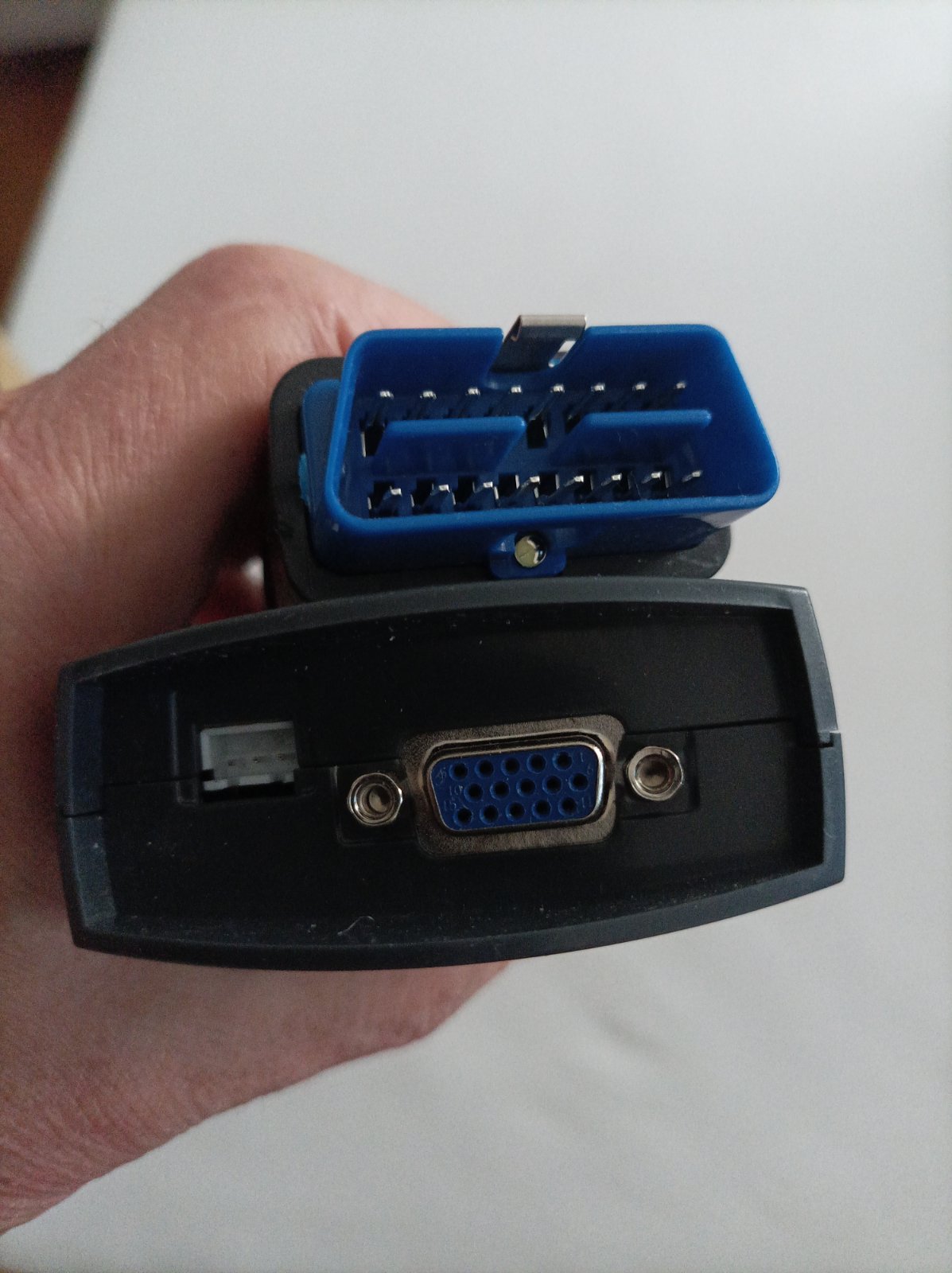

It is a Lexia device (some say a cable). And it has a DB15 high density connector that is used to connect to a computer. The connection is serial and goes to the USB port. The connector is the same as the VGA Port for the Monitor, but it has nothing to do with the VGA Monitor.
This is a non-original cable. It's a clone from Aliexpress. It may be outdated due to an inferior version. This cable will accurately diagnose cars up to 2013 – it works great in older cars. It won't connect to half the ECUs in newer models.
