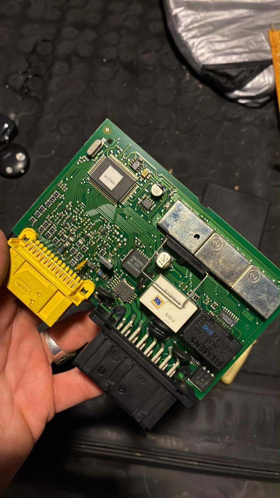

Hello! I have an Issue with interior fan and central locking from flip key. When I lock the car with the key it is working, but with the remote control NO. The issue with the fan is that when I press the brake the speed of the fan go up. I checked the minus point near right rear light. When I switch of the brake switch, the issue is gone. I know that is the comfort Modul. Can you help me where to search the problem.

Sounding like its likely a CPH issue then, If you get a second hand unit you would need to copy or swap the EEPROM over from your original.
Note that the CPH has nothing to do with the interior fan though so would need looking at separately.
