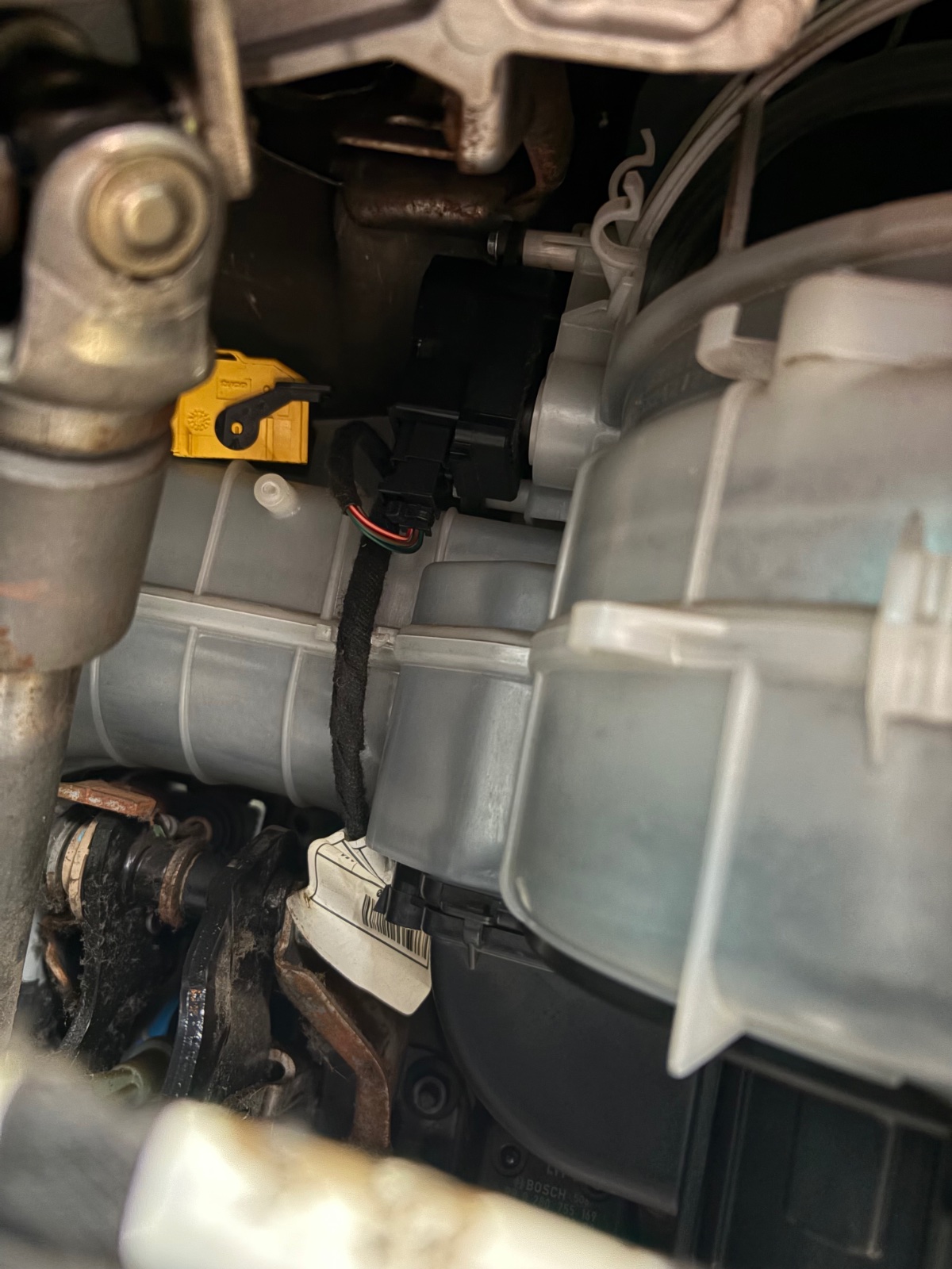

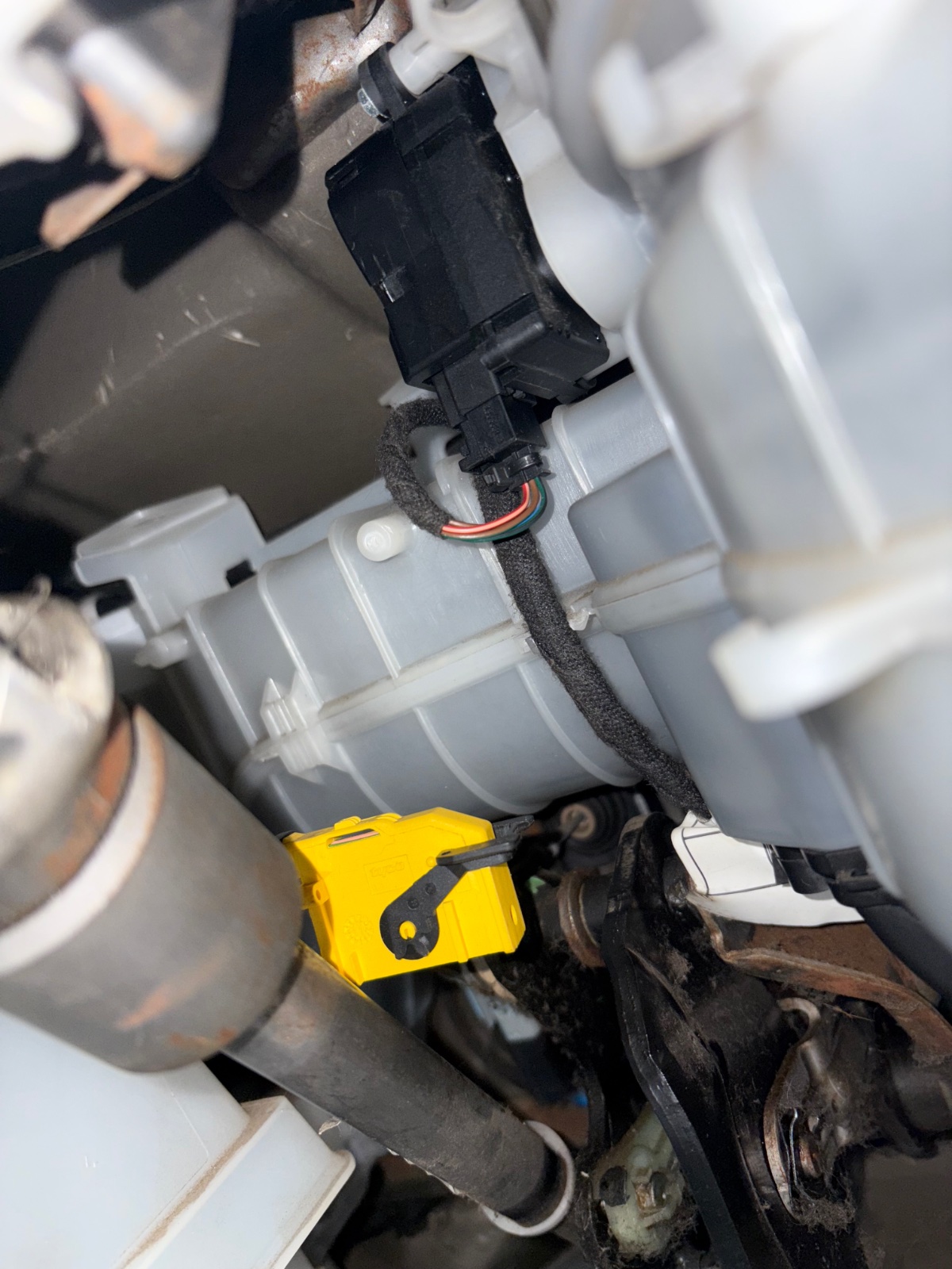

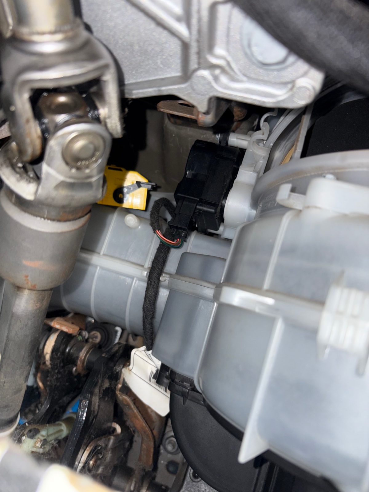

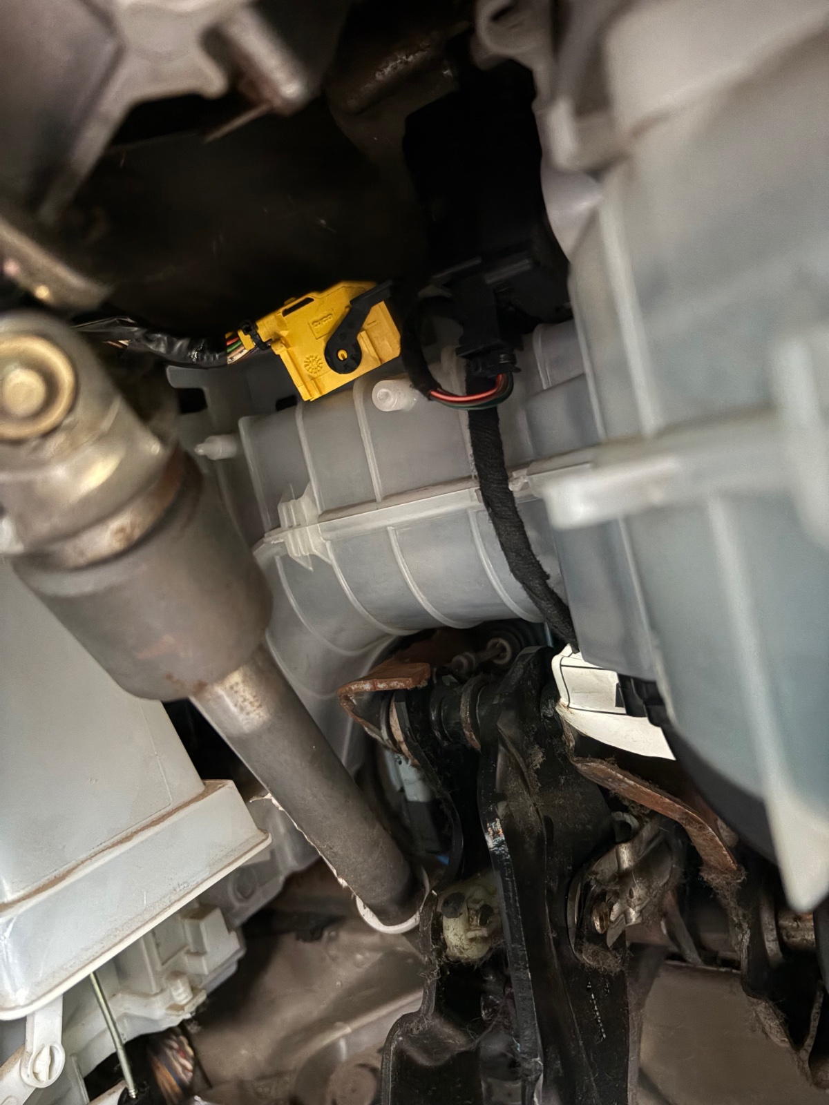

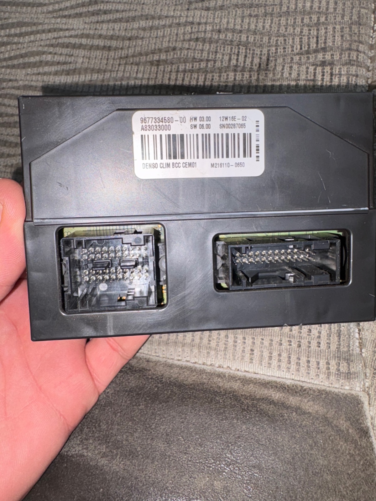

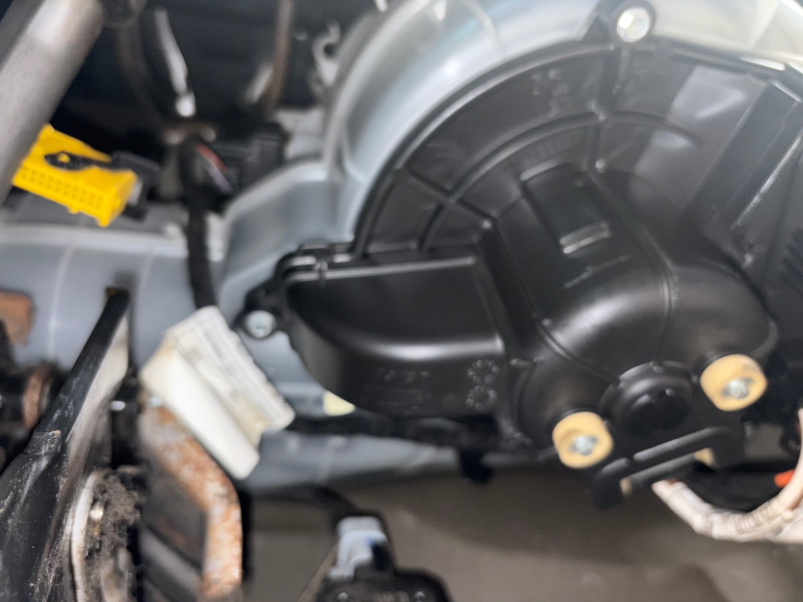

I’ve attached photos that show what I have.
One of the photos is of what I think is a climate control unit (DENSO CLIM BCC CEM01), this was connected via the yellow clip to the top of the plastic ducting.
What is the component still attached to the right of this? I’m pretty sure that’s not the resistor?
As you can see though, the resistor is not where I would expect it to be as shown in the previously posted video.
