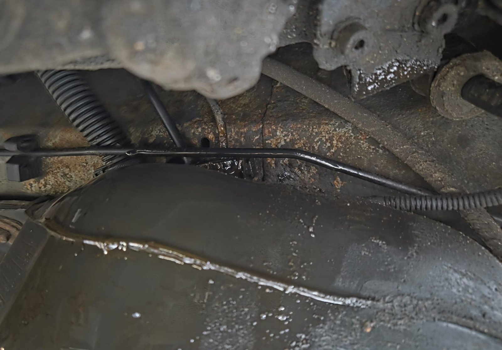

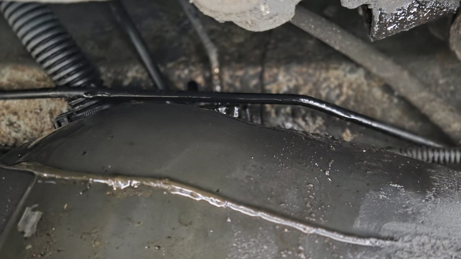

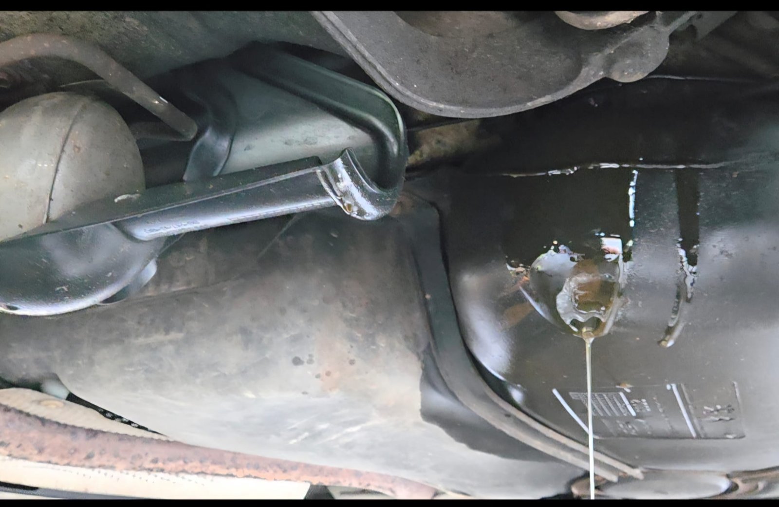

Have substantial fluid leak just above fuel tank towards the offside rear.
Can anyone tell me which pipe is most likely the culprit ??

Oh, I think it's the long front - to -rear pipe that has a rusted bit. Mine did the same and it's not the easiest thing to replace. It goes up and over the fuel tank. Some people cut the pipe and add a repair section but I don't recommend it. I am not sure how available the pipe is. I ended up getting an aftermarket copper pipe with special ends from a guy who made them in Russia. That's not really an option any more for obvious reasons.

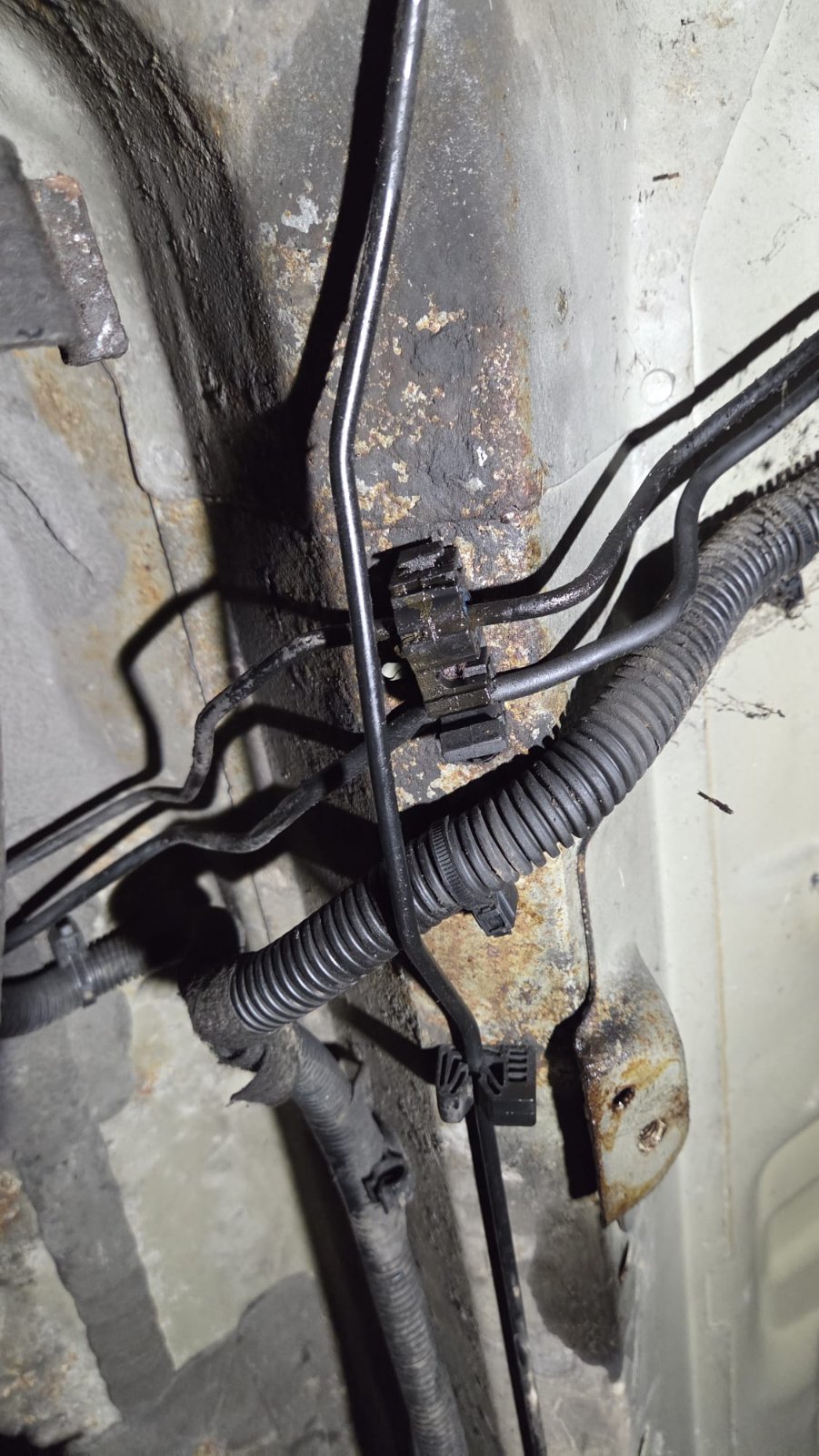

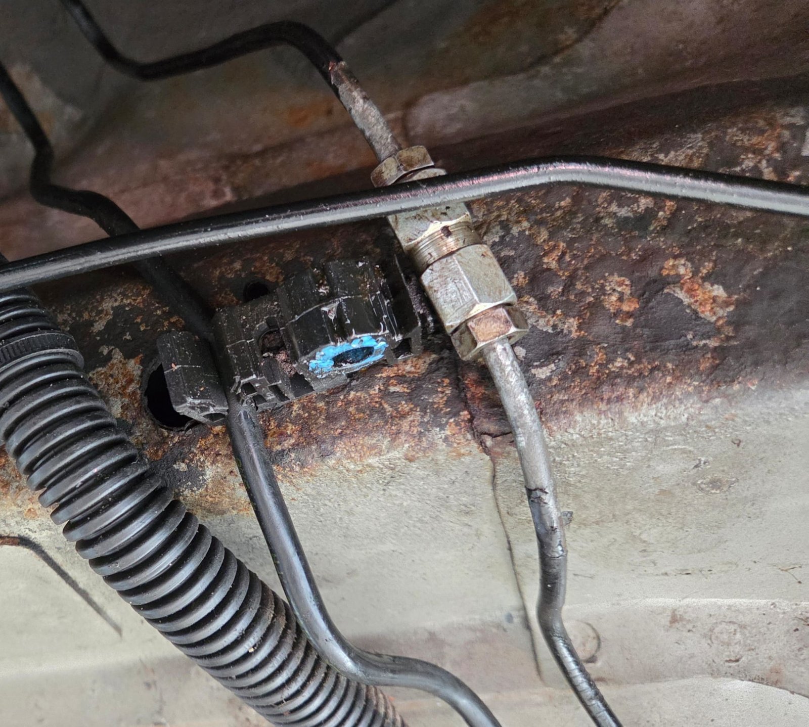

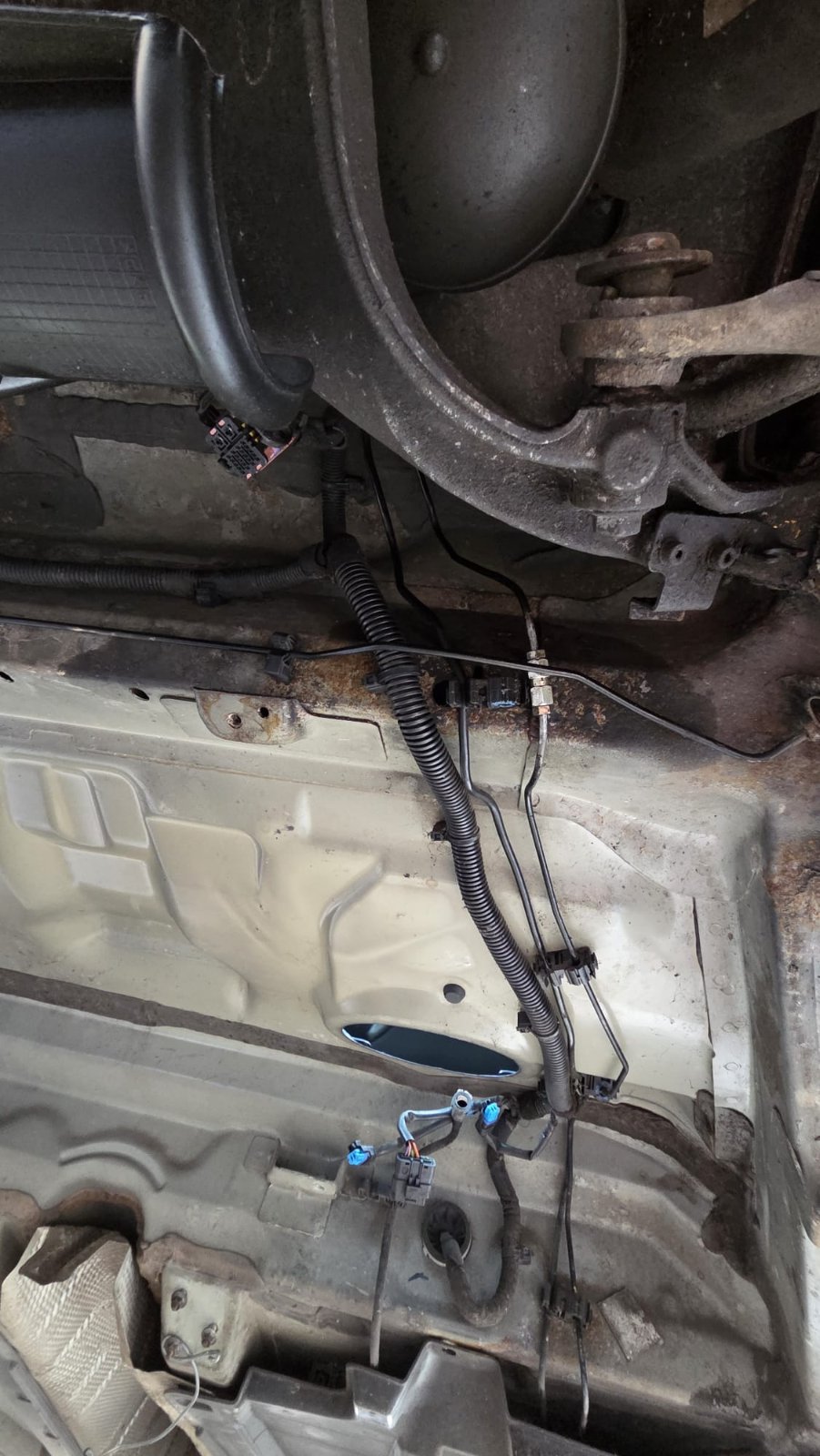

Have hopefully fixed the leak .....
It was a pin hole in the pipe where it clipped to underside just above fuel tank.
Managed to drop the tank and then access was easy. Got a guy from our local Pirtek hydraulic specialist to come out he cut the pipe, flare the ends and connect them with a suitable connector.
Replaced the tank and tested it no leaks and suspension now all working again...
