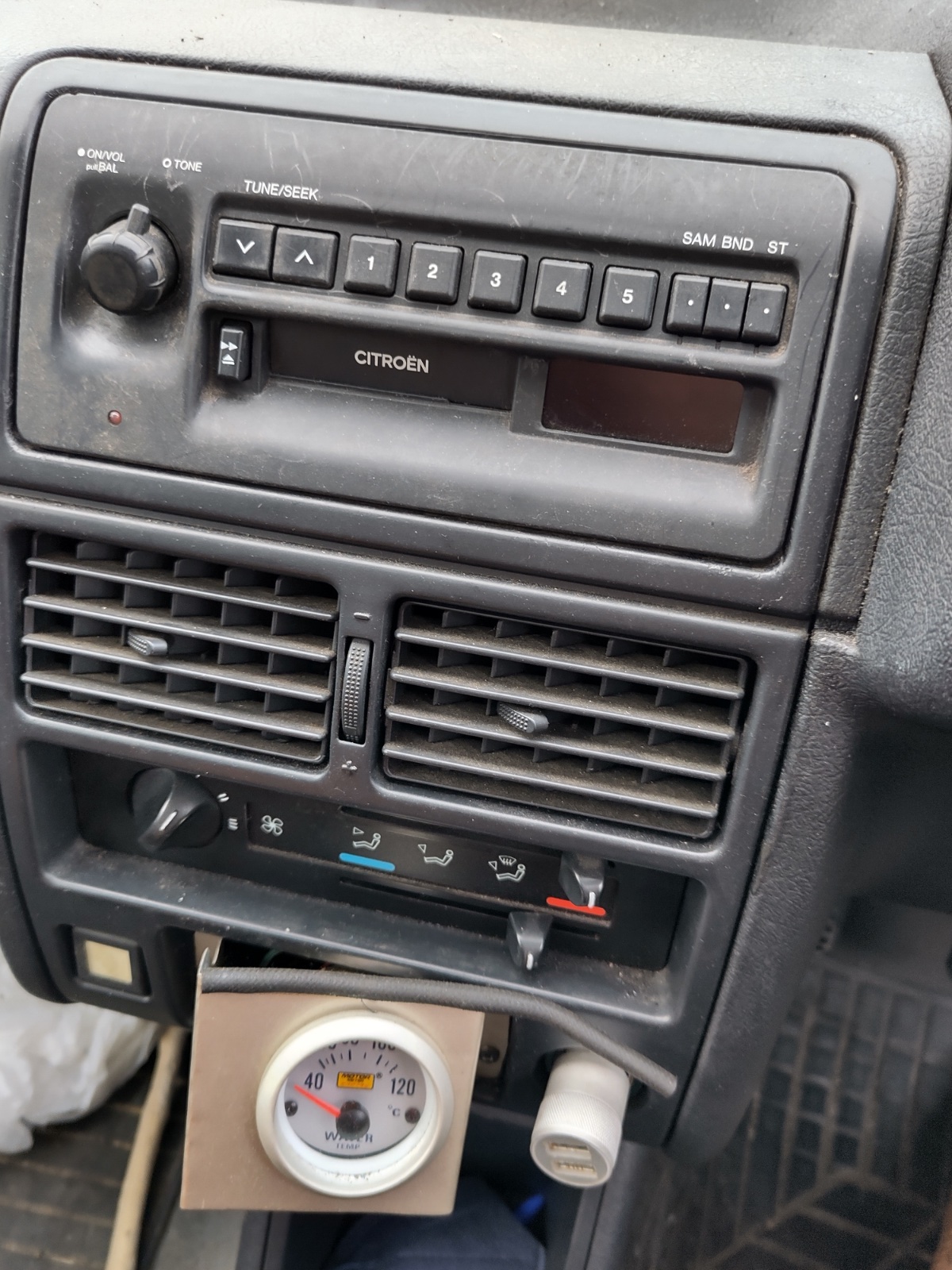

K Reg AX 14TZD (1982-83) Original radio fitted - only identified as CITROEN on the cassette flap.
Looking for Instruction / User Manual. Managed to get it going recently - but has now reverted to showing 1111 on the LCD display.

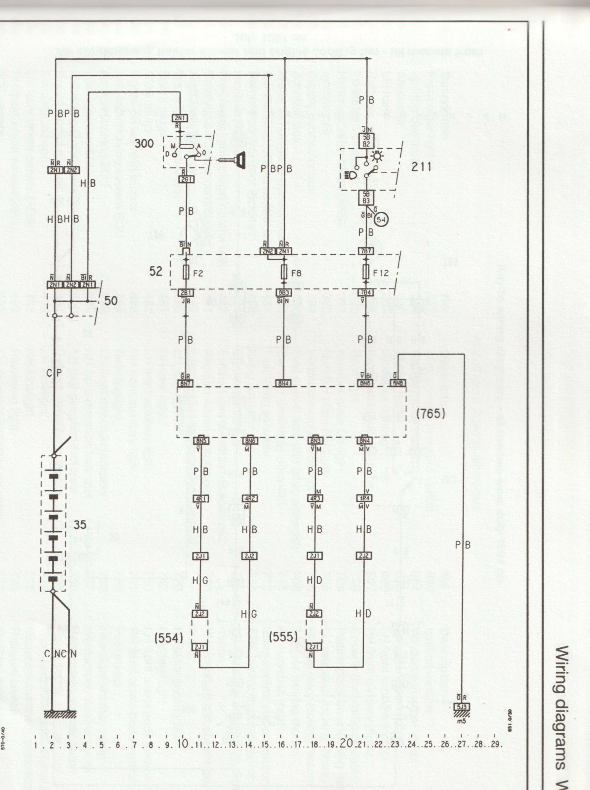

It sounds as if the radio is loosing its memory 'keep alive' supply. I'm assuming the '1111' on the display indicates it requires its code to be entered and then once entered it works until the ignition is switched off...
The 'keep alive' supply should be present at all times and irrespective of the position of the ignition switch.
I will look out some wiring diagrams later so this can be checked.
- Posts: 55131
- x 8412
Re: AX11 Citroen Radio/Cassette instructions
FWIW, here's the wiring diagram for the radio...
Item 765 is the radio and Item 52 is the cabin fuse box...
