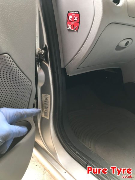

There should be a sticker in one of the door shuts with several information items on it including tyre pressures. Usually the driver's door but not always.

Thanks for replies guys. The online "tyre pressure.co.uk" link and info seems good, remember I when I first got car around 9 months ago I came up with 30/30 from an online search, and have been running on these pressures since then. However noticing both fronts were wearing on outer edges while still a decent tread depth to them led me to question if pressure was correct. But maybe this is electric car tyre issue. Definitely no data sheet on any of the door areas, as per the pic supplied, but thanks anyway.

On my 2025 C4 hybrid, same tyre size and profile, it's 2.4 bar front, 2.1 bar rear, and 2.6 f 2.7 r fully laden.
The label Is at the bottom of the B pillar, nearside ( trailing edge of passenger door). The handbook doesn't say what the pressures are but does have a section showing where the various labels are and what they show.
The e C4 might be a bit heavier and need higher pressures.

I wonder why the sticker is missing, has the car been resprayed where it should be located ? I have yet to own a Citroen/Peugeot that did not have the sticker on a door pillar. As well as tyre pressures it gives the rpo number which equates to the date of manufacture and at which factory if there are letters after the rpo number and also the paint code.
