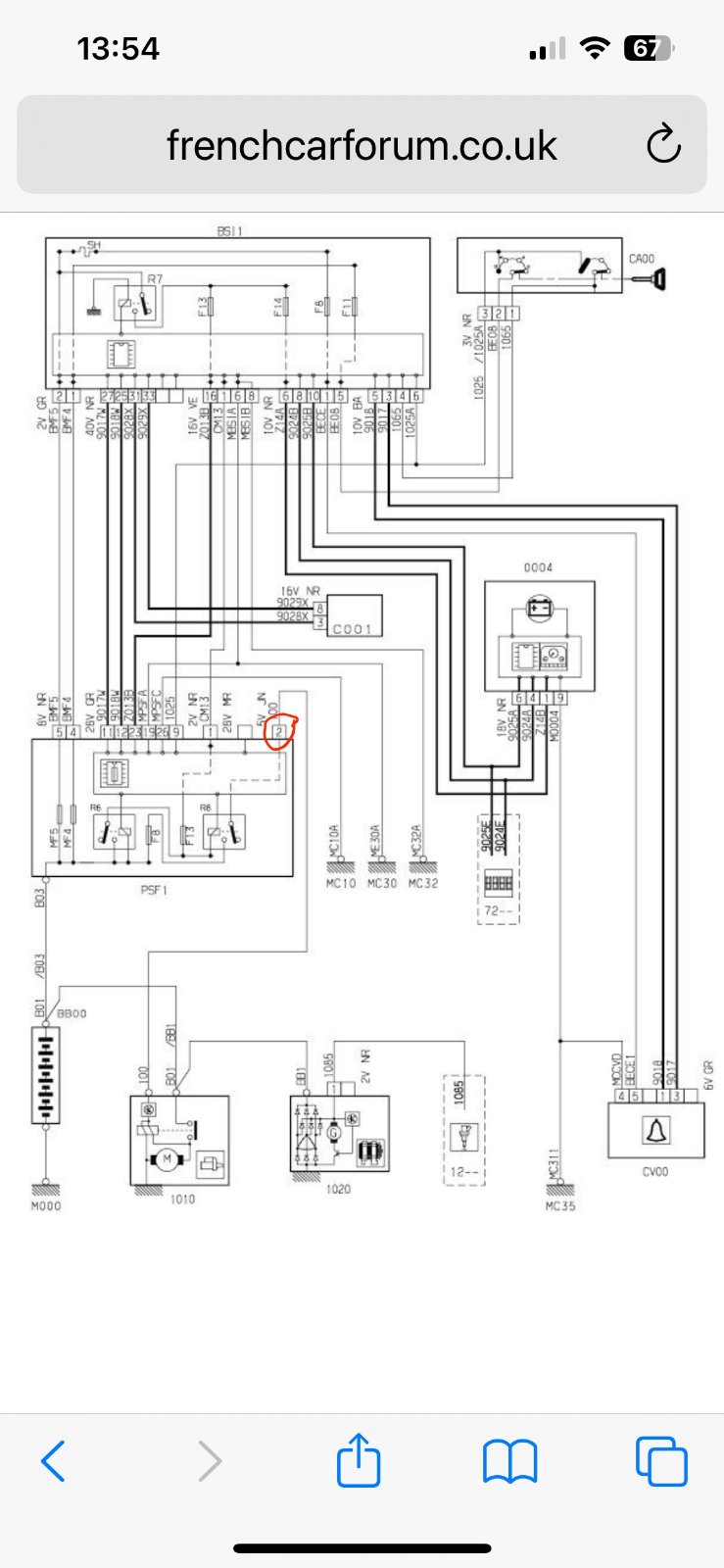

so if i run a cable from this circled cable to batt + this is the starter solonoid & should work the same as getting under car?
