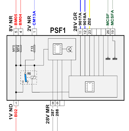

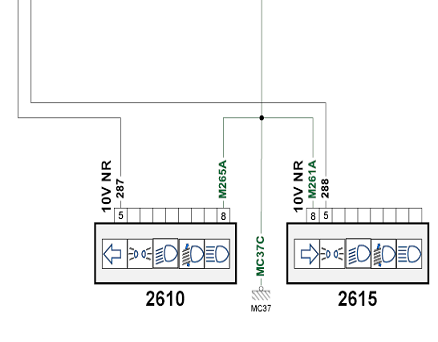

2615 is the Right hand Headlamp, with indicator on pin 5 (288), ignore colours - they change. The earth is on pin 8
The same is for the Left hand headlamp (2610), but the wire id is 287.
I can't see a fuse for these, so it may be an internal relay in the engine fusebox shown below:

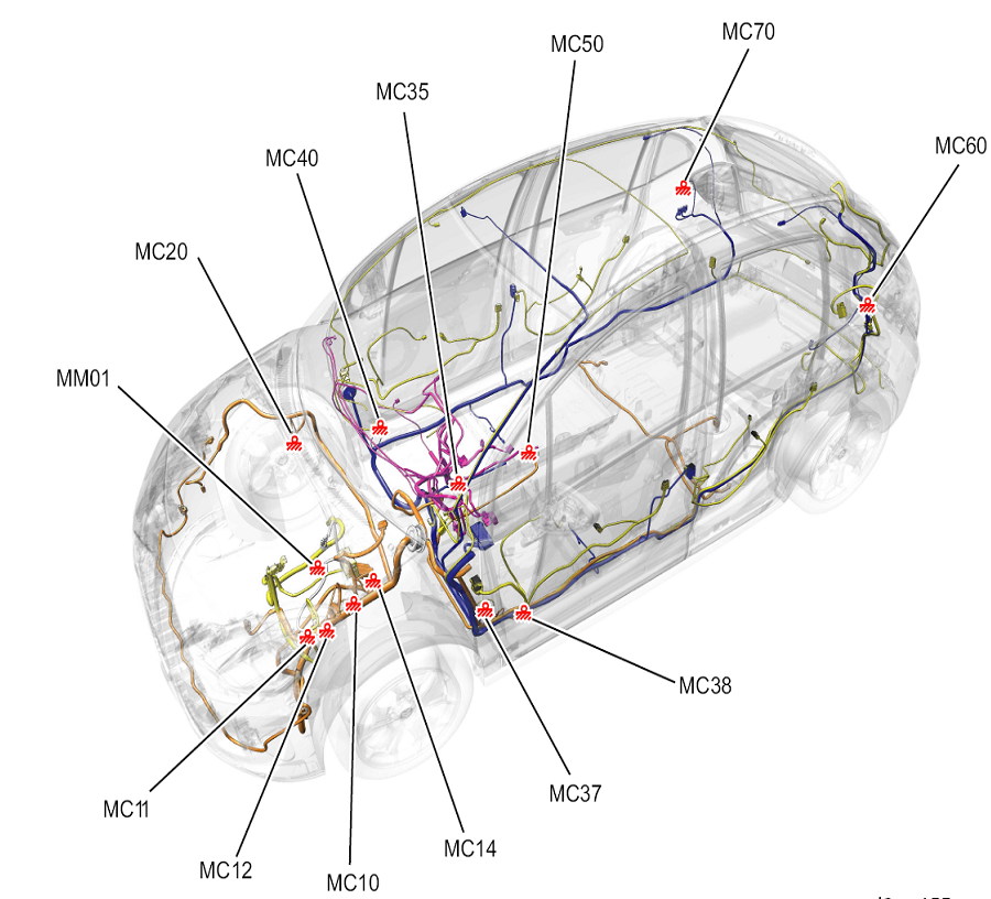

It may be worth checking the earth wire, (MC37) shown below, from Pin 8 on the Right headlamp, but these share the same earth point, so could only be the specific Right Hand wireor earth, unless it is internal to the fusebox.
