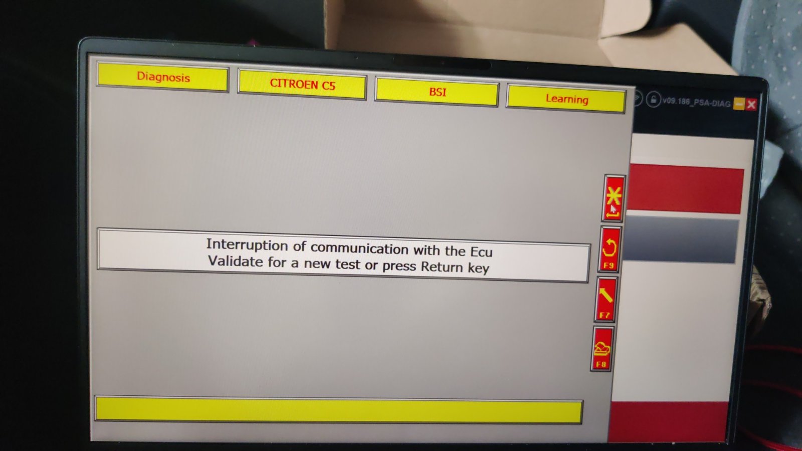

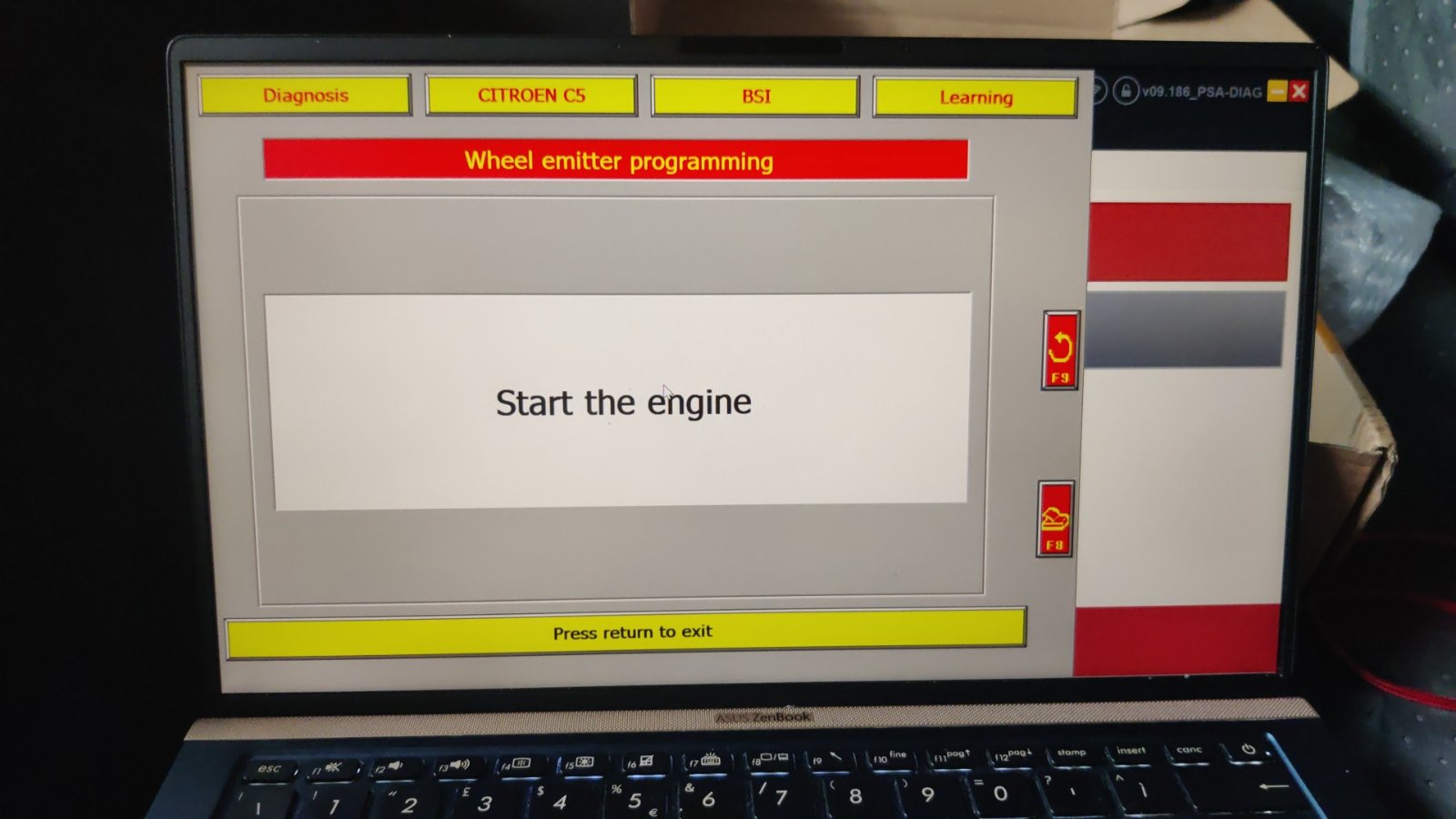

I am unable to successfully enable the sensors. I'm attaching a few screenshots of the process (which I can't include here, but they show the steps).
The strange thing is that when I try to start the acquisition, the procedure first instructs me to switch the ignition OFF. Then, it asks me to start the engine. As soon as I start the engine, the connection seems to be immediately reset/lost.

Just enter the oke key without switching of the engine and also when it says, start again.

When i start again ask me to put key in ignition off.

I have checked with old screenshots, and i confirm that learn procedure for tmps working.
Why is there a reset of communication

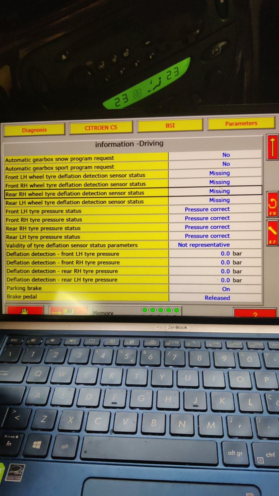

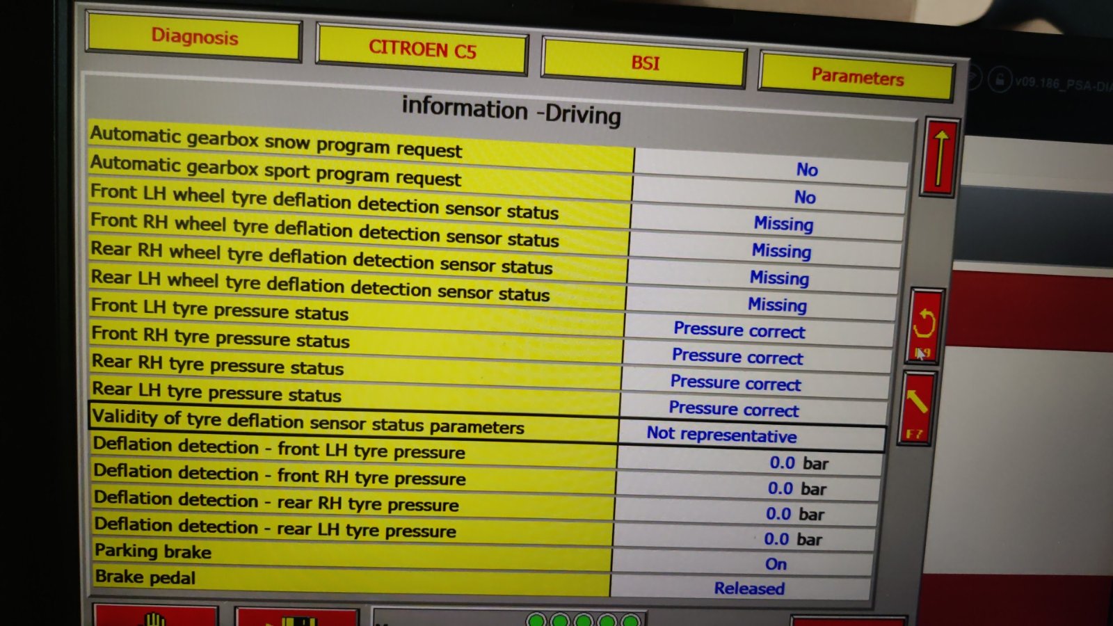

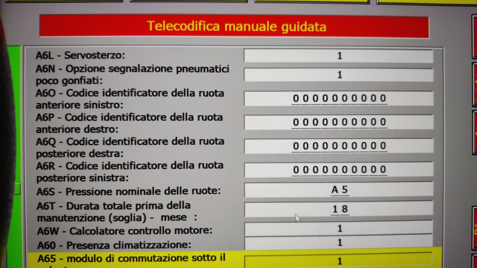

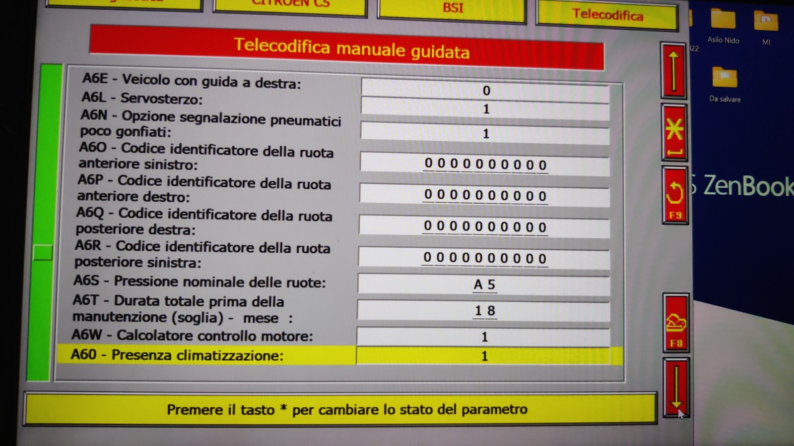

Can anyone check if id tyre sensor are numbers or only 0

Update:
Add id sensors and now it's work.
In fact at the begin i have a real low pressure, after i have no alarm.
But the procedure for learning sensors go in error for engine power on. Any advice?

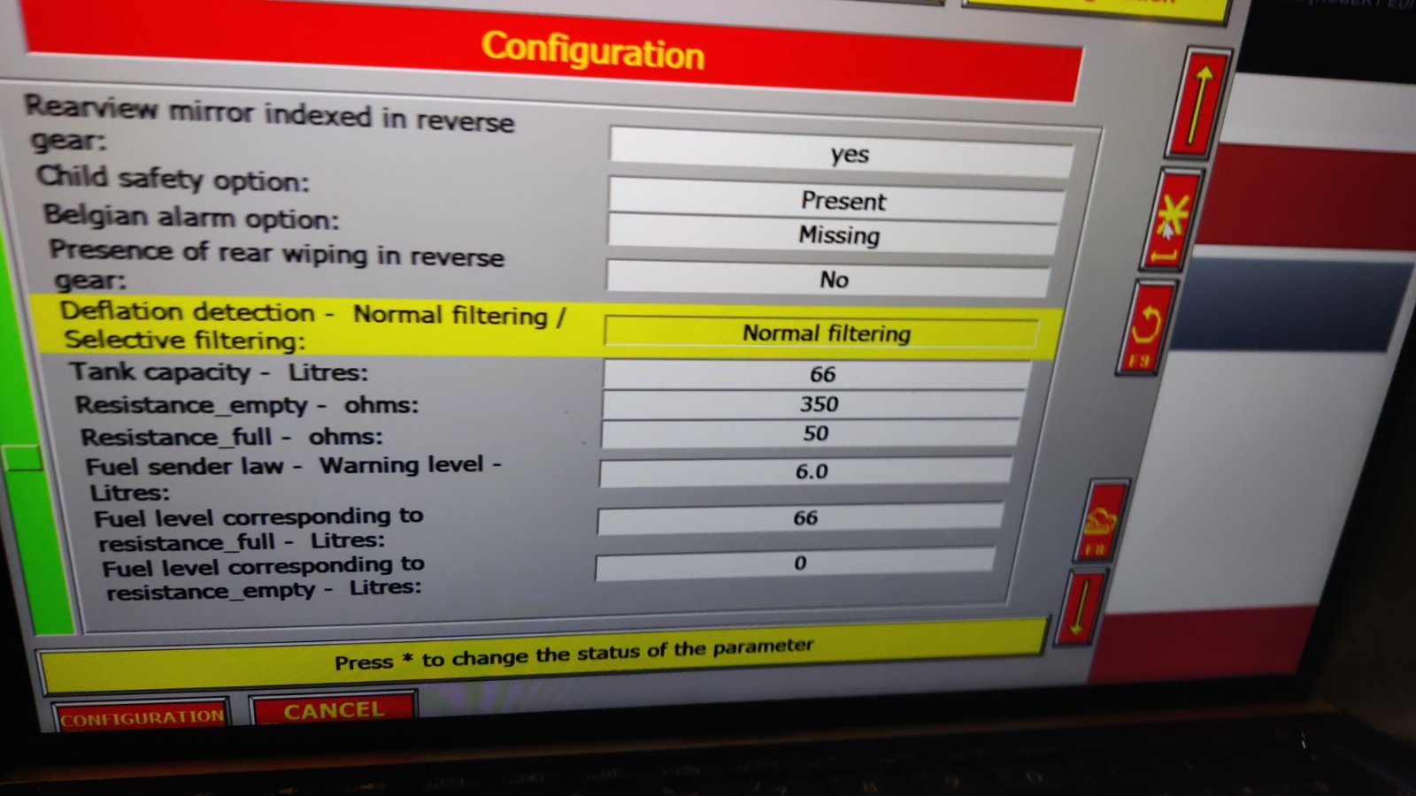

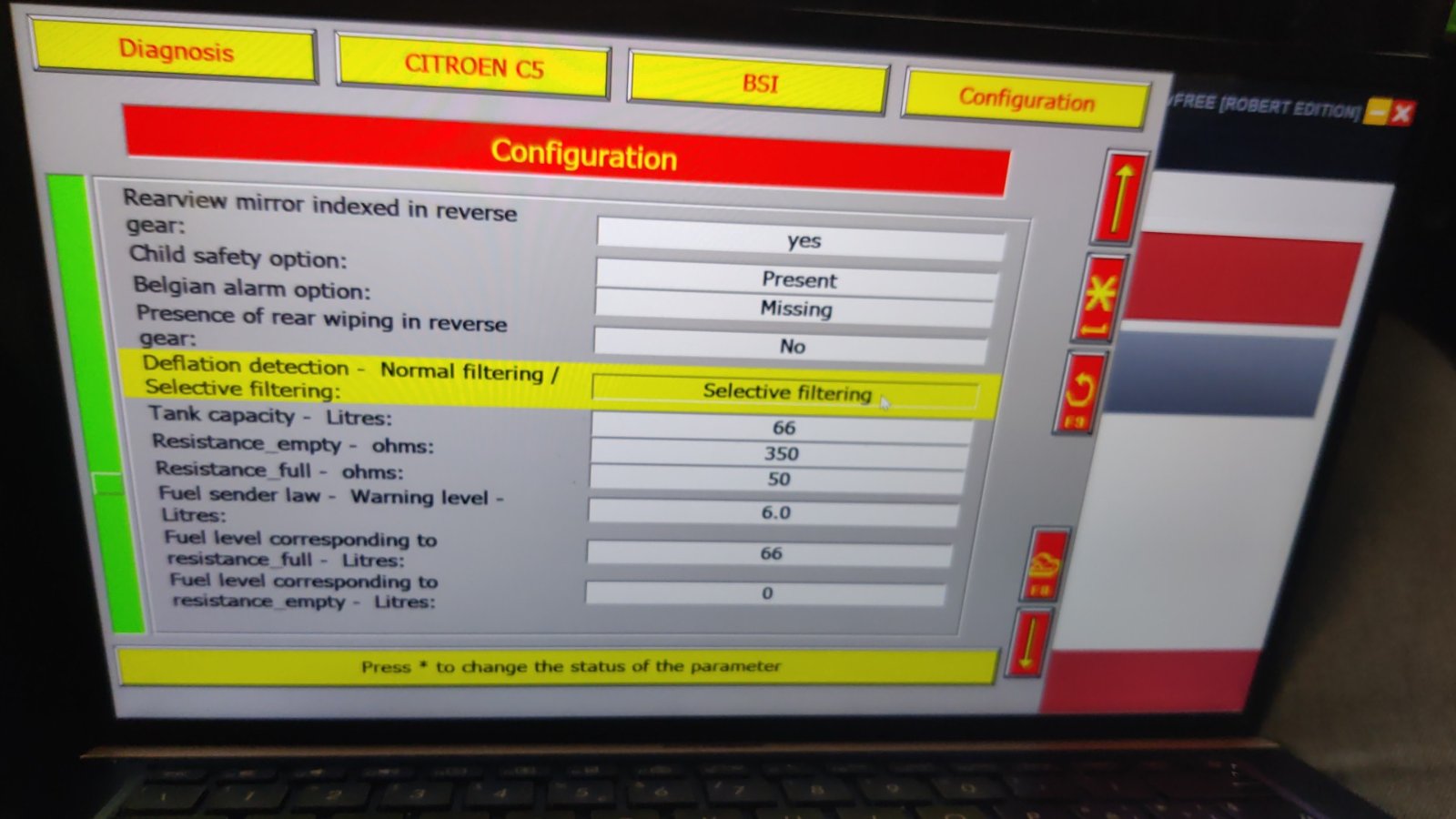

About the option inside autodiag, filter for deflation detection, what's the difference between normal and selective filtering ?

Spix wrote: 09 Jan 2026, 19:39 Is there a way to display real-time tire pressure on the dashboard, or does the control unit only send a notification when a tire is flat?
I believe it only provides warnings, not live display of pressure (frustrating considering the ECU does have that data - the X7 is the same).
Sorry not able to help on the other queries.
