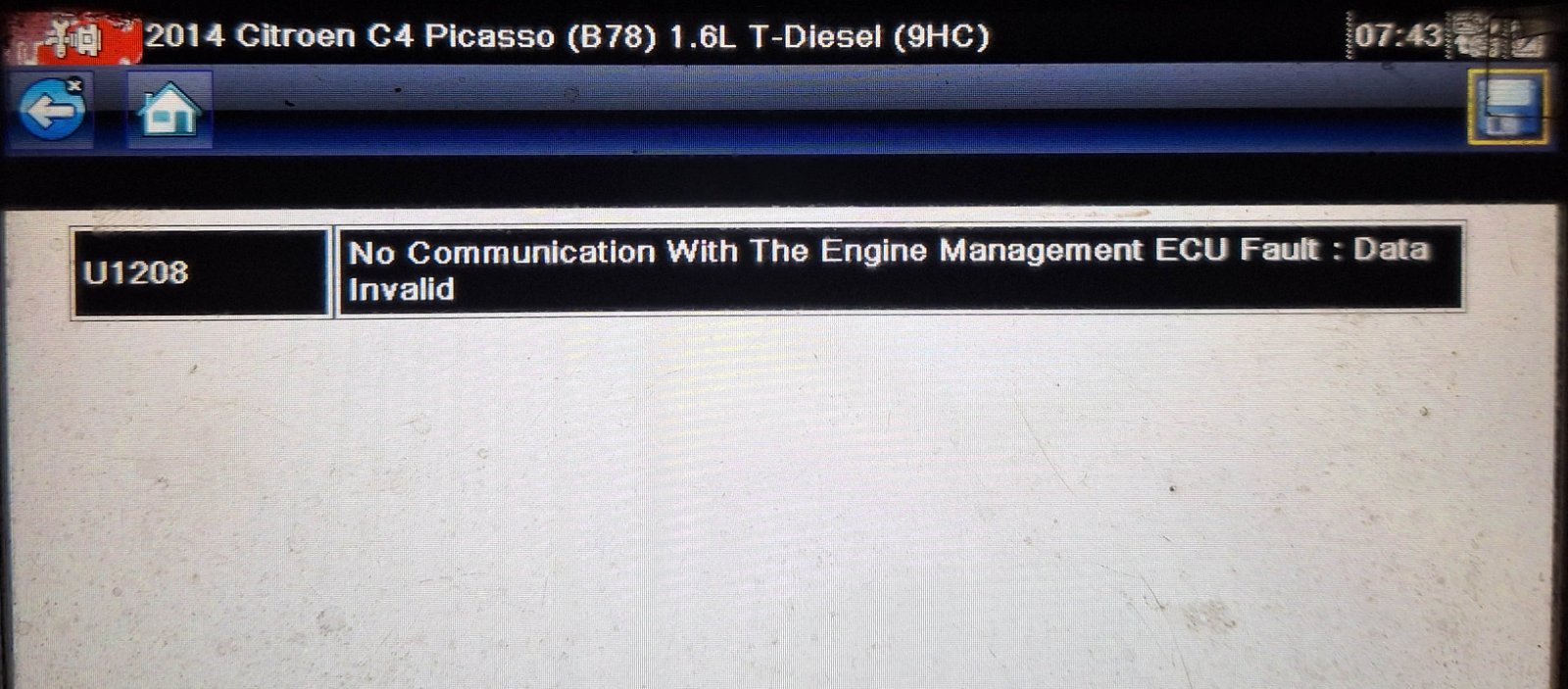

The image above showing U1208 is the only code being read by my snap-on scan tool

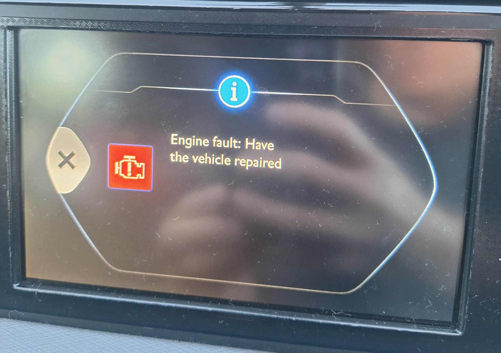

2. Get a beep and "Engine Fault: Have the vehicle repaired" appears on the car screen.

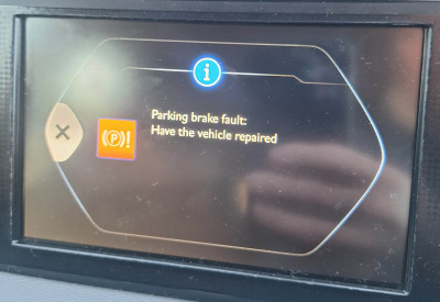

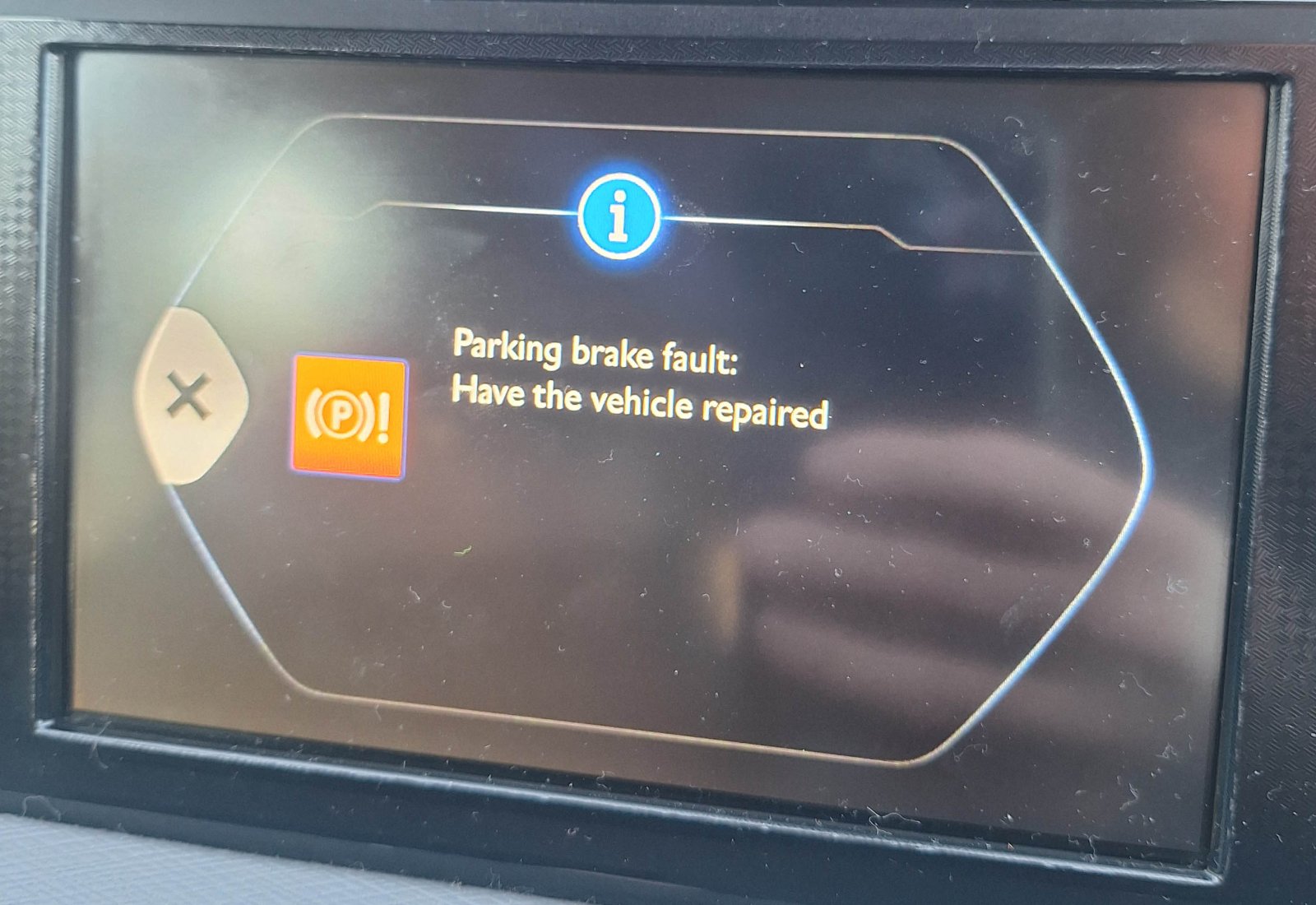

3. When the car starts get another beep and "Parking brake fault: Have the vehicle repaired" appears on the car screen.

Which ECU is that fault recorded in? The brake fault is almost certainly due to there being a fault in the engine ECU which interrupts the data. Have a look in the engine ECU and see if there are any faults.
