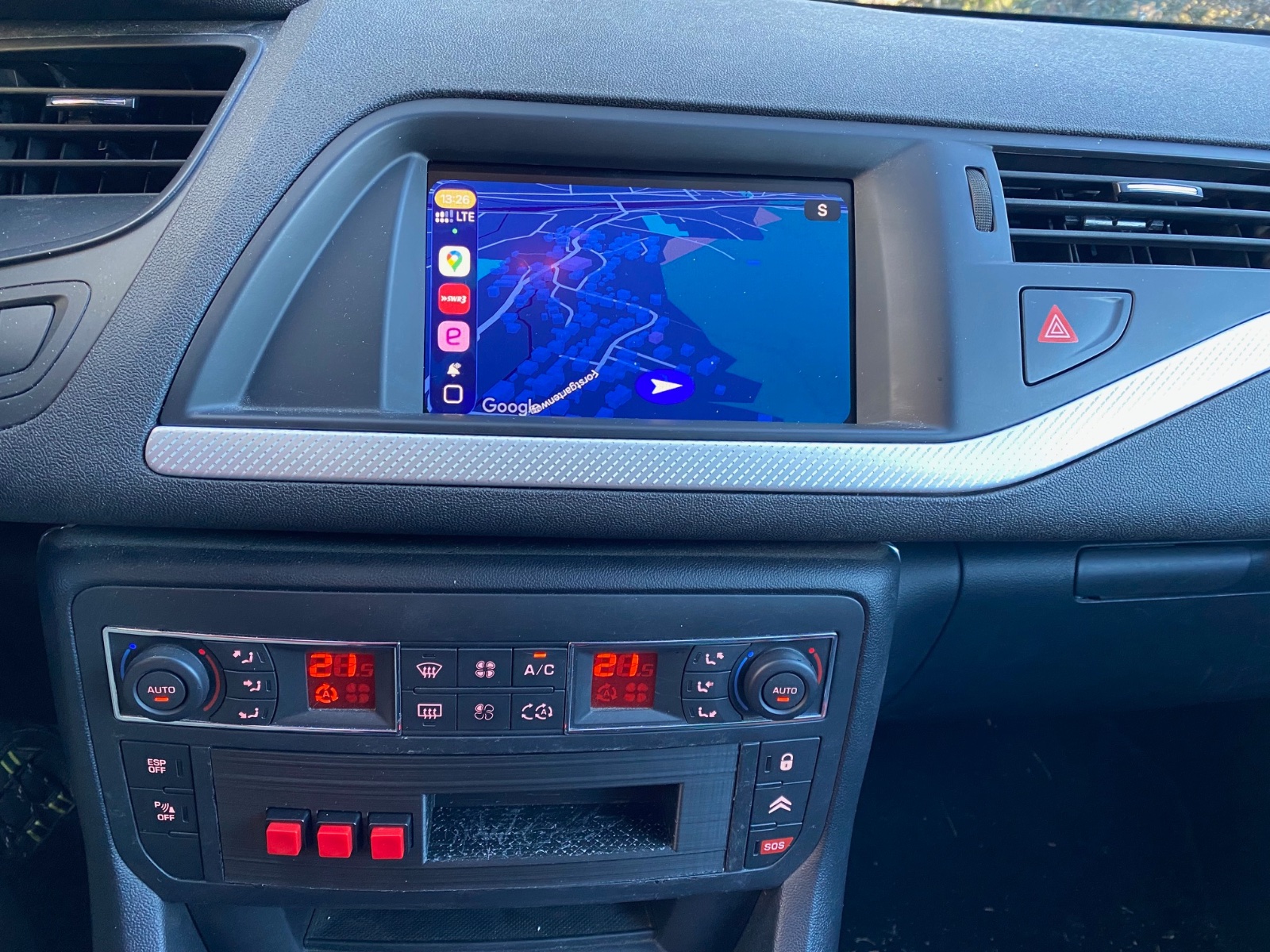

I started a little project and upgraded the RT6 in my C5 X7 2012 to a SMEG+IV2-Unit.
I only have access to "Offline DiagBox", so I did the configuration the hard way, by editing the Database-Files in the Head-Unit.
The VIN could be changed using the RNEG2-Menu in DiagBox.
The Unit and display were from a DS3, so I had to modify some of the options and variables.
As I did not want to pay 120€+ Euros for the little plastic-cover in front of the Head-Unit, I modeled it with a 3D-Printer and it also houses the additional "Menu", "Vol+" and "Vol-" Buttons, which are wired directly to the Quadlock-Plug (see Photo). To cut a long story short: Nearly all the functions work (Camera, PDC, CarPlay, Radio) so it's perfectly usable. But there are two nice-to-have features, that are not working yet.

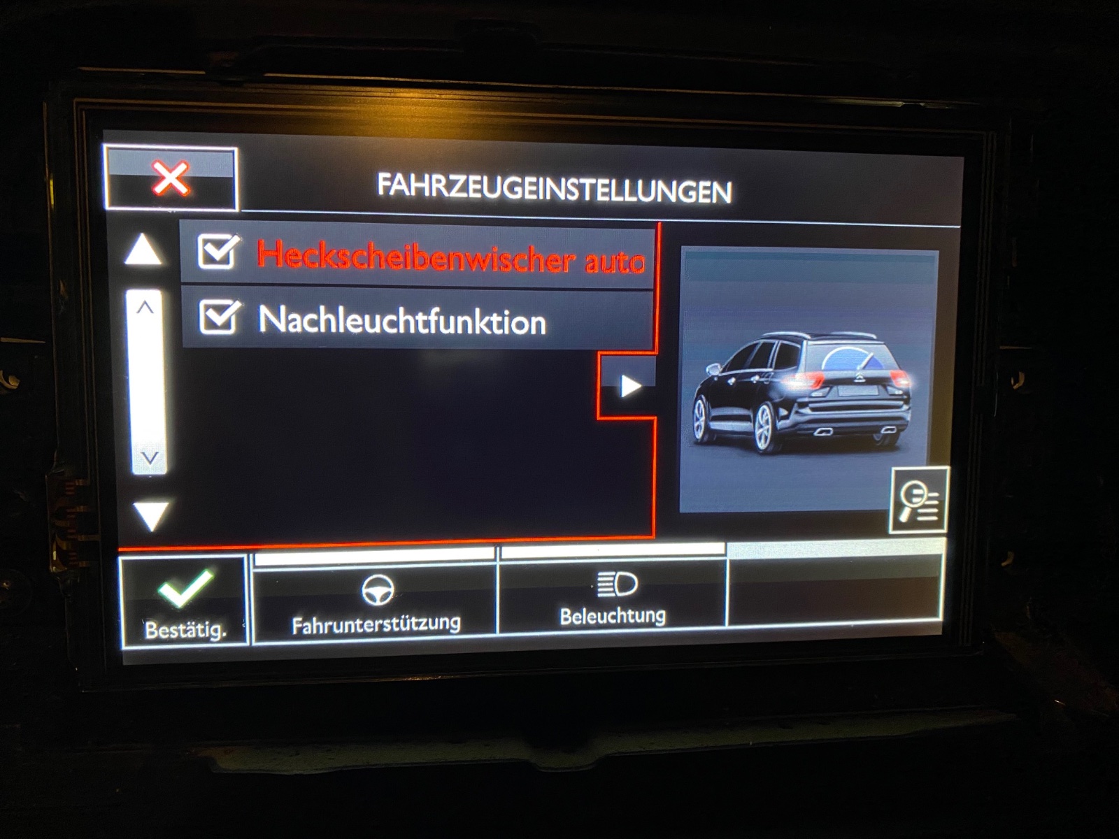

- The verhicle-settings (like Rear-Wiper, Coming-Home-Light) are being properly shown in the SMEG-Unit, but I cannot save them from there (see photo). They seem to be "Read-Only". - I did not manage to activate the pop-up Menus für "door-open" and such (see photo attached how it "could" look like). It this even configured in the SMEG-Unit, or somewhere else via Diagbox? I know, this is quite "niche" but maybe somebody is into this.

No, did not use the CD-Player anyway and using CarPlay is much better than juggling CDs.Paul-R wrote: 24 Nov 2025, 07:11 Can't help with your problem, sorry, but I must congratulate you on your upgrade. I presume that you have not worried about the loss of the CD player? Is your USB socket still under the centre armrest?
The USB-Plug of the RT6 was compatible to the SMEG-Unit, so I was able to just keep the USB-Plug in the armrest.
Thought about placing a USB-Port in the new cover because reaching the USB-Plug in the armrest while driving is "challenging", but decided to keep it in the original place.
There is a AAWireless Wireless CarPlay Adapter in the Armrest now.

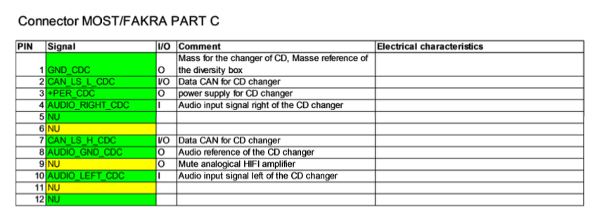

In the official PDF-Document for the SMEG+, there is also a Documentation of the Pin-Out for the CD-Changer: I'm not sure, if it's the same PIN-Out for the IV2, but I'd say it's pretty probable.wurlycorner wrote: 24 Nov 2025, 13:09 I like CD's so an interested to understand if there's a way to retain functionality on that, via autochanger.

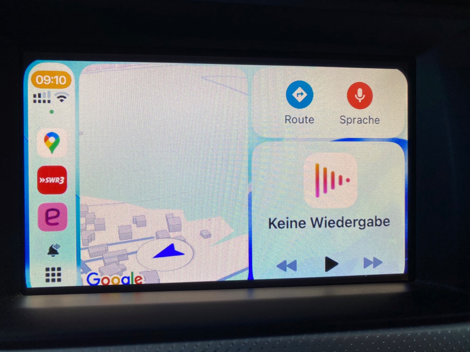

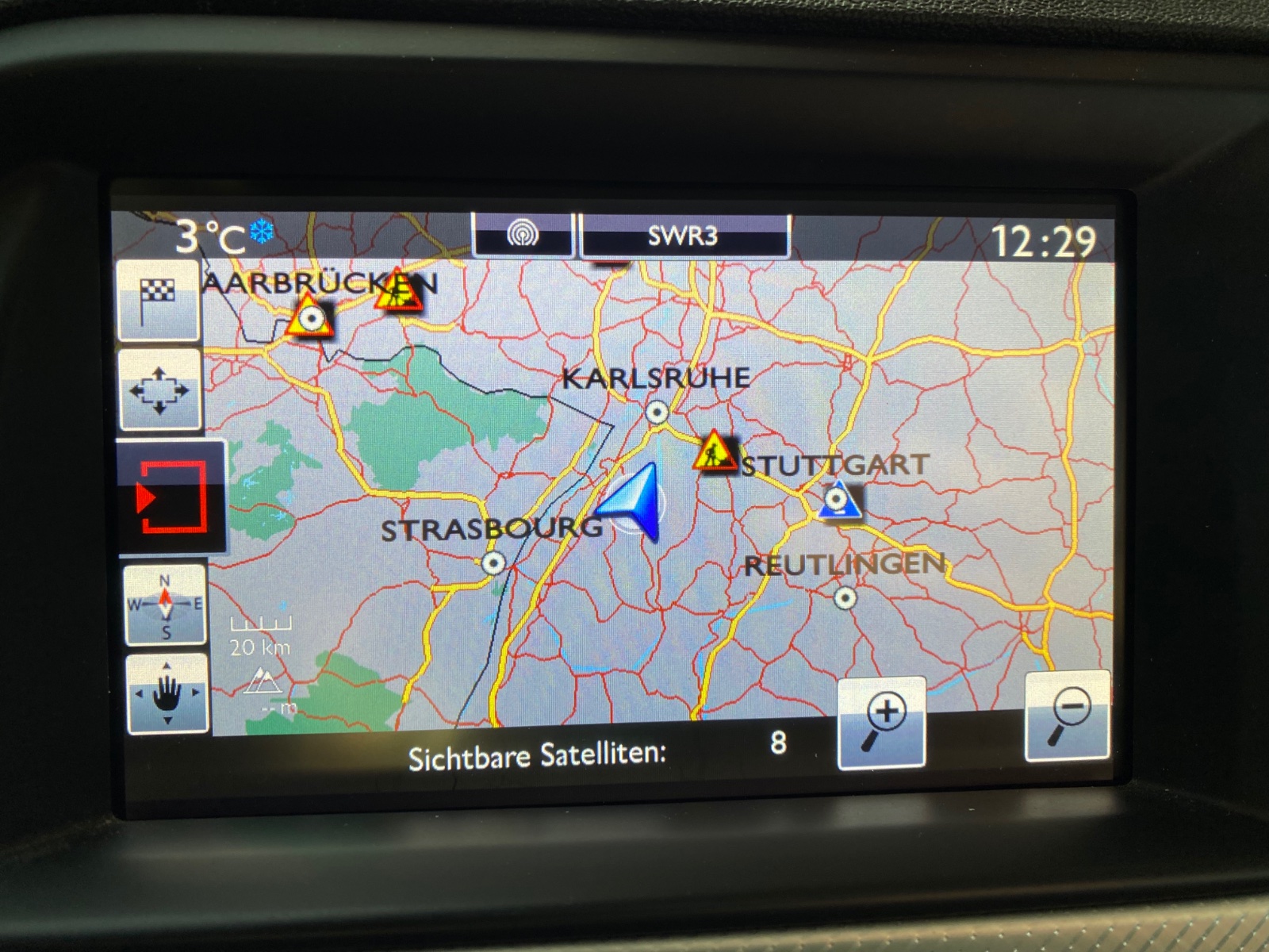

I made some changes to the setup this weekend and replaced the Head-Unit for a different one (Niveau F2 with integrated Sat Nav and DAB).
I reused the config of my prior Head Unit (Niveau B2) and everything is working, but there is one thing:
When using CarPlay, with this unit, in the lower section a little bit of the screen is cut off: This has not been the case with my other SMEG+IV2-Units.
I upgraded from 6.3 to 6.4, but nothing changed.
Is anybody using CarPlay on an original 2015-2017 C5 X7?
Is this normal behaviour, or can it be fixed by some parameter?
Best Regards
Richard
Best Regards
Richard

I think you've gone further with this upgrade than I've seen anyone else post up on here so far - but would definitely be interested to see if others have done similar.

I could be wrong but I think I can see a slight amount of cropping at the top and a very slight amount of cropping on the right.

Thanks for the replies.
The strange thing is that the cropping only seems to apply to the CarPlay screen.

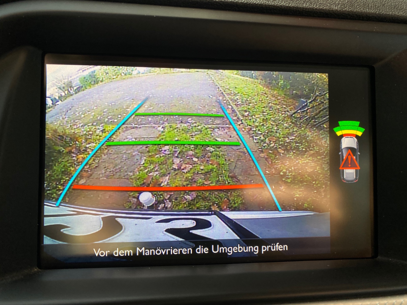

The rest of the GUI seems to be fine (general GUI and AVR Picture from the cam). I‘ll see if I find a solution and post if I do.
