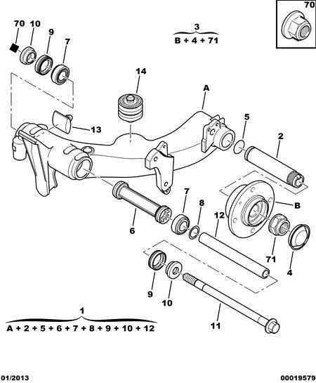

i am trying to work out if the item number 13 product code 5166 65 rear susipion rebounb block would cause a slight pop noise if wore out i have replaced number 14 rebound block any ideas diagram and picture added

I should think it may do!

More a "Thud".....
What are you driving over when you hear this "Pop"
The rear bearings are well known for making a noise when going at slow speeds over speed humps etc......this is a known symptom that the rear bearings need replacing. This cannot be checked with the car on the ground as it is under tension.

wheel bearings brand new so i going to order some rebound blocks then modifed them to fit and put pics up were i can

I think Stickyfinger might be referring to the arm bearings, possibly part 7 in the diagram and not the wheel bearings.

could be but in the diagram i referring to no 13

I am..........PaulC5 wrote: 24 Nov 2025, 21:36 I think Stickyfinger might be referring to the arm bearings, possibly part 7 in the diagram and not the wheel bearings.
