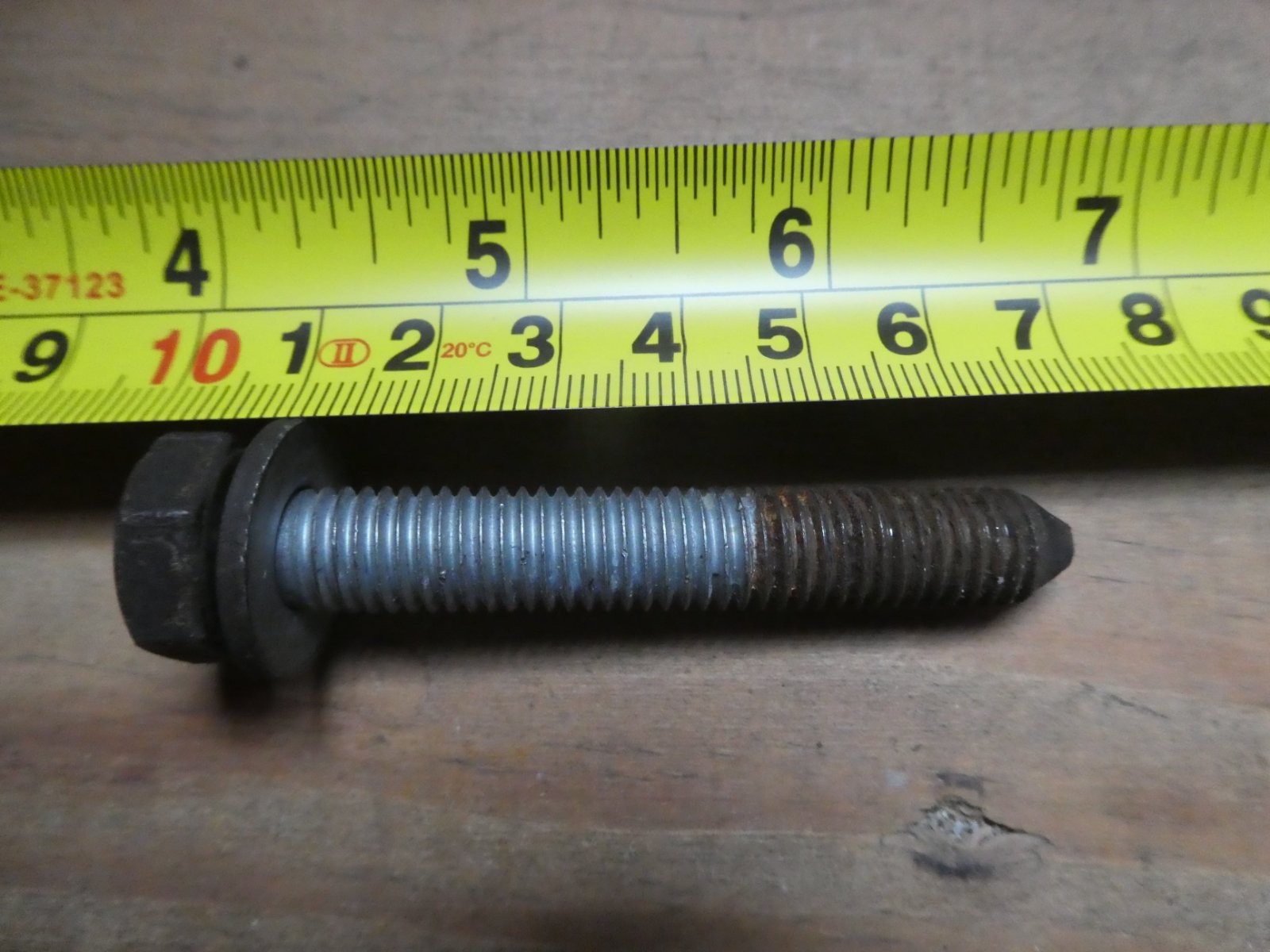

This is the mystery bolt. Note the rusted exposed area, clues. Size 10mm x 71mm.
I replaced the suspension swivel joints and bolts (one snapped on removal). I wonder if this might be long and I think the rust would also be in the middle. I suspect it must have come from somewhere else.

That looks like a gearbox to engine or gearbox to body bolt.. As for 12v to starter I use a long length of wire, such as 1 out of a 3 core mains cabe, nice and flexible. With a small crocodile clip on the end to clip on solenoid. sort of clip from a multimeter or test lead. make it long enough to reach battery pos and make sure car is in neutral
