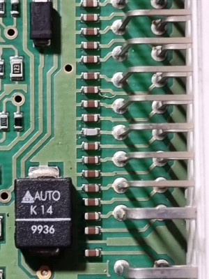

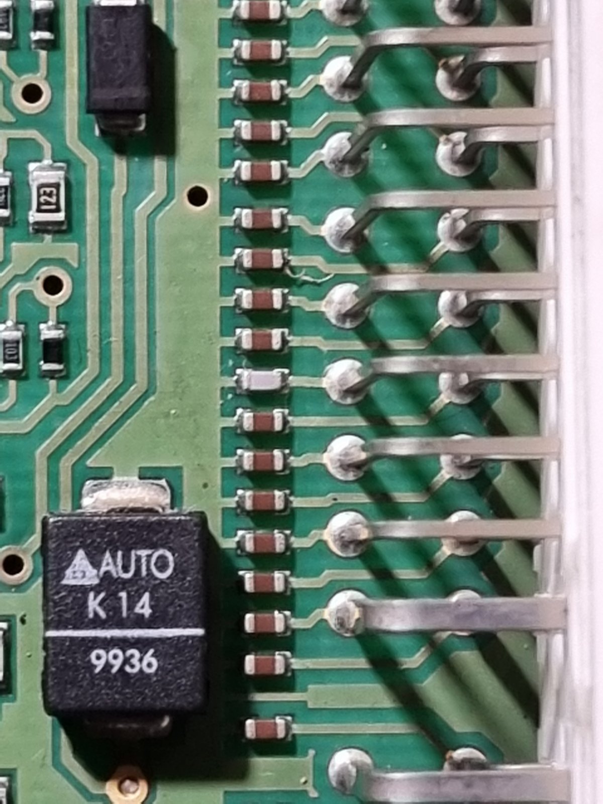

so I took the cover of the aircon box.
Does the fact that one of these is a different colour mean anything.

Potentially, yes it does. It depends upon what line it's on. Does it trace through to the Blower Regulator speed control line?peter306 wrote: 21 Nov 2025, 21:29

Hello Jim,
The fact that it's different exhausted my knowledge on this
How do I check where it goes to, I have visually traced it to a hole about an inch down.

We need the full wiring diagrams Peter... I'll see what I can do. I may still have them reasonably available... I'll have a look when I can... It may be a while as I'm currently up to my ears in many diverse happenings currentlypeter306 wrote: 22 Nov 2025, 09:55 Hello Jim,
The fact that it's different exhausted my knowledge on this![]()
