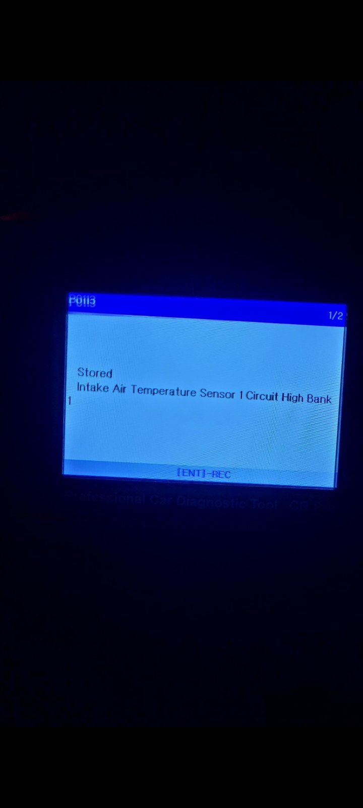

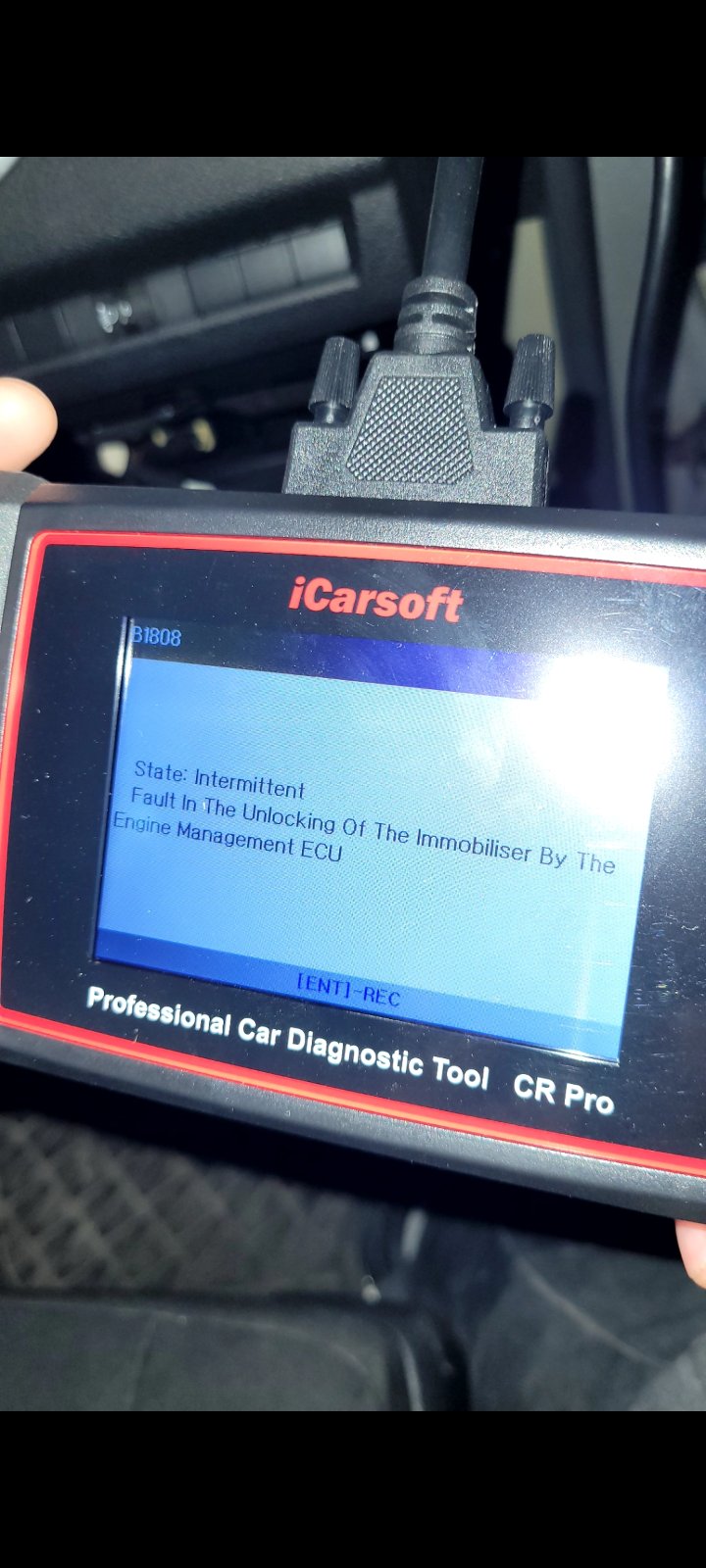

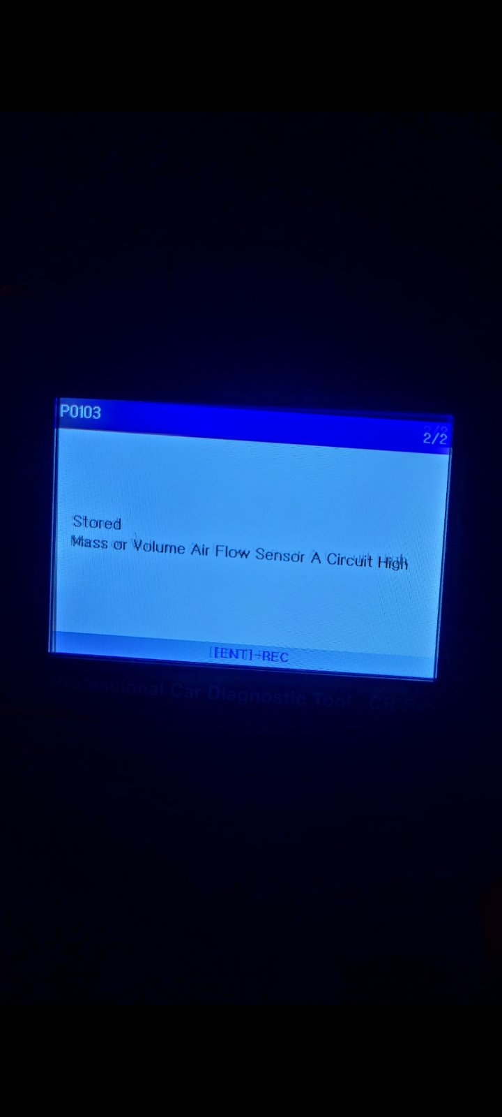

I've changed the MAF sensor and it made no difference but this other codes also came on. The fact turning the key off and back on quickly cancels it out has me baffled.

Can you see live data on the scanner? A fault for both would suggest an earth fault, or maybe failure of the 5V reference for those sensors (but then I would expect others sensors to be at fault as well).
