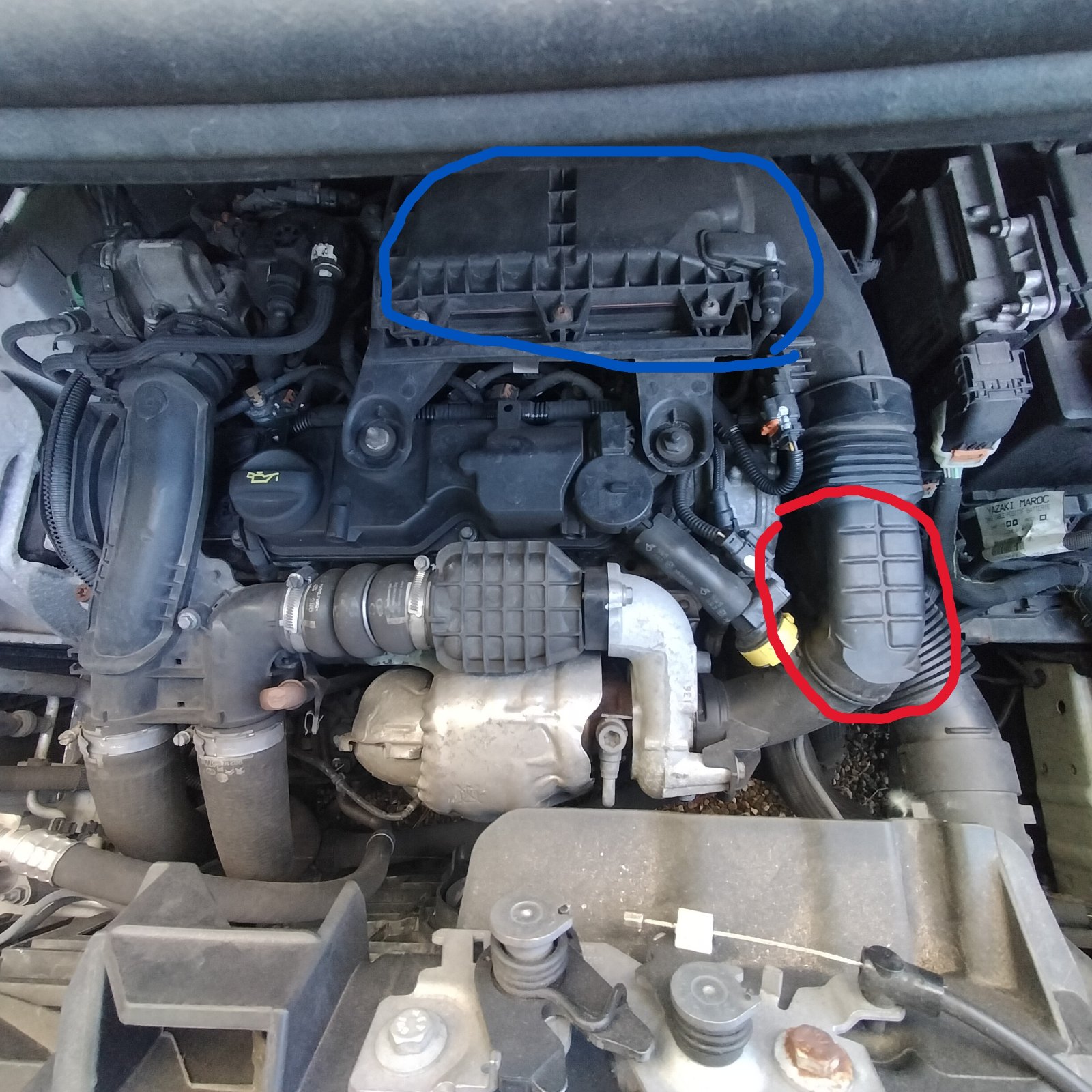

Hi all,
Bit of a basic question - sorry for my ignorance.
Where exactly do i spray EGR cleaner?
Is the blue circle my air filter housing? So i spray down the pipe circled red?
Citroen dispatch 1.6 Bluehdi XS 2018
Thank you

This video is on a 1.6 HDi C4 but basically the same as your engine. It will show you how to go about it, :)

mickthemaverick wrote: 24 Oct 2025, 12:01 This video is on a 1.6 HDi C4 but basically the same as your engine. It will show you how to go about it, :)
Thank you very much.
I was almost on the the right track. So is that the turbo?

The bit he sprays into is the turbo yes :)
