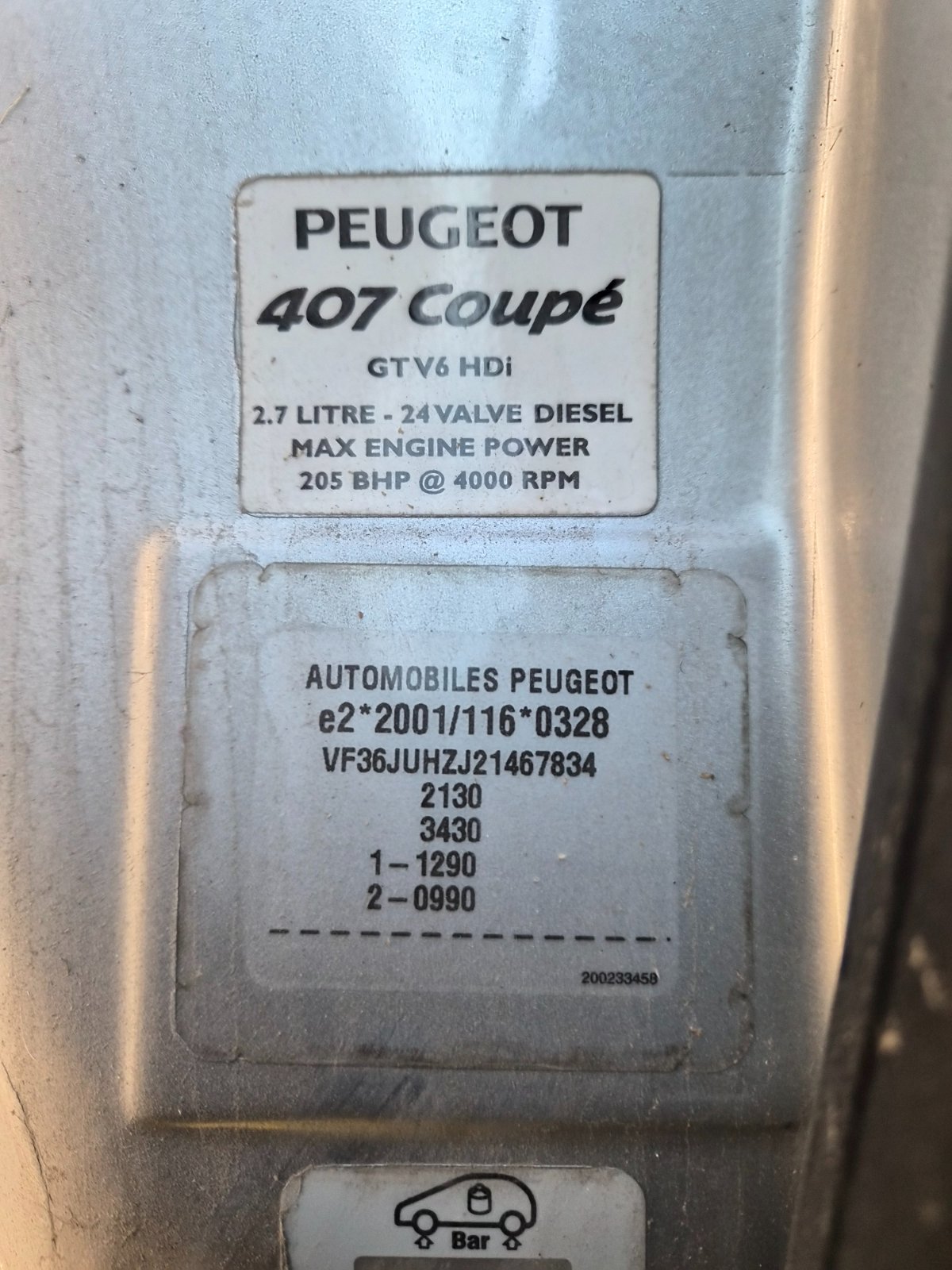

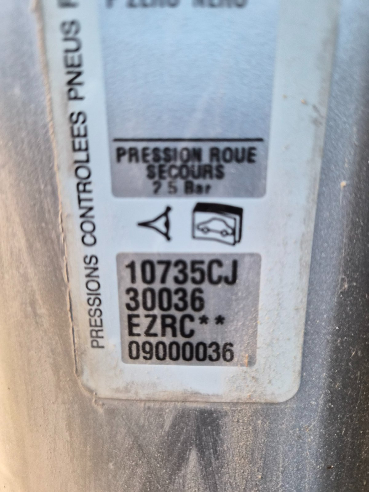

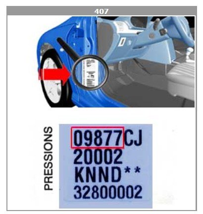

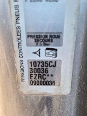

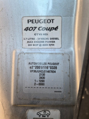

In order to access the diagram system I have I need to know the RPO number of your car as shown in the red box below? :)
Sed13
Posts: 4
Joined: 21 Oct 2025, 02:24
Re: 2.7 hdi can H 0v and grounding to earth
Unread post by Sed13 »
Is it good?
Reason: Images rectified

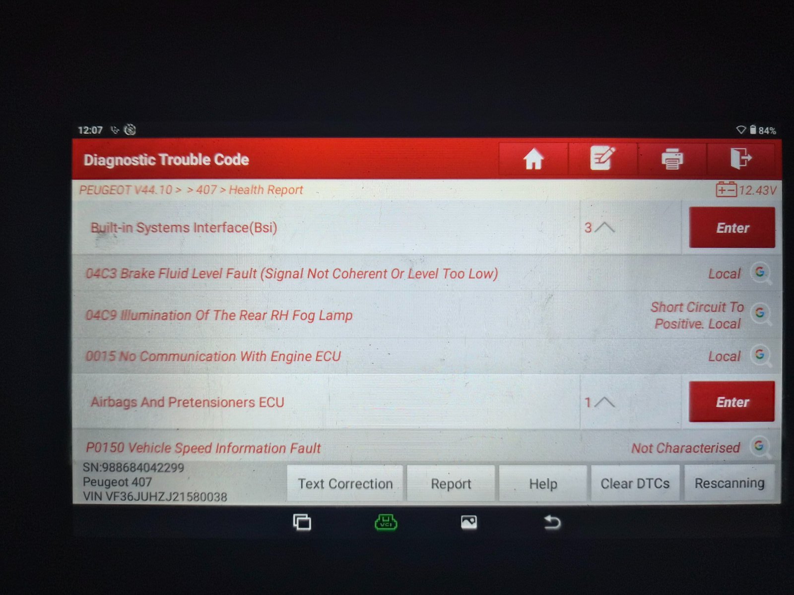

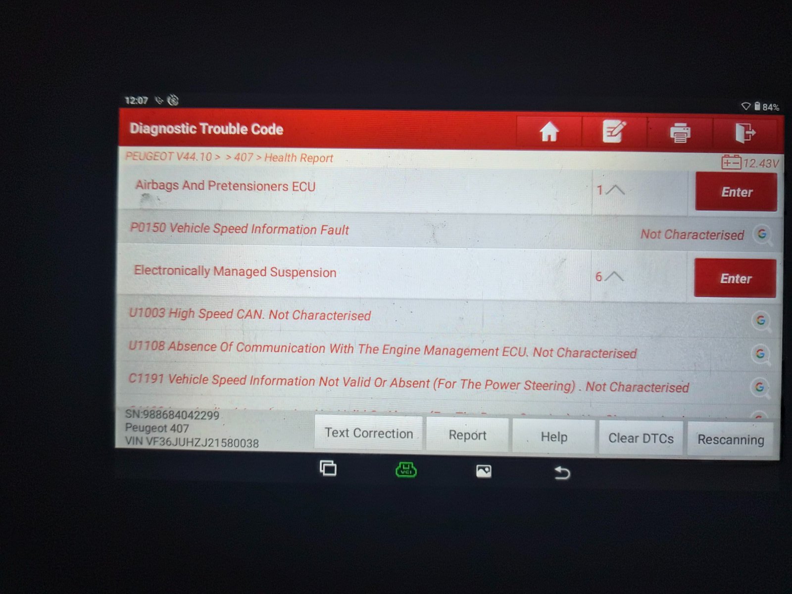

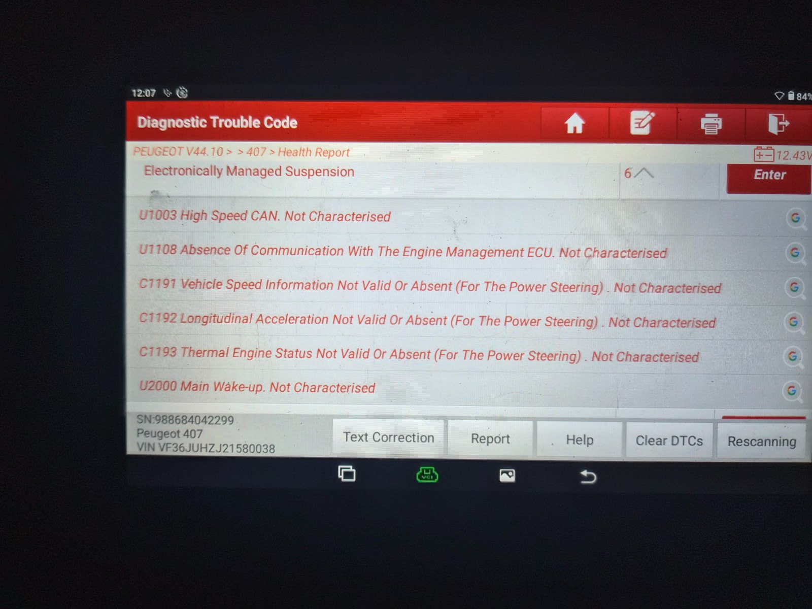

Hello guys! I disconnected for testing ECU, Esp/abs, PSF1, suspension computer, gearbox computer without any result for that Can H that goes to ground. But if I disconnect from BSI plug 40v NR, Can H no longer goes to ground. Can a complete BSI diagram or only on plug 40v NR? I did all the measurements in diagram 407 starting all the wires are good. I have the following errors:
Reason: Images corrected.
