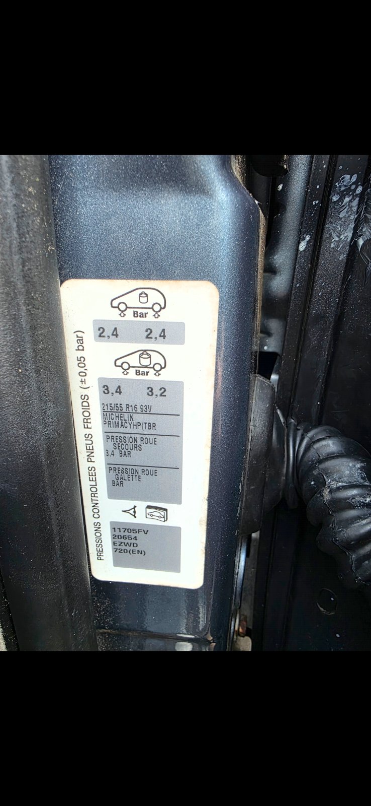

Still having issues with this, Anyone have a wiring diagram for the central locking at all?
Posts: 21229
x 8126
Re: Citroen C4 GP 2009 Central Locking Issue
If you can tell me your RPO number I can try and find the diagram :) This link and the 2 following posts show you where to find that if you don't already know: viewtopic.php?p=852428#p852428
AdamC
Posts: 11
Joined: 15 Mar 2015, 15:51
Unread post by AdamC »
I just took a picture, have another issue which I'll open a new thread for 😂
Thank you.
