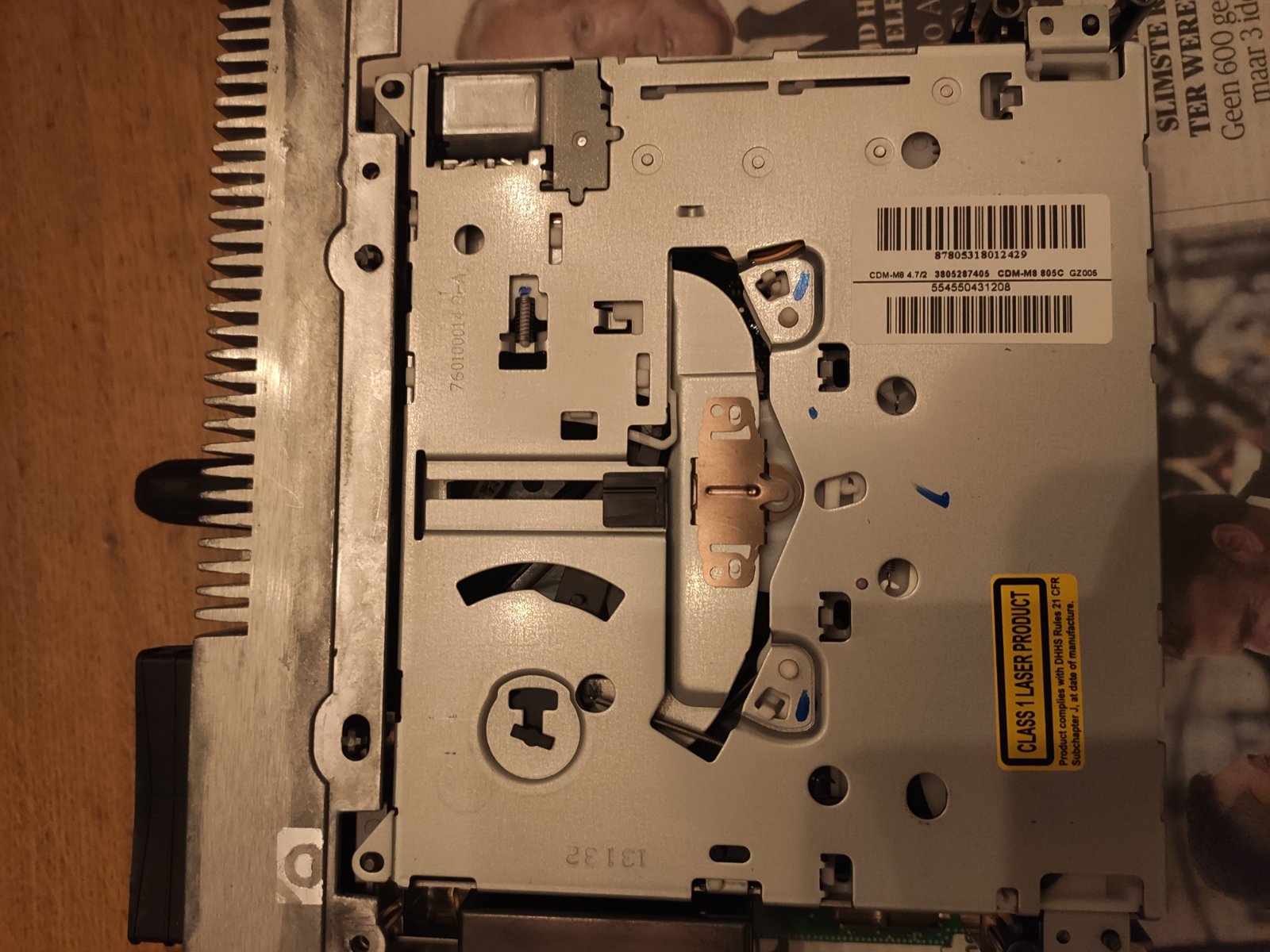

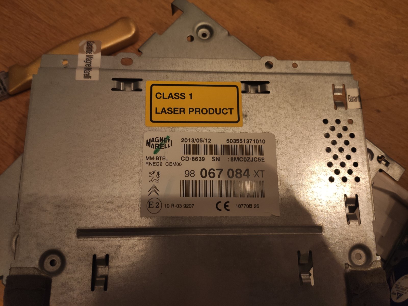

If the RT6 has never been updated then the version installed at the factory may be written on the label stuck on to the case.
lucho65
- Posts: 13
- Joined: 16 Aug 2023, 10:01
Re: Looking for a safe version firmware
I don't see the version on the unit.
Any idea what would be a good version to use?
- Posts: 9365
- x 1938
Sadly, you're right. I can't see it there either. I did say "maybe"!
