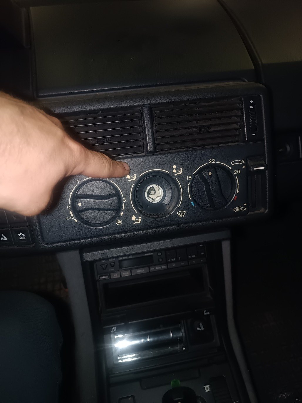

Hallo all! I have a 1993 XM 2,1td Y3 that needs a heater control panel swap and I wonder if someone who know how this should be done can point me in the right direction as of how it shall be done?
I have another complete unit that is going in, but I am afraid to break an awful lot of plastic if I go 'all in' without knowing how it shall be done.
Any relevant replies are most welcome!!! Thanks :-)

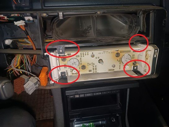

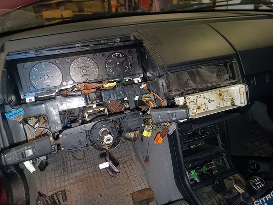

On my car, it was unfortunately quite different from this; I have removed quite a bit and it now looks like this:
The question is what to do with these 3 (was 4, but they become 3 before my time) plastic angles... I can cut them off and glue them on later, but I do not want to... Is it very much job and time consuming to lift off the whole panel? What would you have done and why?
