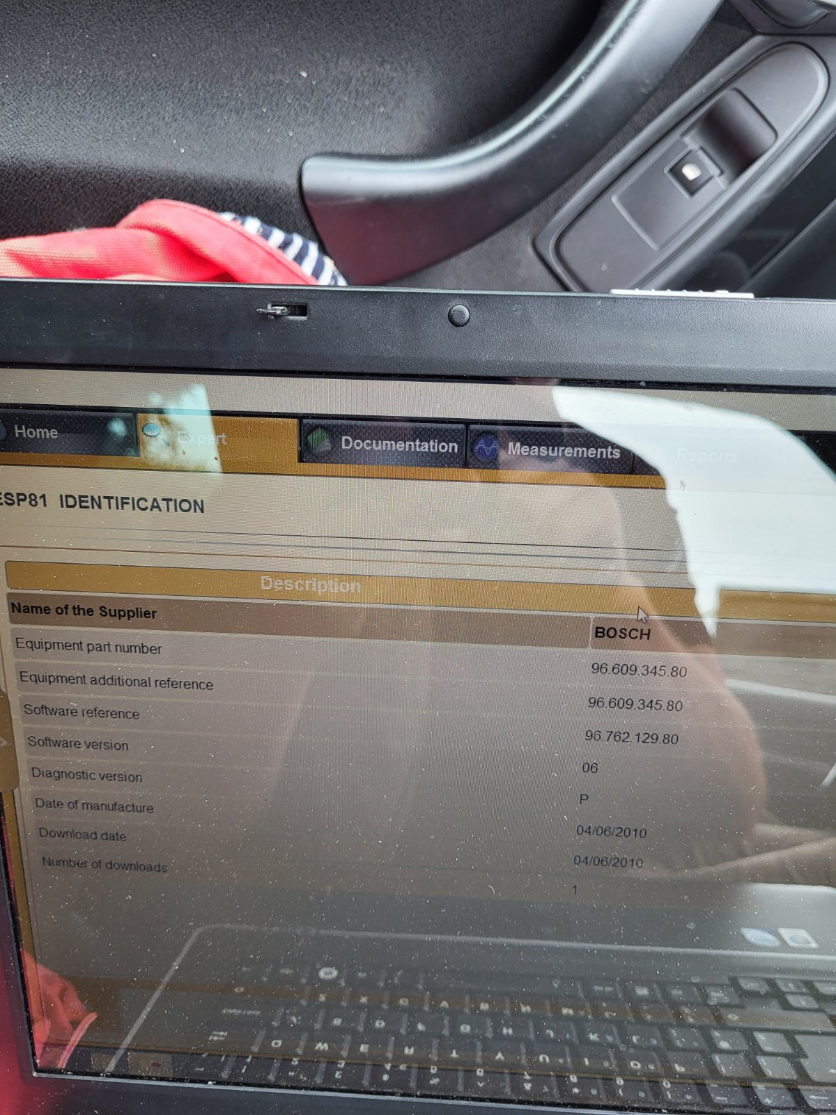

Will be changing my abs ecu in near future as still can't clear p1391 fault , have the the number off diagbox,for pump unit, but ecu software reference module doesn't bring up anything, can find loads of pumps with right number but they are mostly earlier models and mine is post 2010 as seen on screenshot, is there a part number for my control module, or do I need to remove mine and look for stamped number on module

Re: 2012 c4 picasso 1.6hdi abs ecu swop
I do not know for sure but I suspect you'll need to look on your own module to get the right info.
