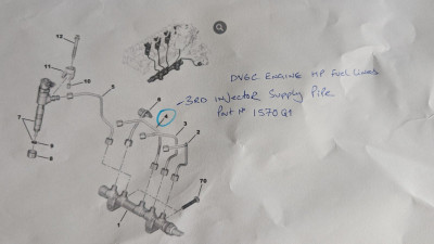

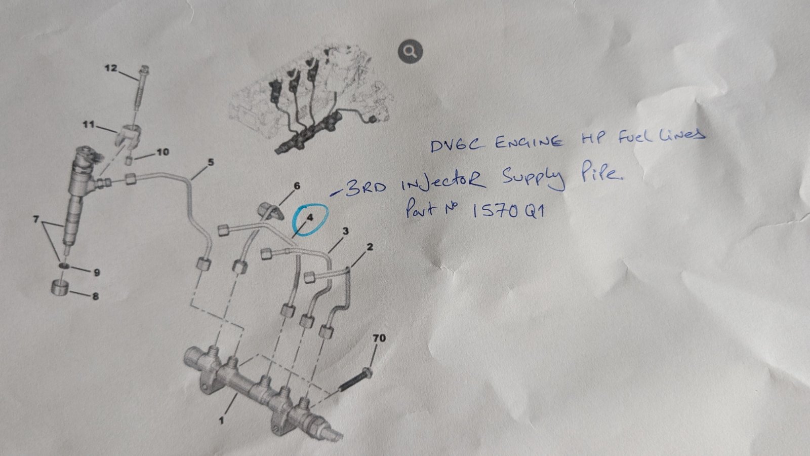

So now I have a new OEM pipe (£14 ) to fit but the other end (17mm flare nut)!I can't get to. Can see it with a mirror, tried a crows foot but can't quite get it on the nut as the area is so tight especially with the adjacent pipe for injector 2.
I've ordered a Sealy tools ak6900 special tool which looks like it will do the job tomorrow fingers crossed.

Thanks again, yes had same thoughts of alignment for fitting new pipe and checking the fitting on the injector. Inspected the old pipe once off and all I could see was a hardly noticeable scratch on the cone. I was so careful on disassembly the 1st time as well anyway it seems dry now with new pipe on. Jesus was that pipe at the other end difficult. Good job I hadn't assumed the other end was the same size nut as well ( it's 17mm at the manifold) but at least the engineering means you can't try and fit the pipe the wrong way round. The tool I bought just about worked with little room to twist. Whilst unscrewing I was thinking to myself, how am I ever going to get the thread started on the new pipe, I can't see it without a mirror, can barely touch it with a single finger !!!. Well somehow I obviously managed it but you would think if PSA decided these pipes were one time use, the access would be better.

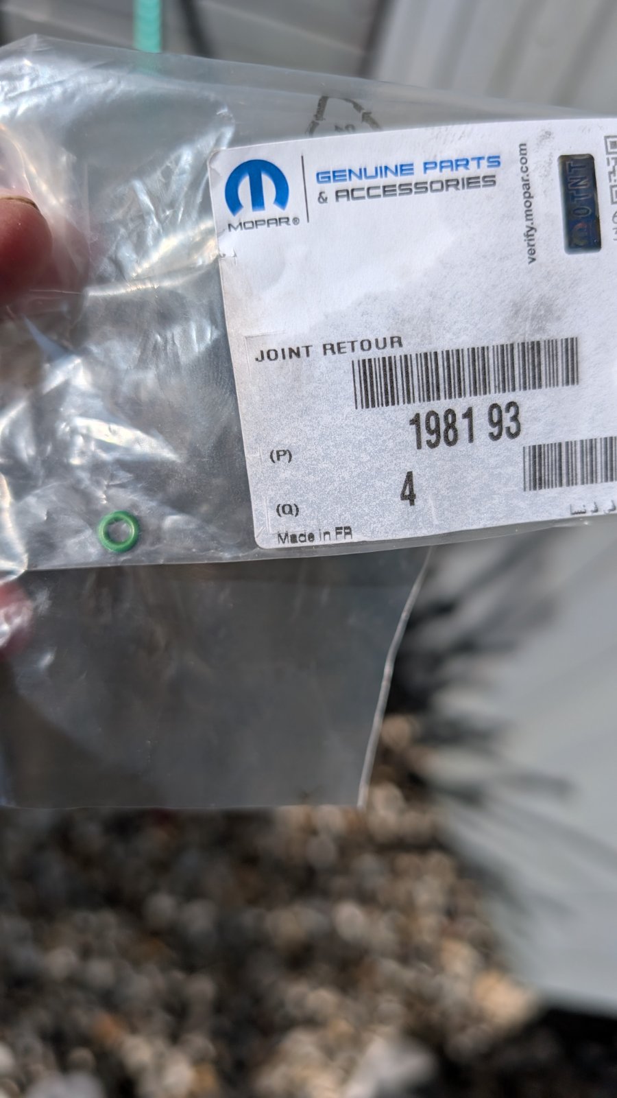

Well, would you believe it, been out for an extended drive this afternoon and whilst I expected a little diesel smell in the cabin ( because of my previously leaking HP pipe) the smell was getting worse and worse. And now I've spotted the spill / return pipe fitting on injector 2 is dribbling from the connection onto the injector. ( Spill pipe must have been off 3 times and it will be the original). I'll try fitting the "O" ring off of the old injector and it still leaks I'll get the whole thing. ( Does a new pipe assembly come with new "O" rings or are they a separate purchase?)
Also, if I just need a set of O rings, can someone advise the OEM part No. Pls. Thanks

Update, for anyone interested. I have now replaced the spill off pipework and got the little o rings x4 as well. £ 135 from Citroen ( because I wanted them asap).
O ring part No. In pic.
