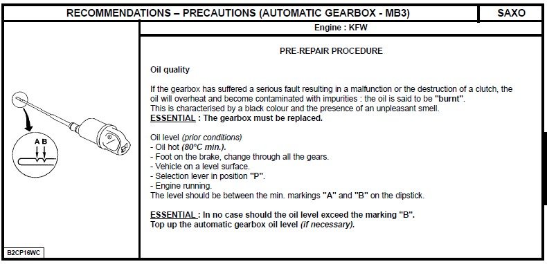

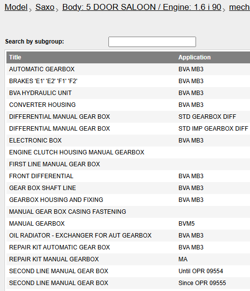

1.6 gearboxes....take your pick....if it helps

Re: Saxo 1.6 Automatic Gearbox Type?
Thanks Alasdair, that's appreciated :) I thought it might be an MB but in my current fuzzy state I just couldn't think what its designation was... That's actually a Renault 'box and also used in the 106...
Seems it needs Dexron III and is electronic.

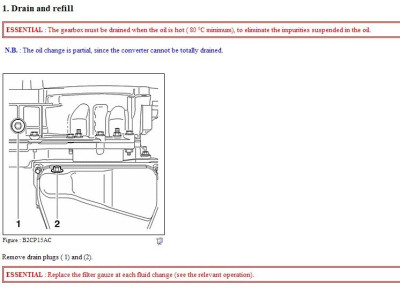

Unread post by wheeler »

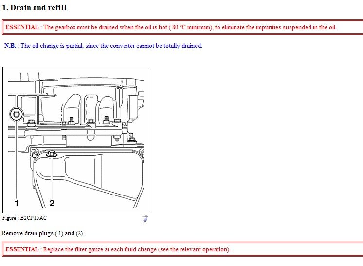

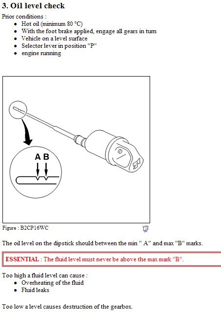

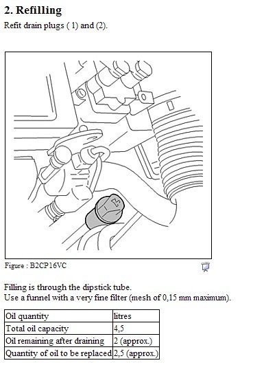

As far as im aware the only auto box he Saxo ever used was the MB3
Takes Total ATX which is the same as Dexron 3
Nothing fancy needed with Lexia.
Unread post by citroenesque »

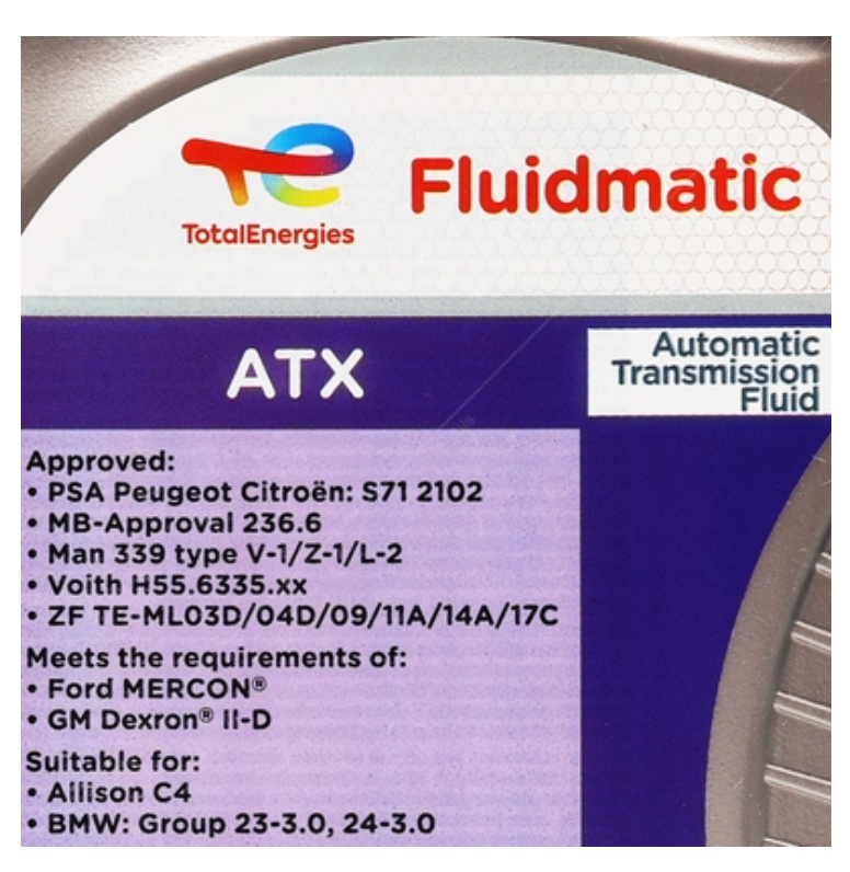

Hi there,
Very helpful, thanks guys!
However, I must point out the Total Fluide ATX (or as it's branded now "TotalEnergies Fluidmatic ATX Automatic Transmission Fluid") is actually specified as Dextron II D.
This is backed up by further research re: the MB3 'box, with PSA listing "PSA Peugeot Citroën: S71 2102"
