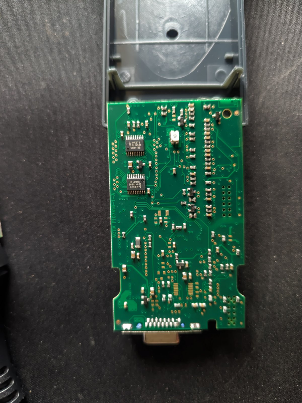

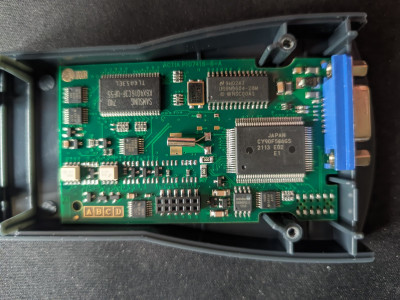

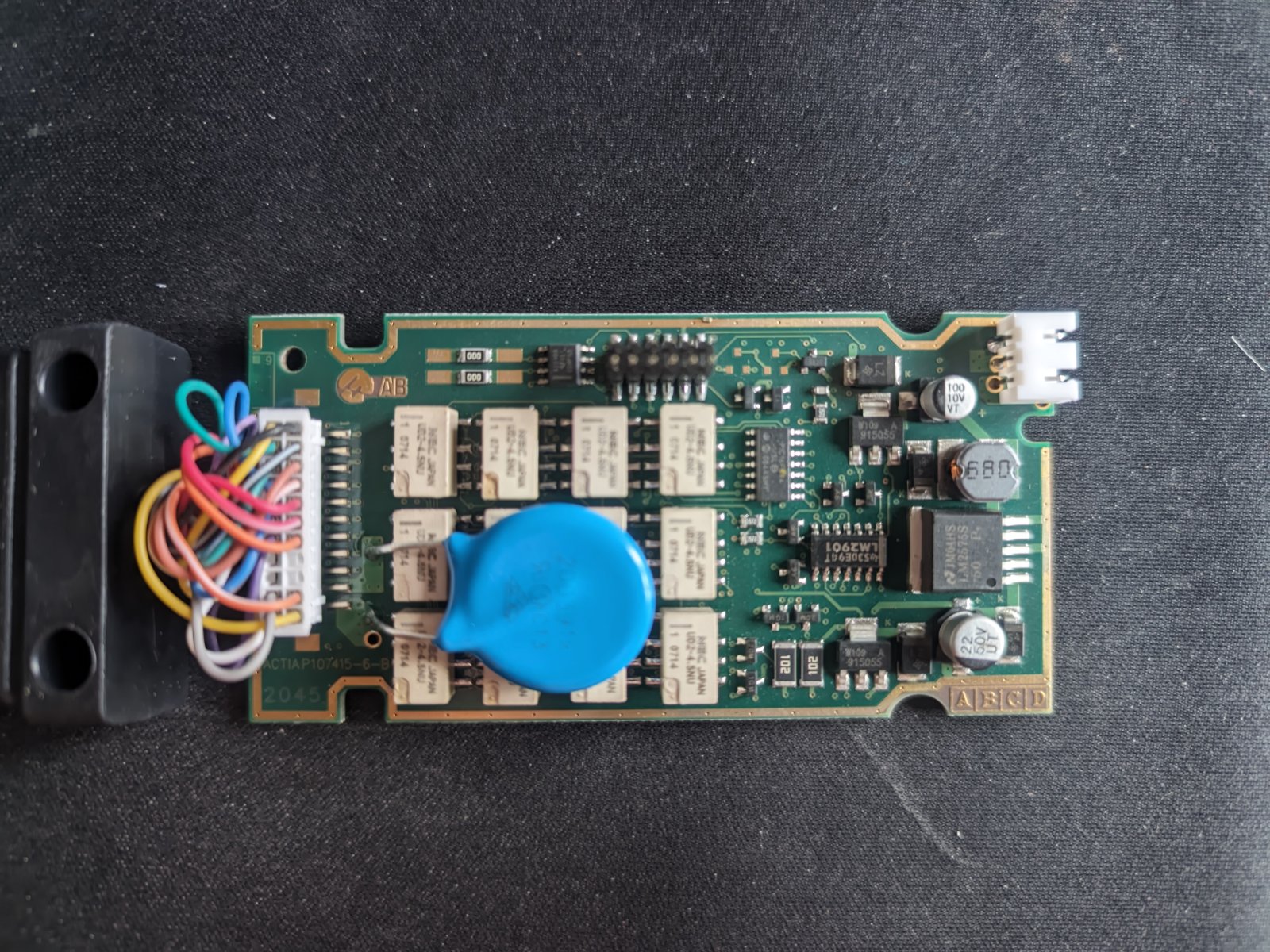

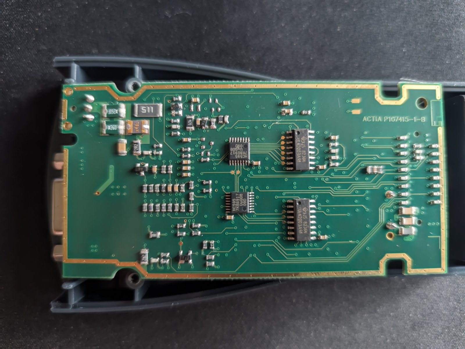

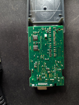

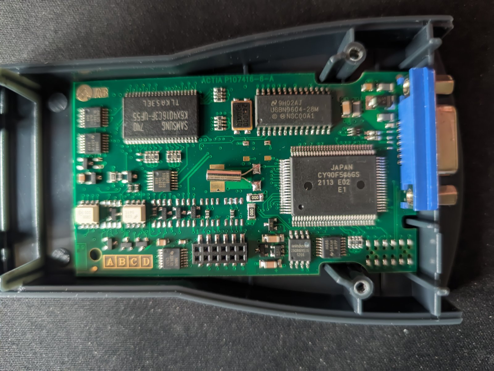

Fwiw here's the insides of my cable. Sorry about the weird focus
