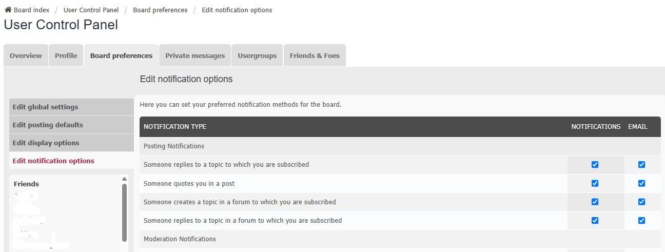

You need to go into your User Control Panel from the drop down at the top right of your screen. Then select the Board Preferences tab and go into Edit Notifications and set them up as you want.
Click on the image to enlarge:
