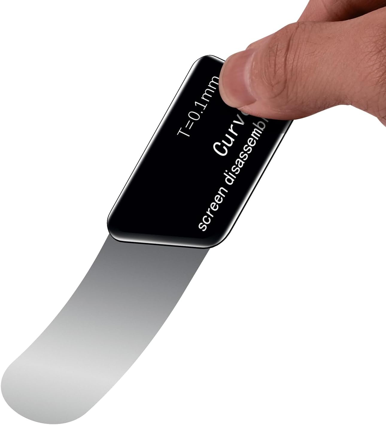

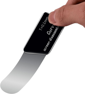

Sloppysod wrote: 25 Jul 2025, 16:35 I used a thin paint scraper to push in the joint to separate the joint.
BigClive uses a tool he calls a "Spudger" that would be applicable:-
Similar to this.
Amazon have zillions of them, all different and for different purposes, eBay too no doubt.
