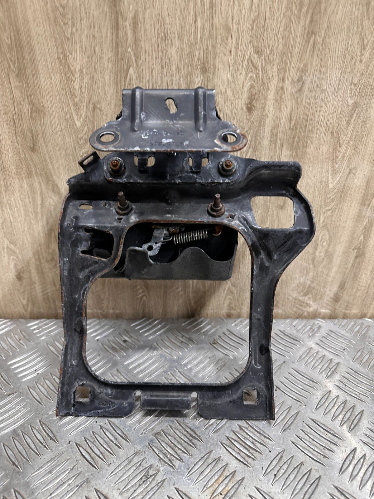

From what i can see on ebay listings of the actual latch, there might be away to get to the mechanism. but its very very tight in there and you cant see what you're doing.

This is the back access, so if youre at the front of the vehicle facing the bonnet, this part would be the rear side of what you would be looking at.

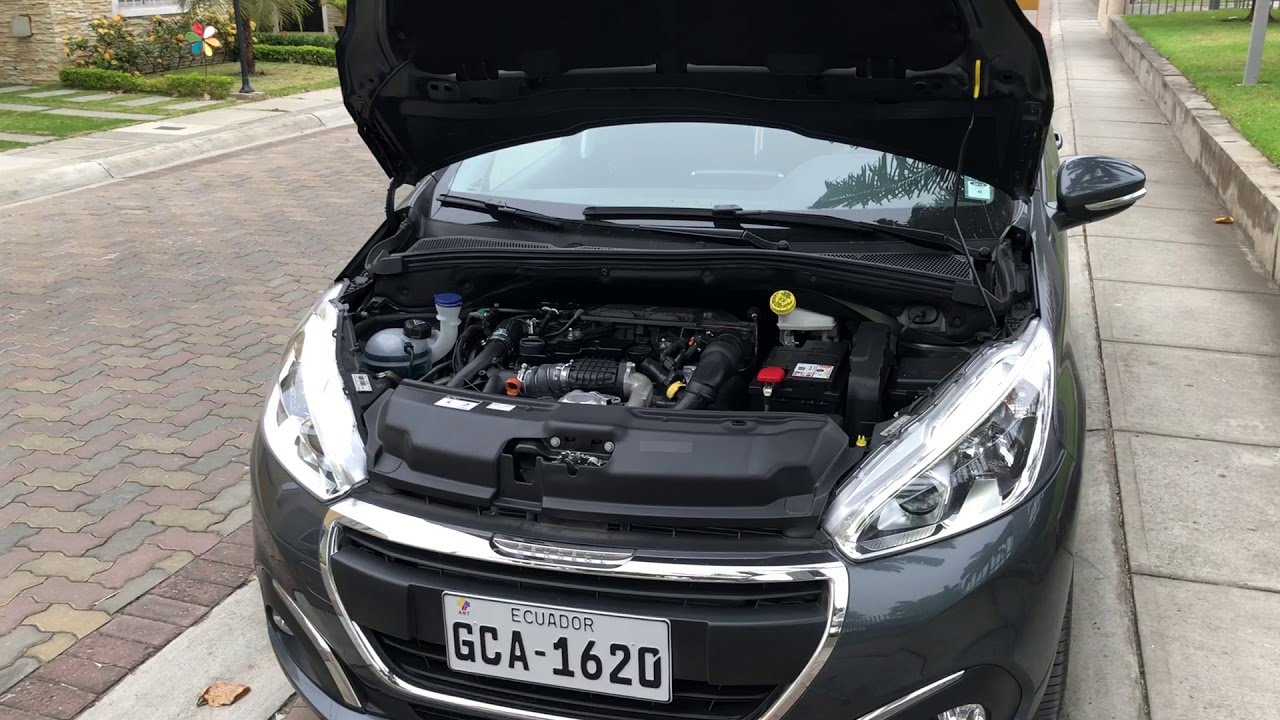

i really need a good image of the latch area with the bonnet open to understand where id need to cut and if that would make a difference.mickthemaverick wrote: 24 Jul 2025, 16:59 Can you get the grill off and then cut through the surrounding plastic rather than cut the bonnet?![]()
My understanding is that part is attached to the front bumper

How about this:
and this video may also show you some more of what is involved:

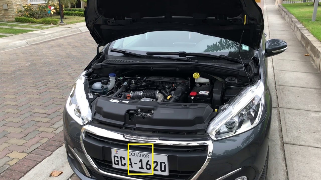

So the bit i need to cut, is hidden behind the bonnet when its closed....

I think I would take off the chrome surround, probably prises off with a plastic trim tool, remove the number plate and then cut into the grill, if you can't get it off because the top fixings are under the lip of the bonnet, roughly as I've drawn on the picture. Then you should be able to get a hook up onto the release lever and pull it open.
If you cut it carefully you may even be able to glue it back together afterwards as the number plate will hide most of the join.
