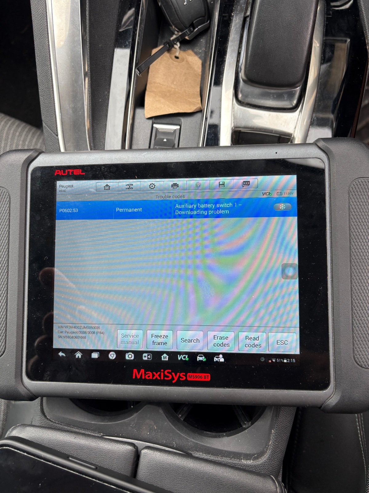

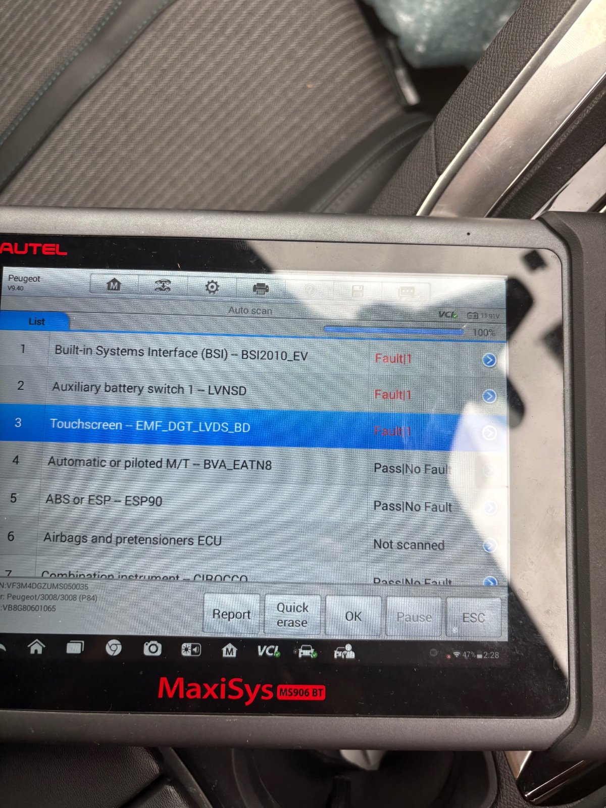

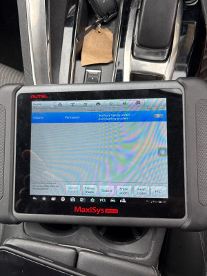

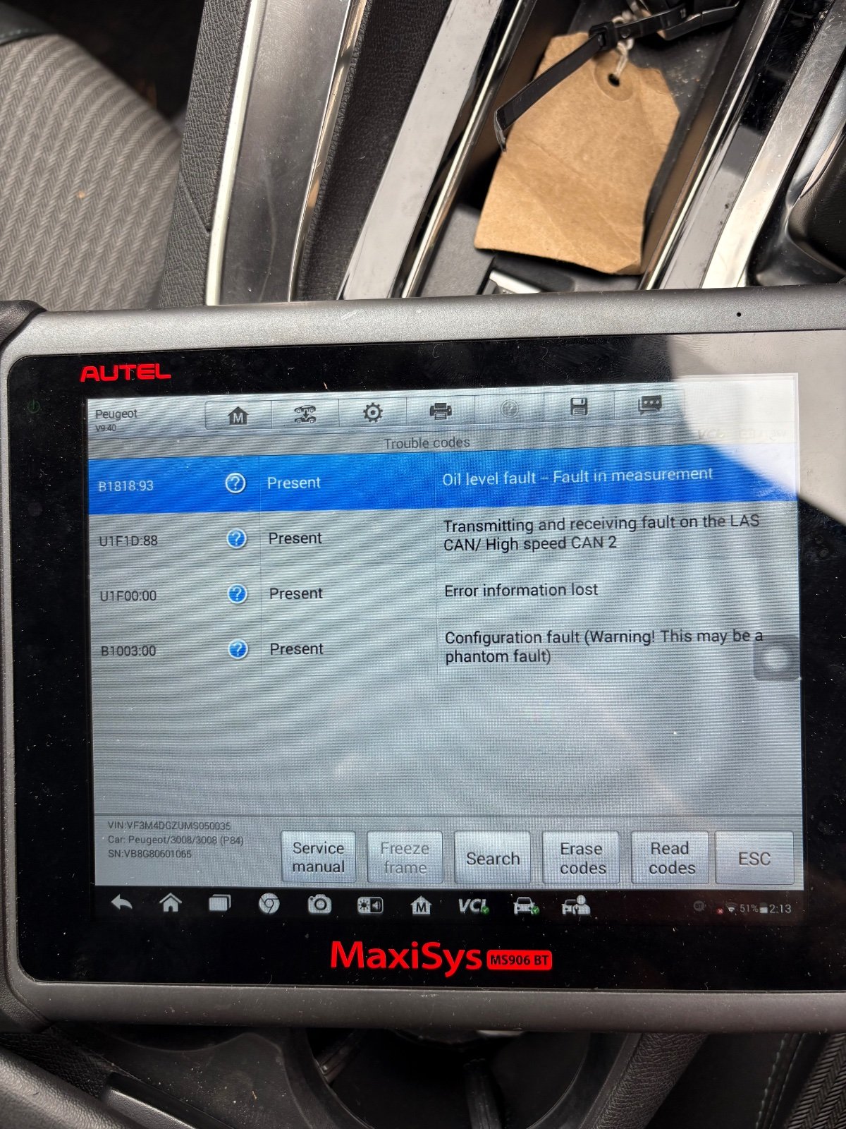

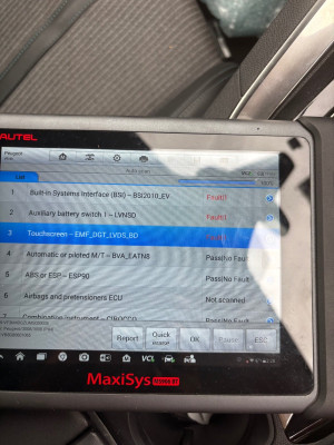

Hello my Peugeot does not start i ran diagnostic and i get these faults could someone explain be what could be the problems and how to fix it please 🙏

I would suggest you clear the faults recorded, carry out a BSi reset according to the link below and then rescan if the car still doesn't start:
viewtopic.php?p=601679#p601679

Right I bought this car of copart and the car did not start.we changed engine ECU as there was a problem and changed battery as it was dead but we have not changed auxiliary battery could that help if we do ? As one of the Faults show auxiliary battery switch .
