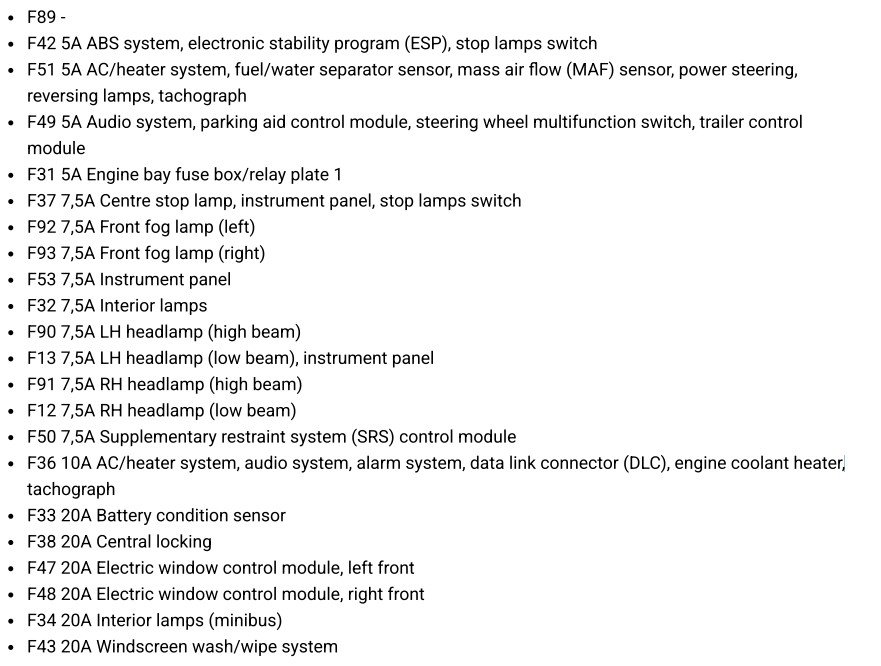

Hopefully this should be some help.

wheeler wrote: 13 Jul 2025, 16:20 Hopefully this should be some help.
Many thanks,
I will check soon if is correct!
Anytime i need wire identifier, today for searching hazzard button wire i've lost 2 hours. And another hour for finding where previous owner has connected the led bar on the roof and i'm not sure if is connected under low or high beams fuse.
