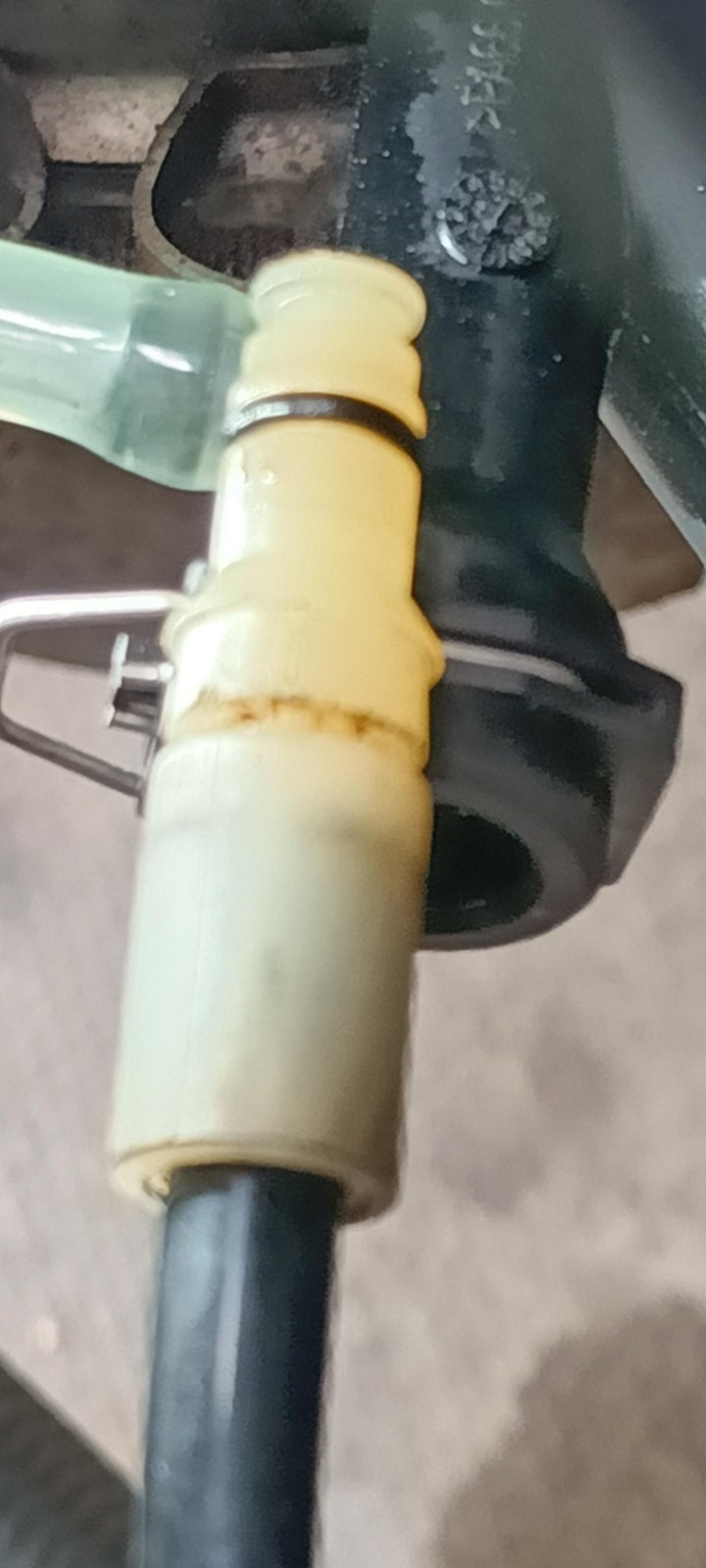

Does anyone know what size the o-rings are on the end of the clutch line feeding into the slave cylinder please?
The o-rings I put on weeks ago have corroded (yep they're nitrile, which I now know should be EPDM 70). Citroen today quoted me £70+VAT for the entire line, as they don't sell just the o-rings so they "don't know" what spec they are. Uh huh.
I've tried measuring the ones I took off, but they're so gnarly I can't get a proper reading, and my calipers don't fit into the groove of the line end where the rings sit.

I found an EPDM o-ring supplier on eBay that sent me what I think is the right size:
6mm ID x 1.5mm
Still yet to test on the road but while it's on the driveway having new lower arms, ball joints, driveshaft and a subframe ext joint bush moulded it's not leaking out!
6mm ID x 1.5mm

Reporting back after nearly four months to say the EPDM o-rings are still intact, no leaks! For a few quid off ebay, the o-rings will save anyone having to buy and install an entire clutch line from Citroen

On mine the O ring on the bit going in to the slave cylinder was nicked and leaking, I bought my O rings off Simply Bearings, see pic, I bought two sizes because, as you say measuring them is difficult. The second ones fitted ok and now all is good!

Which is the size that you found fitted best?
