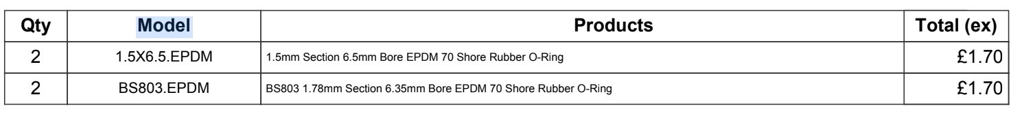

Re: EPDM o-rings for clutch line - sizes?
On mine the O ring on the bit going in to the slave cylinder was nicked and leaking, I bought my O rings off Simply Bearings, see pic, I bought two sizes because, as you say measuring them is difficult. The second ones fitted ok and now all is good!
Stu
Which is the size that you found fitted best?
