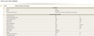

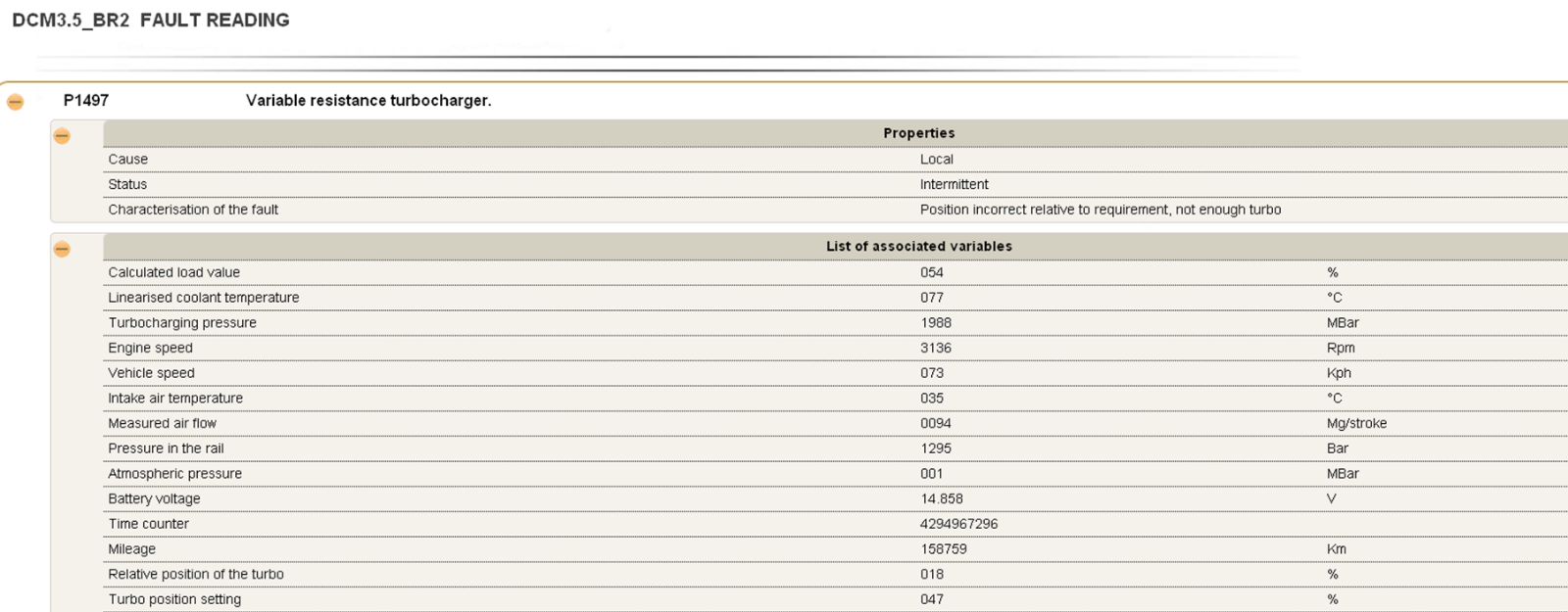

Code read indicates P0299, P1496, P1497 and U1218 on diagbox. Seems odd, that I can see a 1496 and 1497, as one is underboost and one overboost. Might that be indicating that the turbo vanes are stuck ? That sucks - its tucked away low down at the back of the 2 litre engine. Looks like I'll be trying to get it on the ramps and have a poke underneath someting soon. Simple fixes seem to point to electrovalves, but I can't find any on this engine ! Previosuoly on the 2 litre RHR they were either down below the alternator or over the back of the timing belt cover.

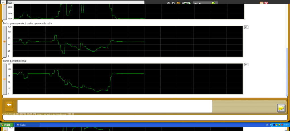

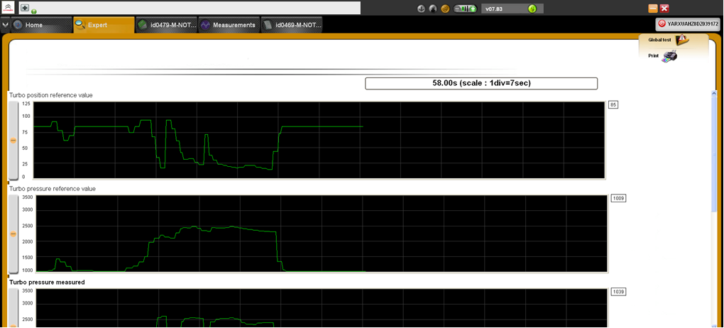

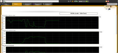

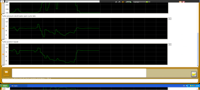

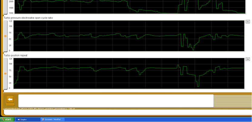

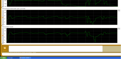

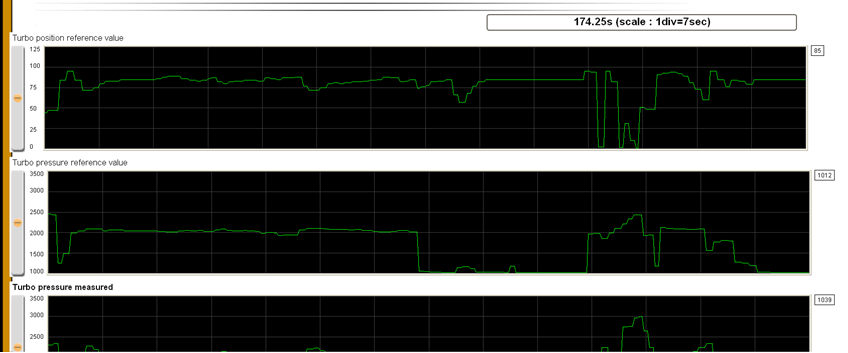

Right, even though its baking hot, I've had a little time to investigate. Heres traces after the fault was cleared, on a brief run up the road out of the village.
This all seems to make reasonable sense, and I think indicates the turbo vanes are moving when commanded ?
You might need to zoom in on the images to see the trace I'm afraid - sorry !

Re: 2.0 Hdi Mk3 Dispatch / Expert P0299, P1496, P1497 and U1218

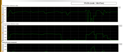

And then I tried another run, and the fault popped back up. It was at the last 1/3 of these traces I think. I can't quite understand why this is different ?

just having a think, and the turbo pressure signal in the traces i captured is from the MAP I think ? It seems to follow the reference reasonably ?

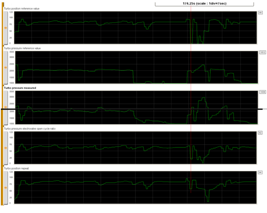

It looks to me like the turbo vanes might be sticky. Put the traces together and added a line where it looks to me the problem might be.
See the turbo position request drops right off, but repeat doesn't. and the boost pressure reference drops a bit, but the turbo pressure goes up. Did you stab the throttle and then lift off suddenly?

could have been a gear change. I stood hard on the throttle to get the largest changes on the traces.
perhaps a little too enthusiastic....
Interestingly, no fault codes stored, despite having a bing, and error messages on the screen with limp mode ! Quick pull over, key off, restart and it was fine again. Its been fine for a few trips over the last two days totalling about 50 miles too. Bleedin' typical - we're off in it for a campervan trip to northern Germany and Denmark in a few weeks, so I'd like to find something that is the cause !

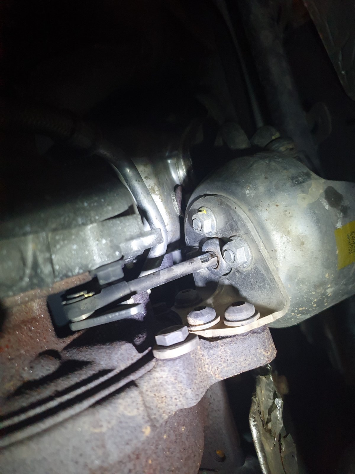

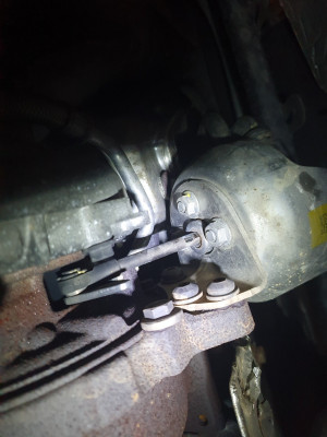

I've had a chance to get underneath and take a look now. The turbo actuator moves smoothly through its stroke, although its quite a shove to get it all the way. Theres a bit of a wierd mark on the actuator shaft where it comes out of the diaphragm chamber, but nothing too crazy.
