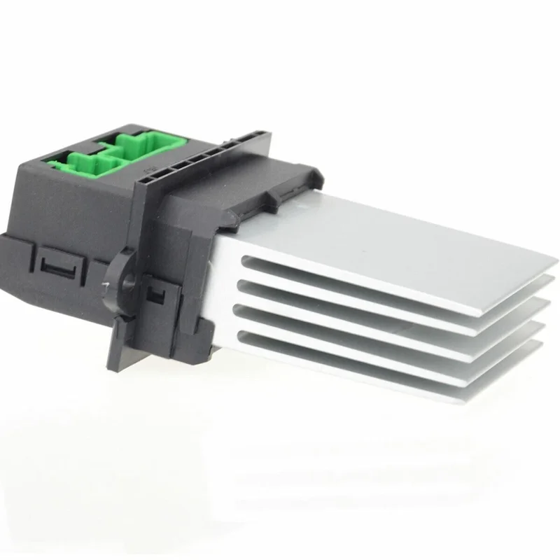

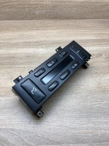

After the auto electrician repaired the cabin blower fan in my D9 1999 406 a few months ago, I noticed that the heated rear window was turning off almost immediately after being turned on. He replaced two parts as pictured below, plus he did some repairs to wiring.

And the news is that the timer is built into the control panel.
That part was ordered and fitted because the auto electrician couldn't get a clean signal from my non-functioning fan speed resistor to the control panel that was at that time fitted to my car. He said today that he asked me to source that part rather than get just the resistor, fit it, and then discover that there was a problem with the control panel as well. If there had been such a problem, it would have caused further delay. I understand his logic and appreciate what he did.
When all of his other testing and tracing wires and checking voltages etc didn't reveal the timer, he concluded that the timer must be in the control panel. And of course, he wanted to know if I still had my original part. Thankfully, I did, but not with me. It was at home, some 60 kilometres each way from his workshop! And with the 'delightful' weather today, that trip was over an hour each way, instead of the usual just under 40 minutes. The rain wasn't quite torrential, but combined with the wind, and trees being blown over, it was a hazardous journey, to say the least!
Anyway, once he had my original part fitted, the rear window demister turned on - and stayed on! And on the drive home, it duly turned itself off after about 15 minutes, just as it should have done.
