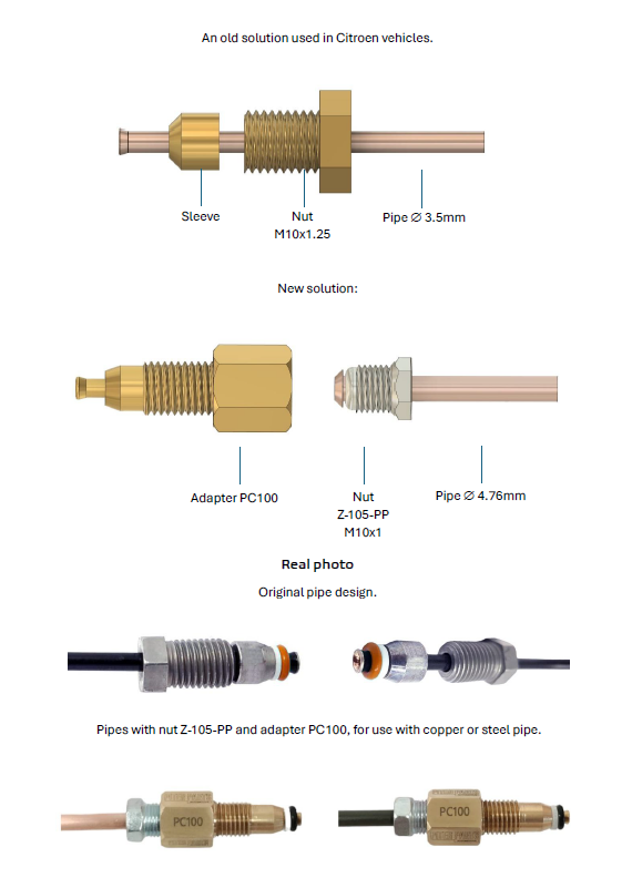

Hi,
If anyone needs to repair or replace this in a similar way but doesn't have access to tools or the necessary skills, I recommend these solutions:
https://piterparts.online/redukcja-prze ... p-722.html

AJ_Artur wrote: 15 Jan 2026, 12:44 Hi,
That was my original plan but be warned will not ship to UK or IE. Otherwise that would have been my perfect solution
