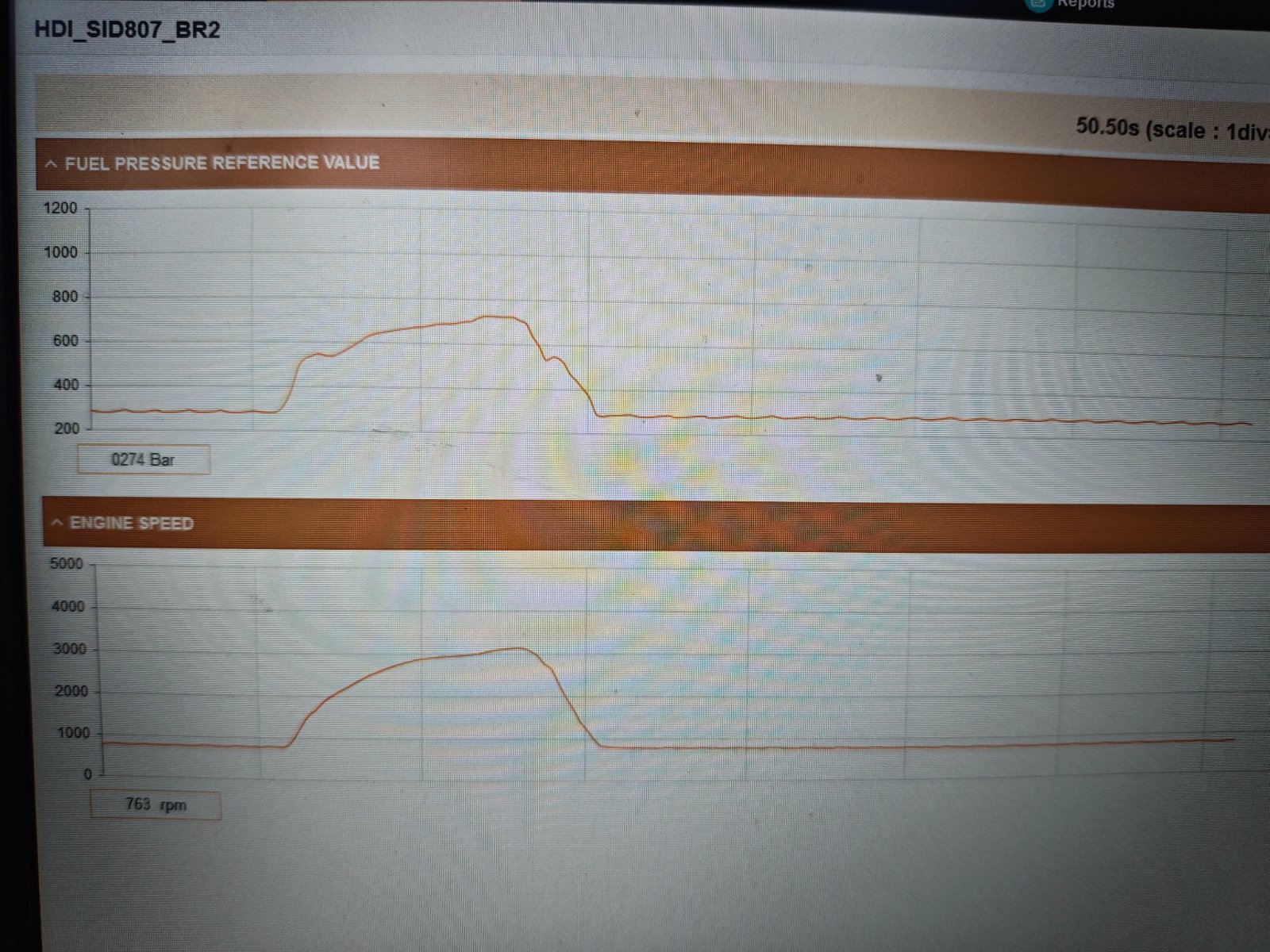

This is the pump and rpm.
I think the pressure is too low. the pressure is 700 bar on 3000 rpm.
I checked my car. There was Peugeot 308 similar engine. 1.6 blue hdi.
The pressure was 950-1000 bar
The idle speed was 764 rpm and the pressure was 273 bar
Peugeot 308
810 rpm 392 bar

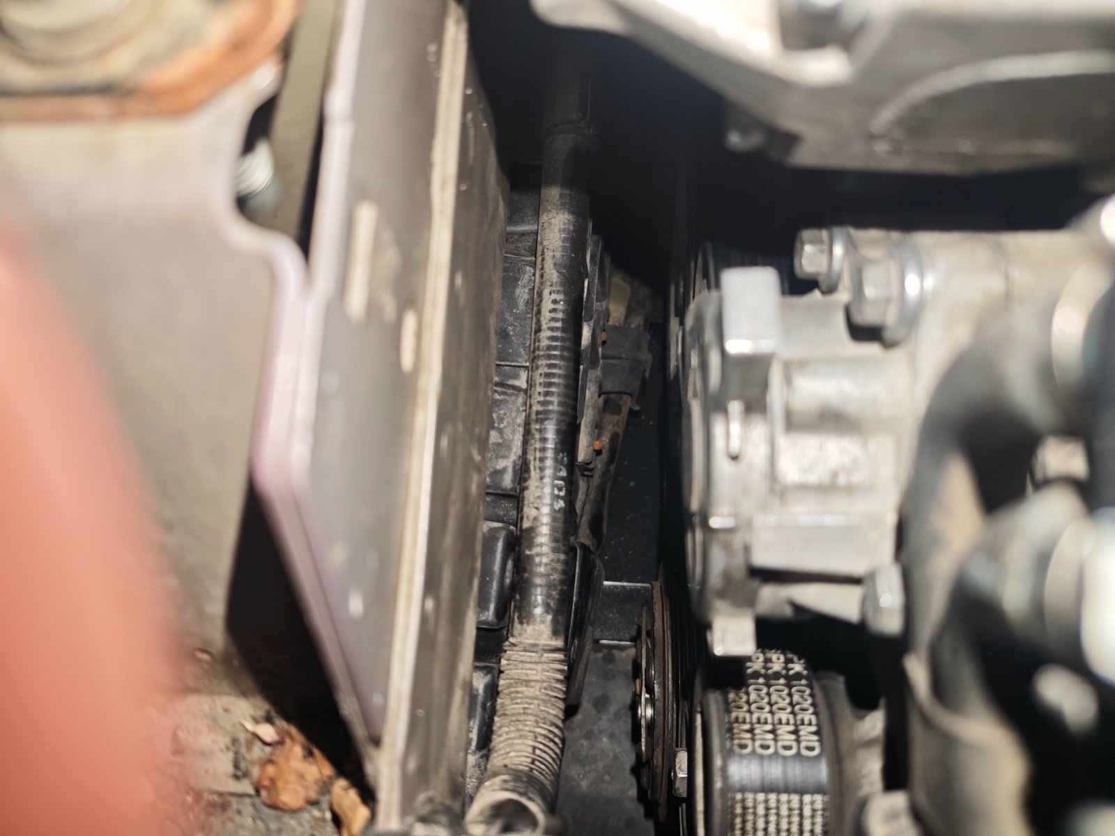

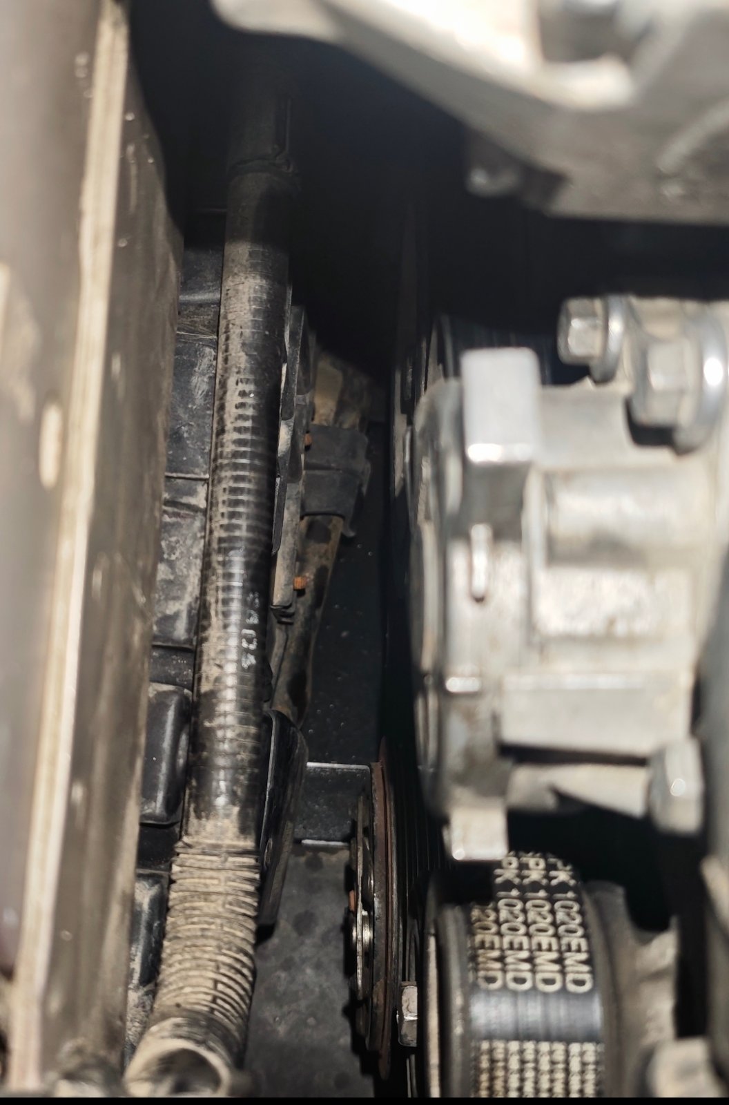

I found some gasoil on the floor panel
kalm007
Posts: 63
Joined: 25 Oct 2023, 21:14
x 1
Re: P2291 P1199 P0087 error code
Unread post by kalm007 »
I heard some noise when I moved the gasoil filter cap. I checked it and the gasoil came out from the bottom of filter. I looked at the floor and I saw lot of gasoil on the floor again. I pumped the filter again. When the filter was fullfield. I moved the middle part on the filter cap and all gasoil came out again from the bottom of filter. Is this cause my problem?

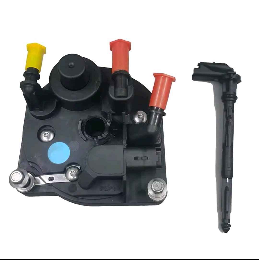

This is the product number. 9809757980
When I moved the right part a little bit. All gasoil go out from bottom of filter onto the floor plate.
PaulC5
Posts: 2718
Joined: 06 Jun 2023, 15:26
x 705
Unread post by PaulC5 »
The part on the right is a drain plug so moving it will drain the filter. I can not tell though how it is held tight so it does not leak. Was the old filter the same ?

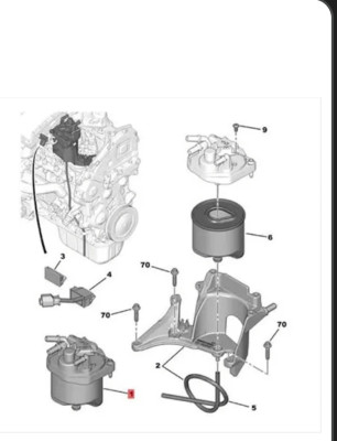

kalm007
Posts: 63
x 1

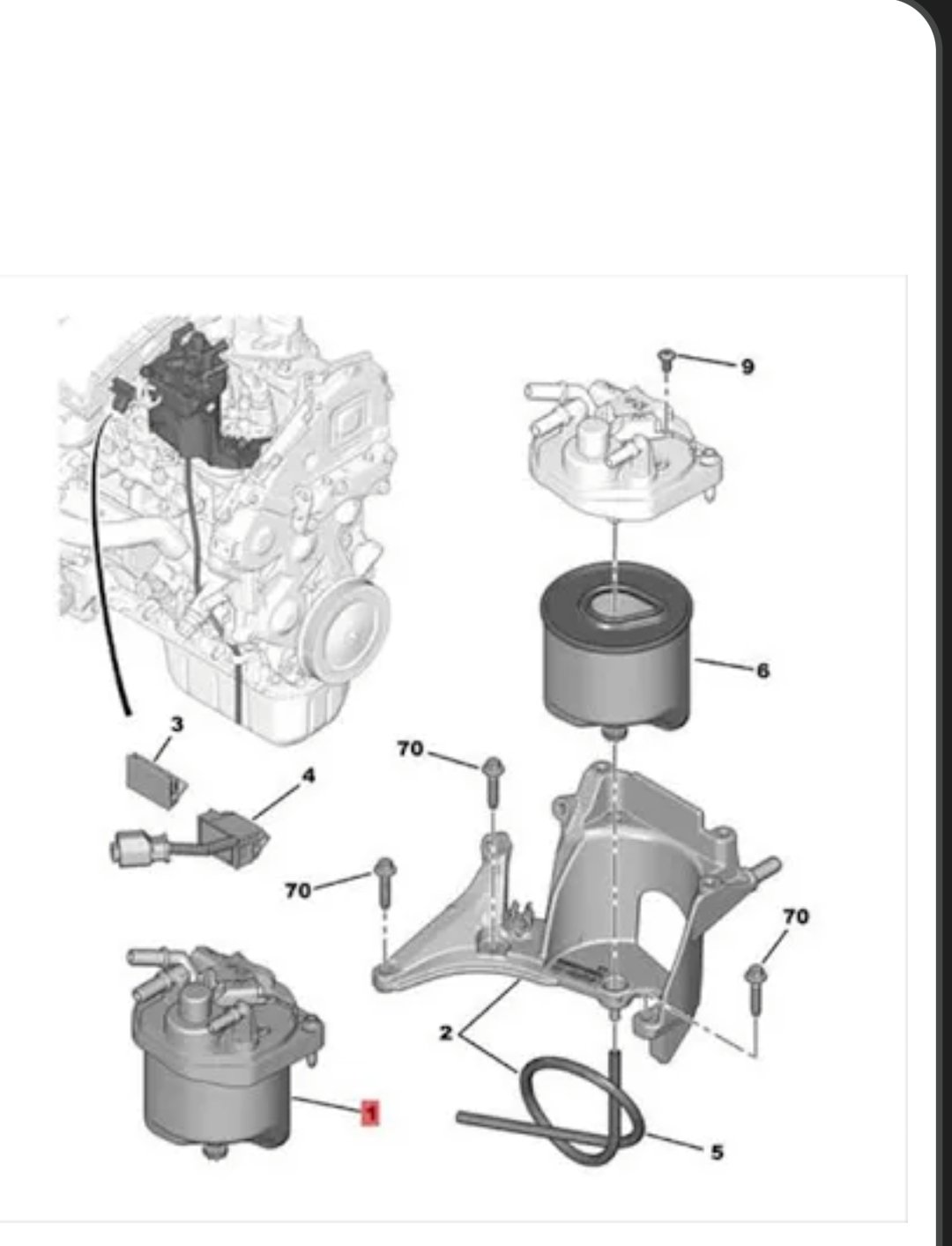

Top part is same. I replaced the bottom part.
number 6 is the filter

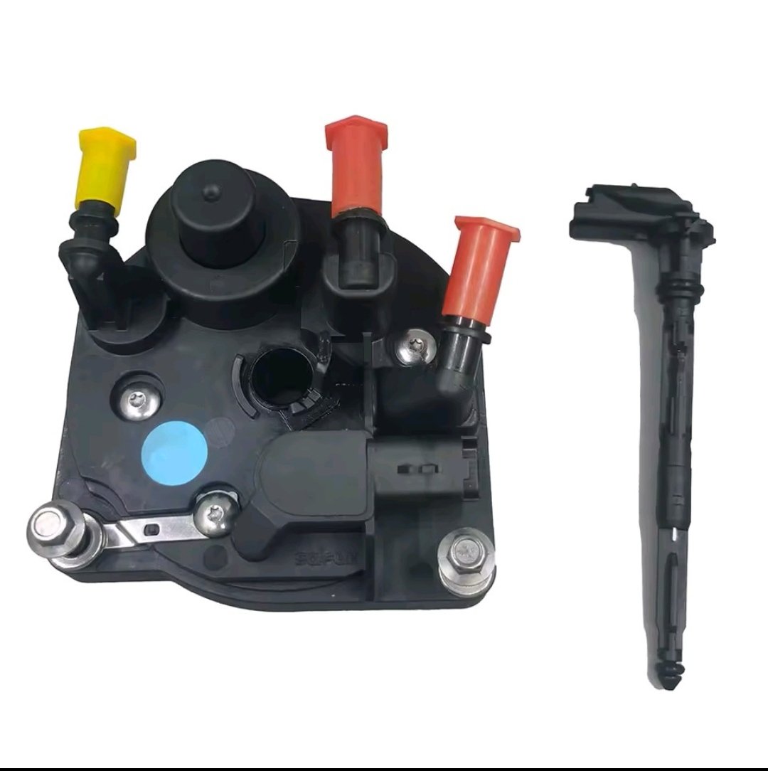

On the right side part I can move up and down a little bit. I have to check it. But my car is 13 years old and I did not have a same problem. But when i move left and right side. The gasoil go out from filter.
