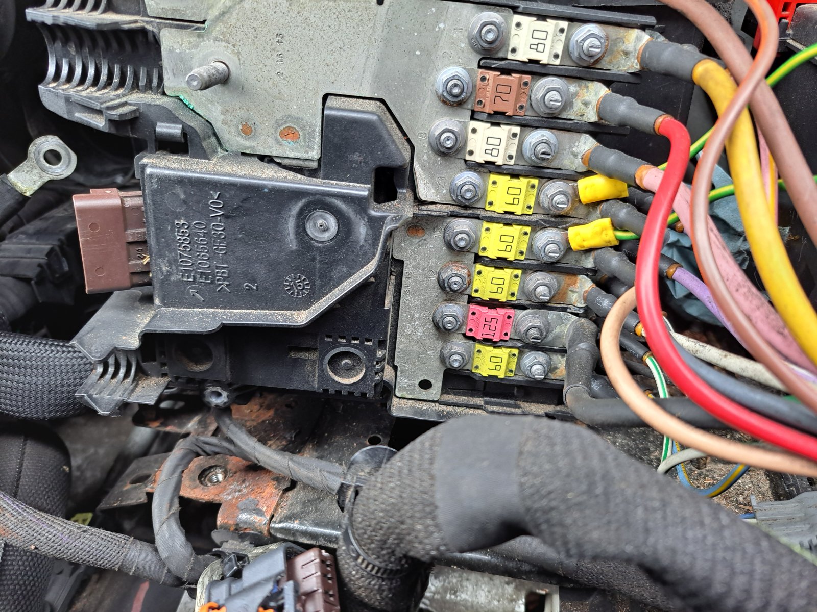

Hi All . .again . . .
I decided to bite the bullet and buy a 'New' BPGA 'JL01' unit from eBay . . . (Needed the 'JL01' due to the 'Stop/Start' feature . . )
It arrived from the seller in a tatty cardboard box! . .Not a manufacturers box . ?? . . Also, there were no screws that should secure the covering panels . .??
I fitted it, but all hell let loose . . Electrical warnings! . . Indicators flashing fast with a warning! . . . SERVICE light 'ON', etc. . . . .
But at least the wing mirrors opened on unlocking and the engine started. But i decided to remove it and put back my original.
(I sent the 'New' unit back and got my money back via eBay . . .The seller tried to pay only half . . stating that I had damaged the 'New' unit, showing a slight blemish on one of the covers . . Luckily, I had a picture of the original eBay listing and zoomed in to the blemish that was already there . . !!!!! . . I wonder if they have tried this before . . .??!!. . .

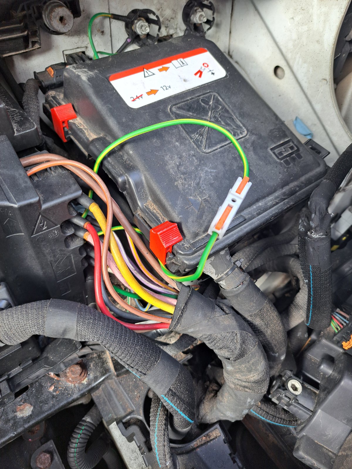

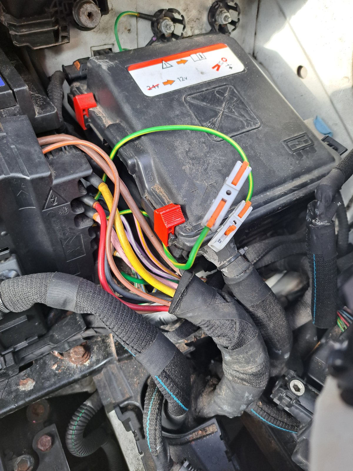

During replacement, I fitted 2 cables to the central 80A and 60A wiring connectors fitted with quick connectors, so that if I had the totally dead car . . i.e. Doros would unlock, but no 'Start' button functions and the car not starting . . At least I could join the 2 cables, the wing mirrors would come out and be able to start the car. . . Eureka!
I then proceeded to complete a few procedures . . .
-Using the OBD Diagnostic Unit . . Clear all the Error codes.
-Reset the 'Factory setting' information using the operation panel.
-Complete a BSI reset procedure.
Using the OBD Diagnostic Unit . . Clear all the Error codes again.
I then seperated my 'special ' connectors . . . Since then my car has been running fine. No dead car. . . .
Haven't had to use the special connectors since the above . . .So think the BPGA unit was OK after all . .
I will of course update should the issue arise again.

Re: C4 Grand Picasso Electrical Issues (Poss BPGA?)
Mornin' . . Had to use my 'Get out of jail free' card again this morning . . (Please see pictures ). . Doors unlocked, but, mirrors didn't open out, no 'Start' button functions at all, no window winders,etc.
Connected my 'special' BPGA wires and all working.
Cleared errors . . The 'Service' light was still on, but reset by turningvon the headlights+FOG LIGHTS . . This is what cleared the service light . . ??!!
Main thing is that this link gets me out of trouble . . Works for me . .

Hi Uncle Tom Cobley . . I did finally succumb to buying the BPGA unit of eBay . . Correct type 'JL01' for my Exclusive+.
Just swapped, then BSI reset and cleared errors. No programming.
I decided to change due to getting an error on my replaced 'Adblue' tank . . !! . . '700 mile' warning!!
After changing BPGA I did not need to reset the 'UREA' ECU . . It cleared after the replacement.
Do not forget to extract the small fuse(s) and fit them into your replacement BPGA unit.
The 2 wires that I fitted to my faulty BPGA were fitted between the middle 2 fuses on the front side fusesof the unit . . See attached picture
Hope this helps . .
