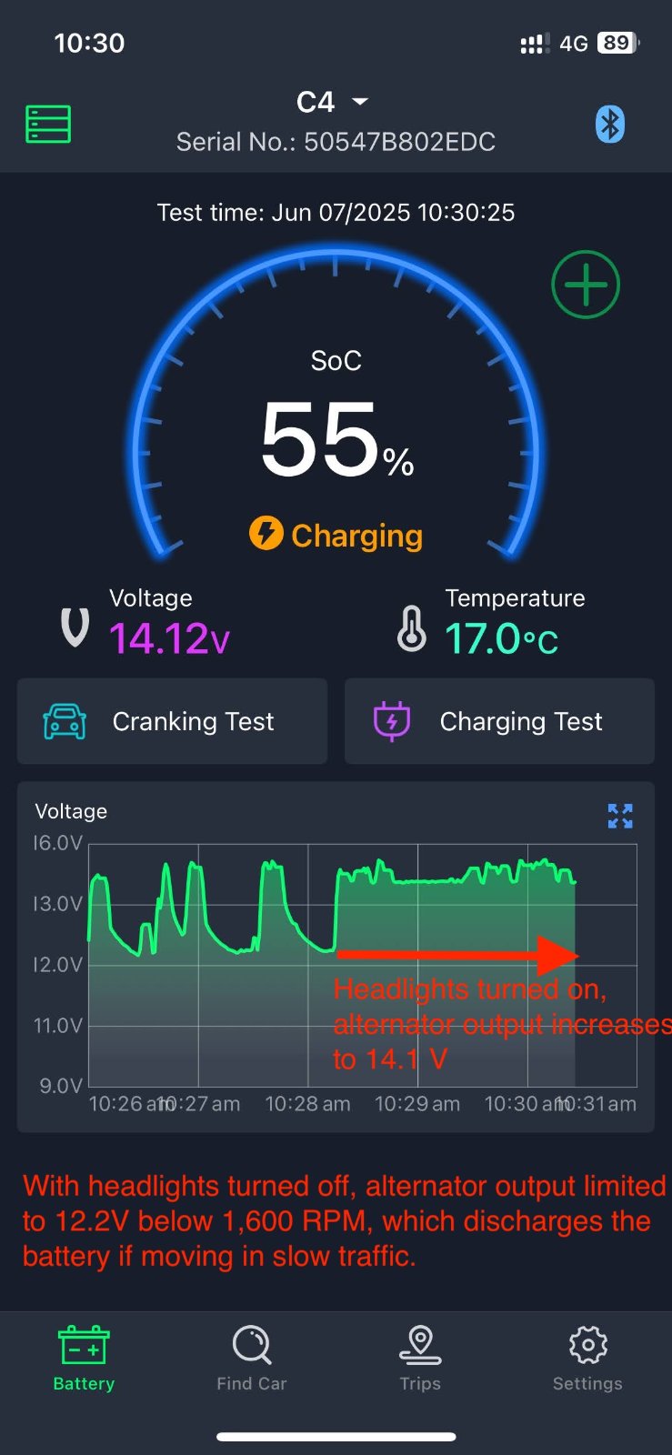

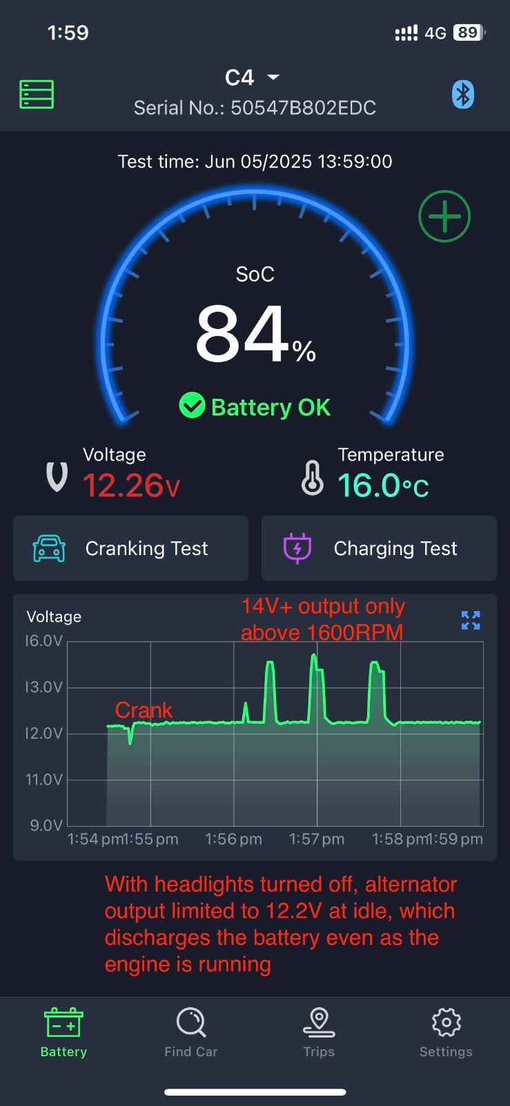

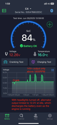

I promised to follow up with insight from the Sealey Vehicle Finder & Battery Monitor Sensor - BT2020, which cost £20 and was easy to fit on the battery terminals (negative can go on the ground point on the C4).
I discovered that the battery does not get charged above 12.25V unless driving above 1600 RPM or unless there is a large draw (headlights or rear de-mister). As soon as I turn on the headlights, the voltage jumps to 14V, regardless of RPM (i.e. this issue is not caused by the alternator belt being loose or the alternator brushes being worn).
The ECU behaviour is the same regardless of battery SoC and engine temperature.
See below.
The effect of this is that if you are driving around the city, each trip will just drain your battery.
I wonder if this is by design from Citroen? If it is by design, then it is a poor design. A diesel can go 20 MPH at 1600 RPM so for city driving, every trip just keeps discharging the battery.
Having said this, my S/S still doesn't work even with a full battery, so I will need to get a read out from the ECU on the cause for that. For reference, there is a section called "Start Stop information" in the ECU (https://scandoc.online/last/0/18/36/2?page=t3&ctrl=). Does anyone if generic code readers can access that data stream (I'm not sure I want to go the full Diagbox route just yet).
