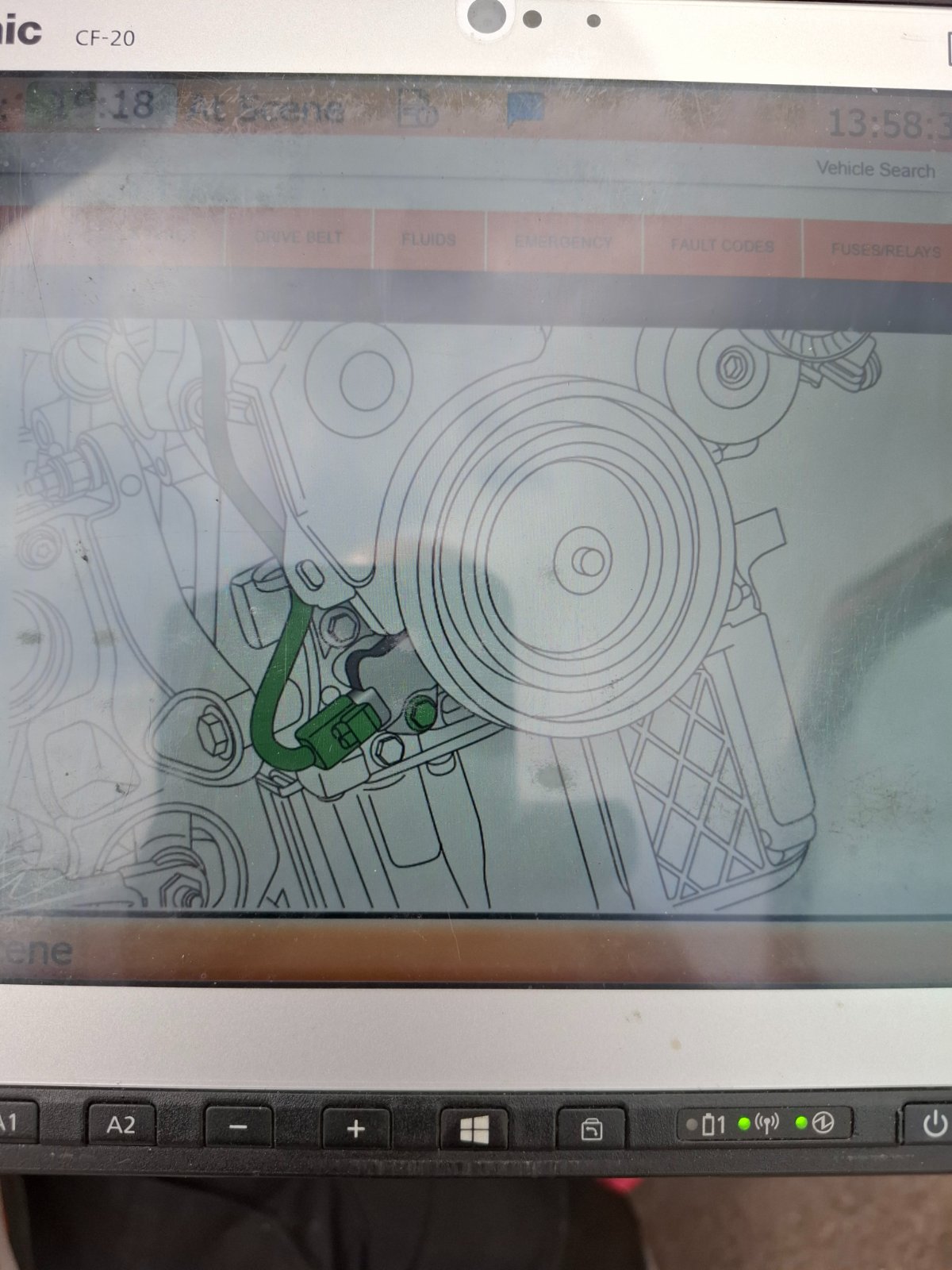

Stopped at traffic lights, engine cut out, would not restart! Much chaos in Gloucester due to me! A nice guy in a toyota towed me across and out of the way.
RAC guy said the engine speed was 0. He thinks its this sensor here
Engine speed sensor, is this also the crankshaft sensor? Im looking to buy one and fit it asap!!

It is but I didn't think they caused an engine to cut out, just not start.

moizeau wrote: 30 May 2025, 15:50 It is but I didn't think they caused an engine to cut out, just not start.
That's the camshaft sensor your thinking of.
If the ECU looses the signal from the crank sensor the engine will stop immediately.
Yes, that is the Crank/engine speed/TDC sensor in the picture.

What engine? Really need some diagnostics with live data to pin point the issue.

RichardW wrote: 30 May 2025, 16:18 What engine? Really need some diagnostics with live data to pin point the issue.
2.0l HDi.
RAC said crankshaft sensor, but he said it was the one he pointed out on the picture.
