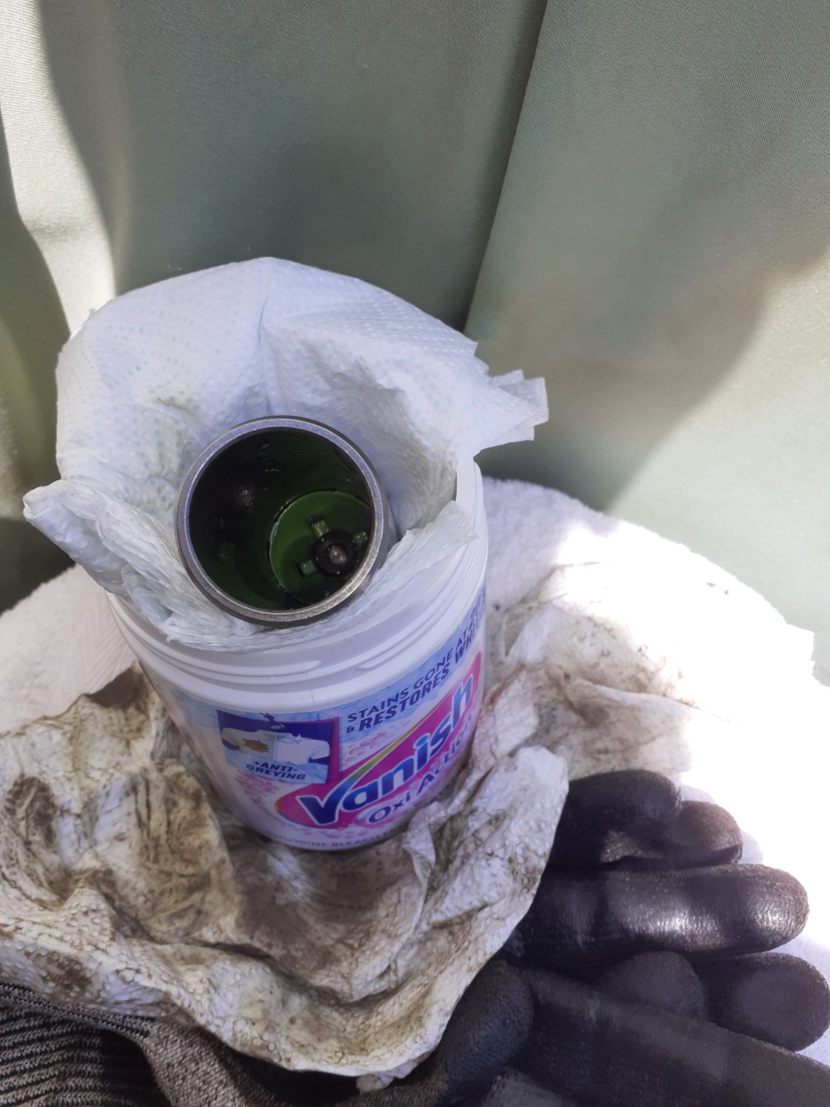

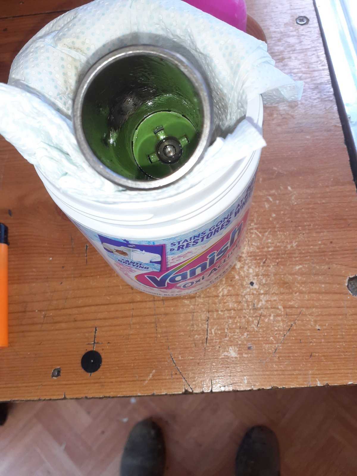

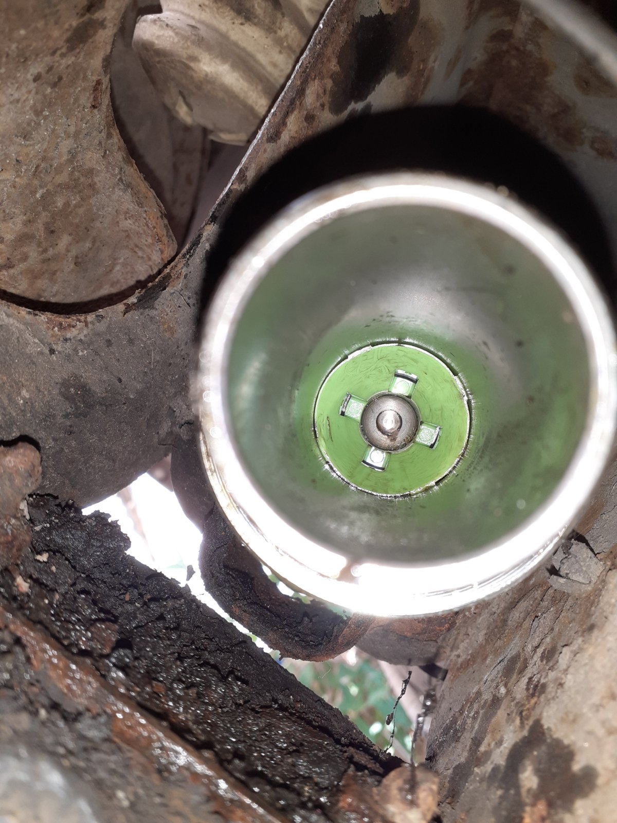

Hello All.
Changing the boots and seals on the rear rams,
Is that green washer/guide supposed to stay in position or move with the link arm.
Rgds Peter

Hiya, I'm sure that green thing is the locating bearing for the push rod. I don't think they are known to come out. Probably could remove it if you were keen. It shouldn't move as far as I know - I think the pushrod from the arm end moves within it.

Hello Graeme,
That was my thought but the book and the info on the forum doesn't actually say so I thought I'd check
Ask the Audience or Phone a friend :rofl2:
They are back on the car with new seals and boots now.

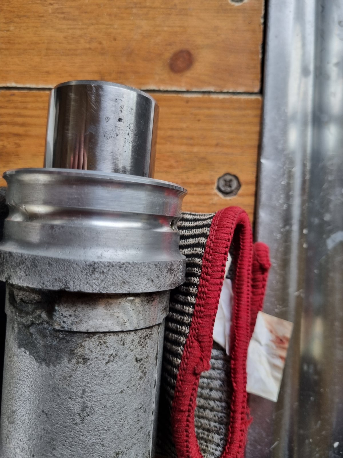

well I started it up. did some citrobics.
The stop and hydraulic lights kept coming on when i was going from low.
checked underneath and it's dripping from the where the boot goes over the ram, boot was mostly dry so I reckon it was a poorly sealed boot.
Took it off and while I was cleaning the rim (again) i noticed this on the ram, according to what i've read this could make the ram U/S.
little spots and feels rough around them. I've tried fine emery and metal polish, how far do you go.

peter306 wrote: 20 May 2025, 19:07 well I started it up. did some citrobics.
I wouldn't go too far because the sliding plates on citroen hydraulics are super finished machined to tenths of a micron. Going heavy on these might undersized areas of the piston and it'll not hold pressure. It might be that your piston they're is a bit too corroded and the best option is to try and source a replacement rear cylinder. The Citroën breaker in Billericay might be a good source for one.
Graeme M

Morning All,,
Iain, yes they were, both boots had splits in them, also put new seals on.
Graeme, that's what i was thinking, could leave a flatter bit by the edge.
Alasdair, It's my 2000 1.8 16 valve petrol model, the rear rams have what i understand to be C5 type seals in the fluid inlet.

Hi Alasdair, thanks for that, also noticed there is corrosion inside the ram tube.
I was looking at the ones at Chevronics as they are described as refurbished.
