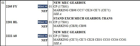

Gets a bit confusing, there are 2 gearbox part numbers (plus an exchange box) listed for this car by the VIN.
Casing numbers shown below.

You will have the MA gearbox. They all will bolt on and fit, but some have different ratios, different gear linkage, and some have different driveshafts?
If you want a second hand box that’s the same as yours, best talk to Dean Hunter www.peugeotparts.co.uk.
Mind you the most reliable route would be to remove the box and take it to a gearbox specialist for repair. They are a very simple box to pull apart, if it’s just a gear and synchro, won’t be very expensive.
