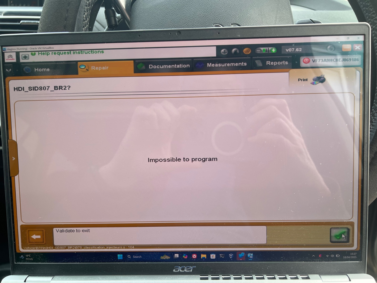

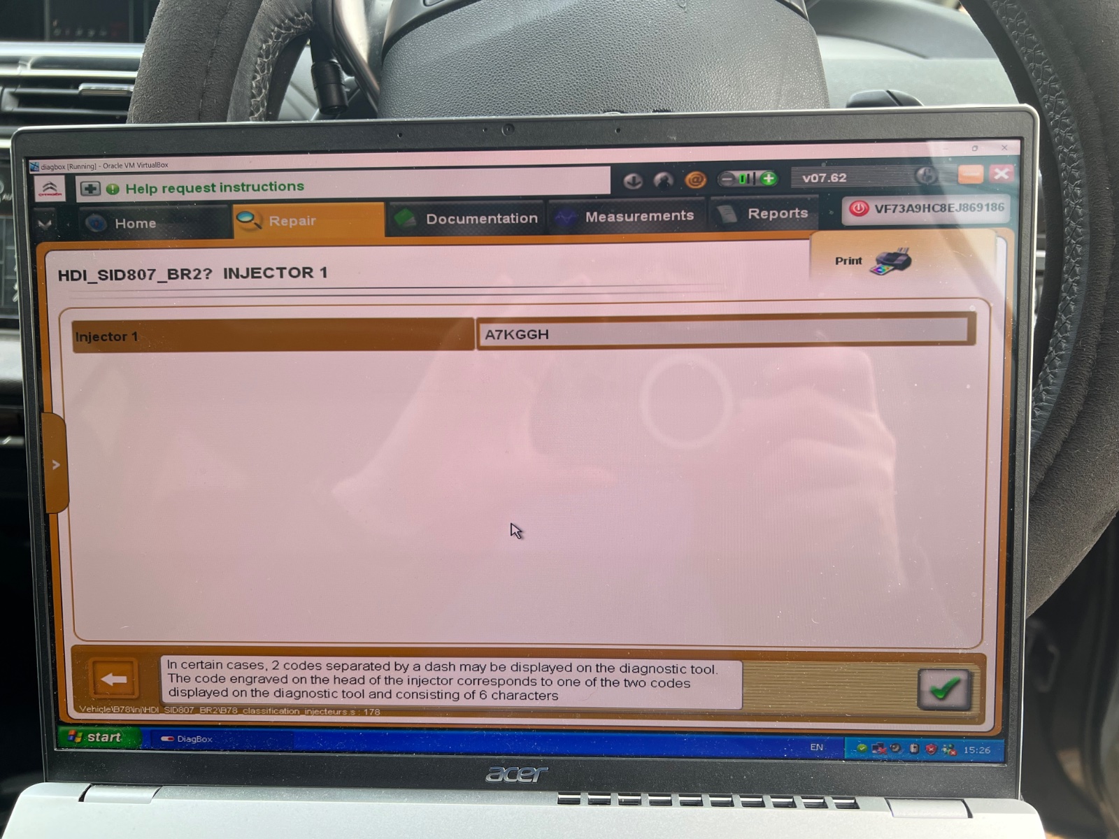

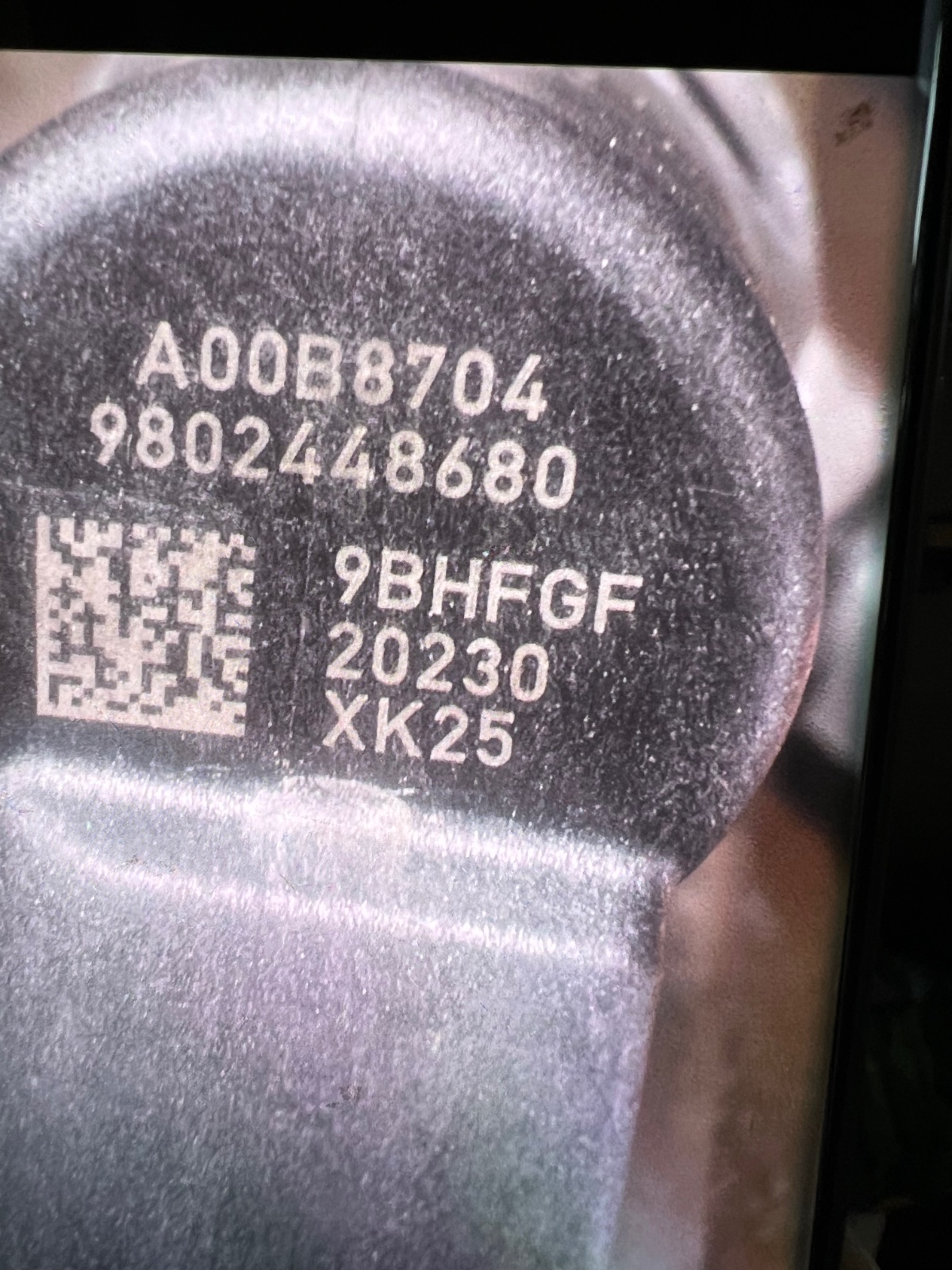

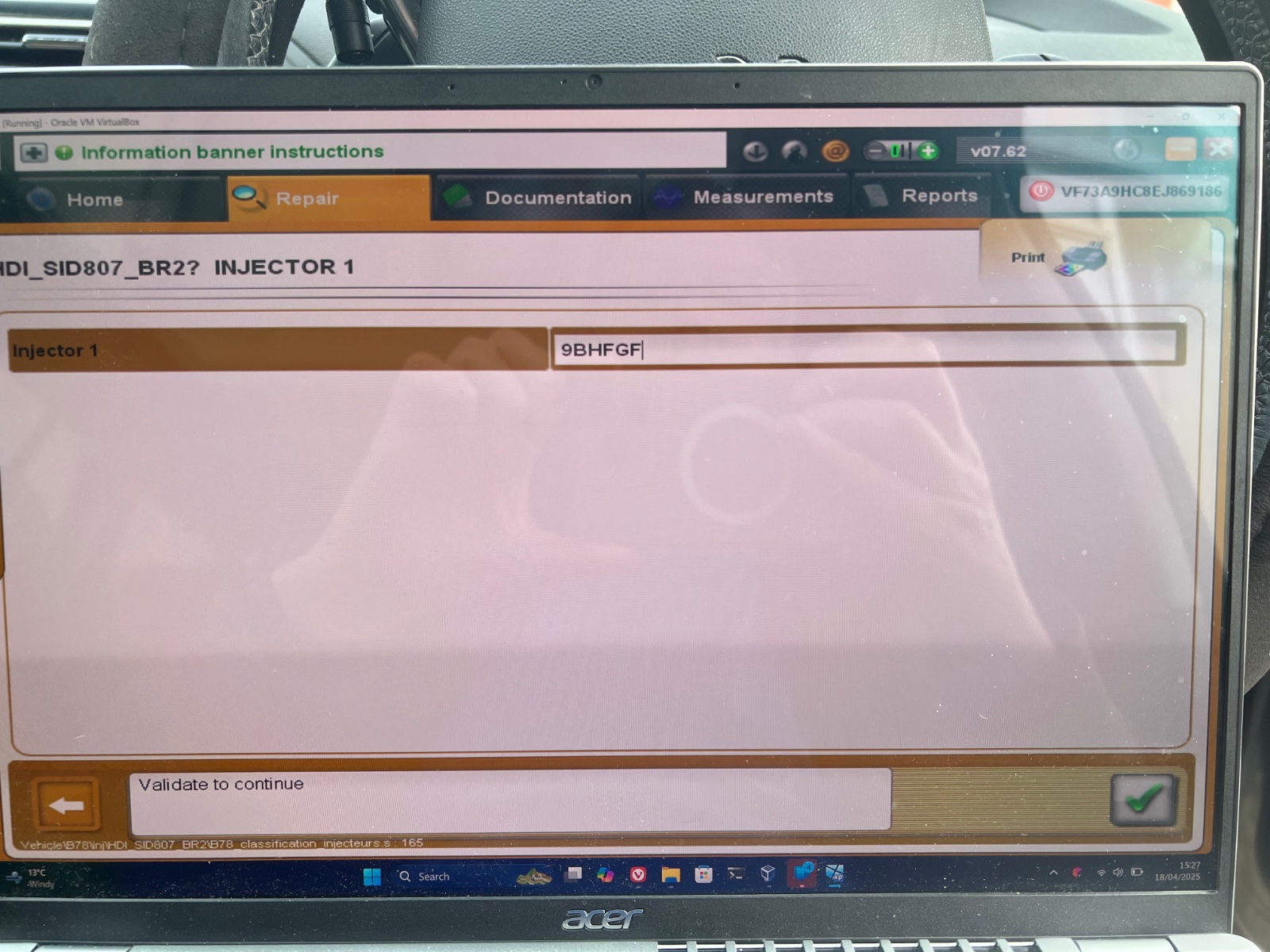

Hi, I had an injector replaced at the garage last week but he said he couldn’t code it and was probably due to the rain internal blowers not turning off. I have replaced the resistor pack on the blower which fixed that problem and as I have diagbox thought I would code it myself. It was injector 1 and that was originally faulty and as I had the old injector to hand I could read the old code to make sure I was changing the right one. However whenever i tried to change it I got an error Impossible to program. Am I doing something wrong and does anyone know how to fix it? Oh I am using diagbox 7.63 and it is a c4 grande Picasso 2016 I think

Yeah I noticed that, mine are definitely 6 digits. And o know I changed the right one as the old code was for the one I took out

The QR Code will usually be the correct number

I tried my QR code reader but it wouldn't recognise the QR code. It just ignored it. Even copy and pasting into an image editor and manipulating it didn't work. Anyone else tried this? The code reader has never failed me before.

In this particular case, if the information in 4th post down is correct, it should tell you what the injector code is.
Most often they are used for internet URLs (which are just a string of letters, numbers and special characters) to enable a fast link to a web site.
