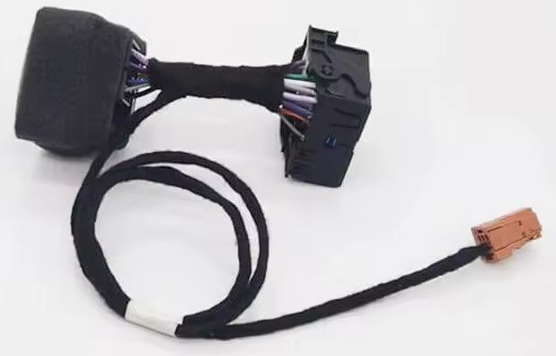

By the way, this is the adapter I'm using. I'm also using two GT5 to FAKRA adapters and one coaxial to 2x FAKRA adapter for the aerials, which seems to be working fine. I'm nicking the pictures in the aliexpress advert for future reference, not out of any disrespect for the seller, but because I'm sure the link won't be online forever.

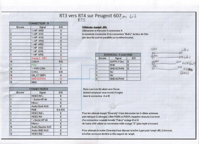

I just found this French thread on more or less the same issue. Apparently some adapter harnesses aren't compatible and I've got to bodge a wire, according to their schematic:
Either my French is too bad, I'm not clever enough or I'm too tired to figure out exactly what I need to do. Clearly though, something needs to be done on pin 11. I can work out which one it is using this schematic from rt4.wikidot.com:
Pin 11 is for the "Position of rectractile screen" which is mentioned in post #49 on the French forum. So that checks out. But what side of the connector do I need? Do I need the wire that was on the loom of the car originally or do I need to take a wire from that pin on the RT5?
According to the schematic, I need to take either of these wires to pin 12 on the blue connector on the climate control unit, which I know how to find. But then according to post #79 in the same thread, I need to connect something to pin 14 on the connector of the RT5(?), which should be Open/close signal for the retractile screen, in order to not get a bang whenever the RT5 is switching on. So...do I need to connect pin 11 of the original loom of the car to pin 14 on the RT5? Help!
