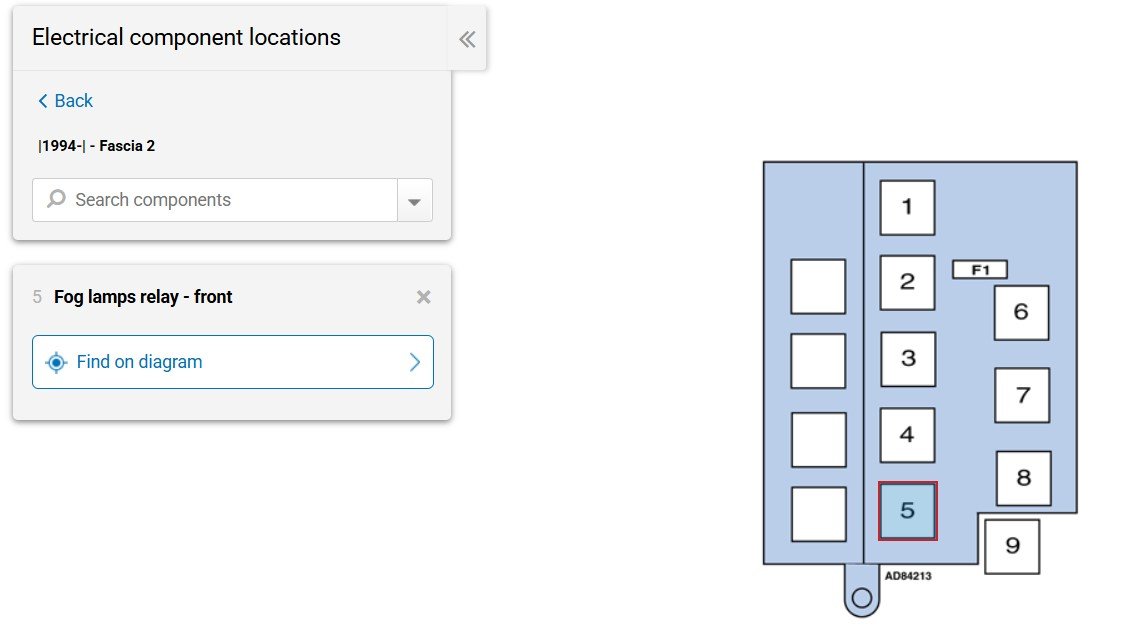

I used to have a 106 Quicksilver that had factory front 'fogs' that weren't even fogs as they only came on with the full beam, no switch on the stalk for front fogs.
According to Autodata this should be the front fogs relay

Thank you for the diagram. Are those relays located behind the glove box?
