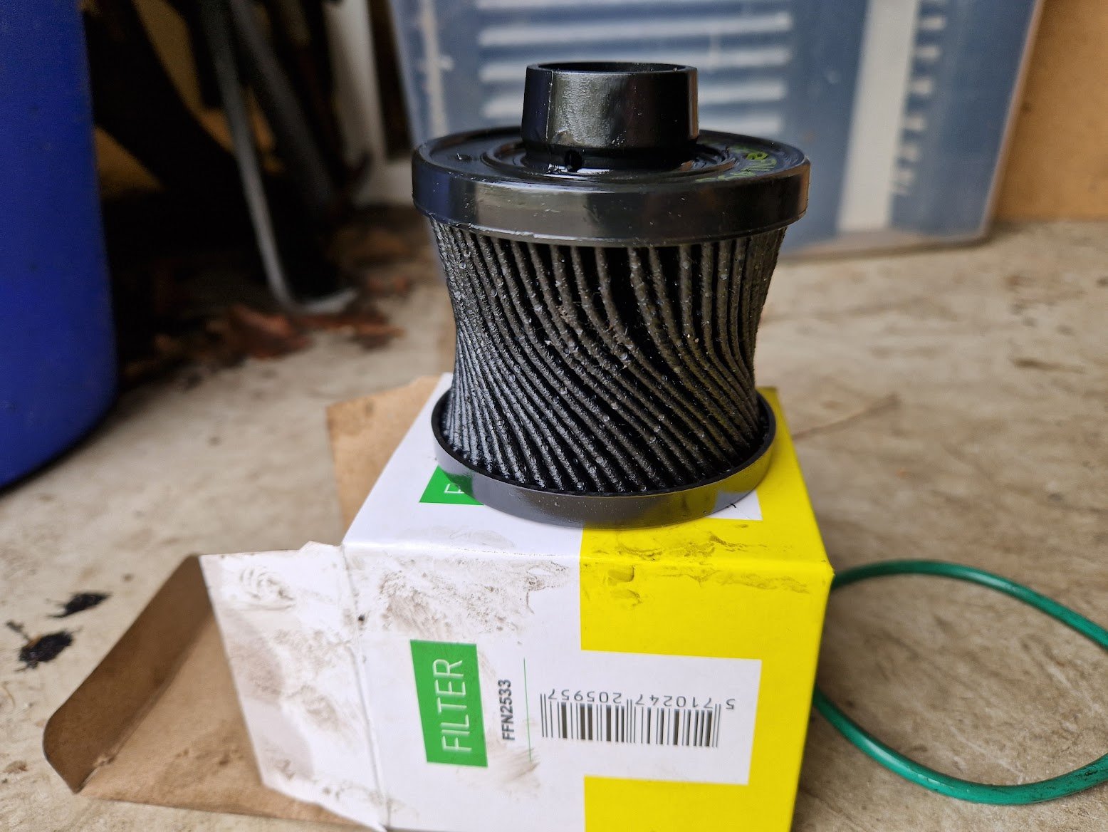

I changed the fuel filter and the fault went away - and the car is noticeably more responsive. Thank you very much for the suggestion, @RichardW
Indeed a cheap and easy fix!
Here's a picture of the old filter. No wonder the fuel pressure wasn't right...

Gosh, that one was well past it! No wonder the car was a bit unhappy... Pleased all is now good :D
